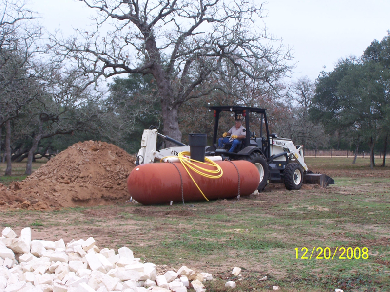

Not that it would ever happen but...a 1000 gal tank would displace about 8350 lbs. of water(the flood). The combined weight of the propane, 3825 lbs., and say 1000 lbs. for the tank will leave you with 3525 lbs. of "lift" which would pop that tank out of the ground in no time.
Same way a 20 ton concrete swimming pool would lift up if emptied if not properly installed.
Exactly. Excess regulations? Maybe not.

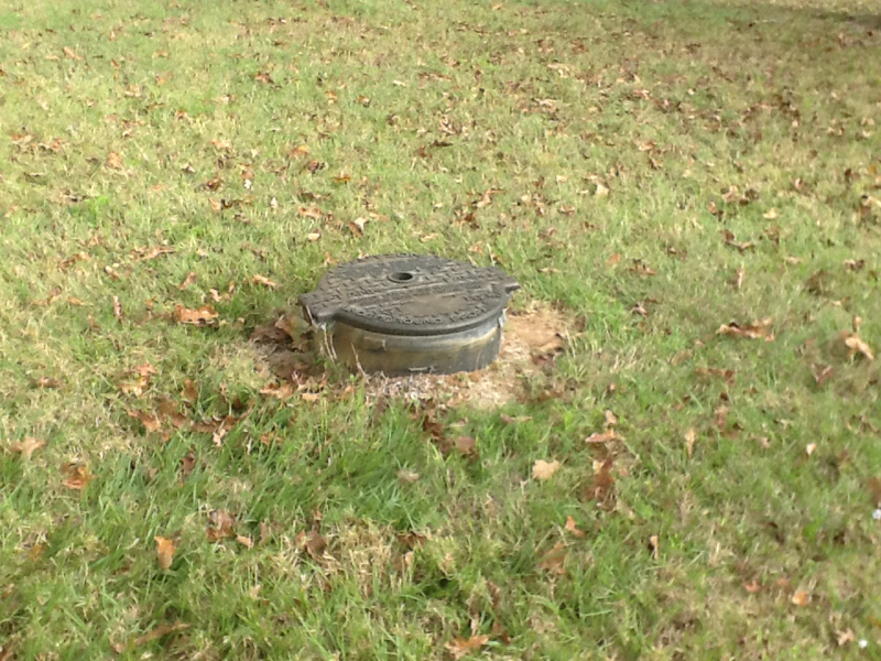

In Newyorkistan I don't think I ever saw a buried tank setup, the northern part that is. Besides here in the sticks there is normally only one company and they rape you mercilessly although I hear lately there is a bit of competition and prices are more fair. They were always pretty good at nailing you while the prices were high as were the oil companies when you were on a fuel contract program. You could always count on fuel exactly when you didn't want or need it right after the contract expired yet before the summer price drop. Then there is the issue of that fugly tank taking up a nice piece of your yard.
If you are the do it yourself type it's all too easy to just scrounge up two to 4 100 lb tall thin tanks and just fill them yourself. You just go buy an auto switching manifold setup and go fill them at the cheapest local gas station that sells propane. It used to undercut the ripoff outfits like Amerigas or Suburban by well over 1/3. It may well be a bit lower of late but still it's no hassle to fill 100 lb tanks yourself. I just incorporated a strap into the mid section of a cheap hand truck and it moves them easily. You can't keep the gas company out of their tank as you have no control at all but you sure can if you do it yourself and you don't need to buy one for $900 and stare at it every time you look out the window. If you can't find old used tanks you can buy them new in Lowes even here in the nanny state of Newyorkistan even though stores cant sell gas products unless they furnish installation.
Well, IDK where you are, but around us here under the big lake, more than 95% of the big tanks are buried for all of the reasons previously given.
