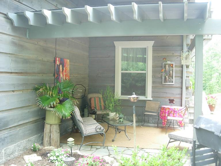

Not on a slab. I've attached a picture. You can see little silver/white things on the left center that are circled. Those are the pigtails that go to the manifold and this is where the two tanks are located.
For anyone who observes and realizes a 100lb tank is a lot taller than a 30lb tank, I've got a cedar log that I set the 30lb tank on so the pigtail heights are the same. This way, if I NEED to connect both 100lb tanks, the pigtails will reach both of them at this height.

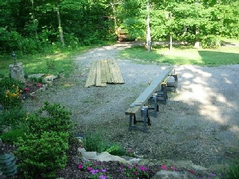

Back to the point...there's the nearest window. The block wall on the left is the top of the garage. What you can't see in the picture is, if it panned left a little bit, the ground would fall away fairly quickly and lead down to the driveway which is to the left of the photo. I can't seem to find a pic showing that.
The garage door is usually closed, especially during winter so if propane did leak and fall down the hill, it would still have more room to dissapate at the driveway than necessarily blow into the garage.
As for POL thread and that stuff...? I'm clueless. The tank itself is a female receiver and the thread is opposite of usual to tighten or loosen. I don't know what that makes it to be.

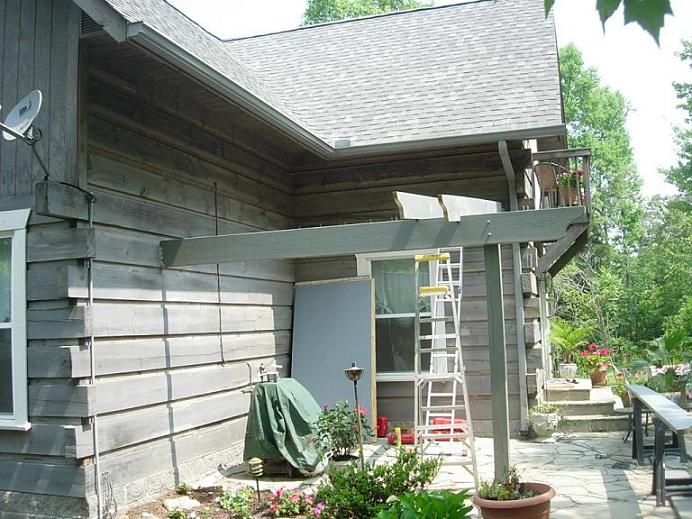

I found some other pics that might let you piece it together.
One is the one I referenced above, the next one was taken further back and you can see the corner of the house. This is right where it starts to fall away. The last picture shows the driveway but you can just barely make out a bush or something on the hill.
It's a fairly steep drop that we have planted flowers and stuff in.
