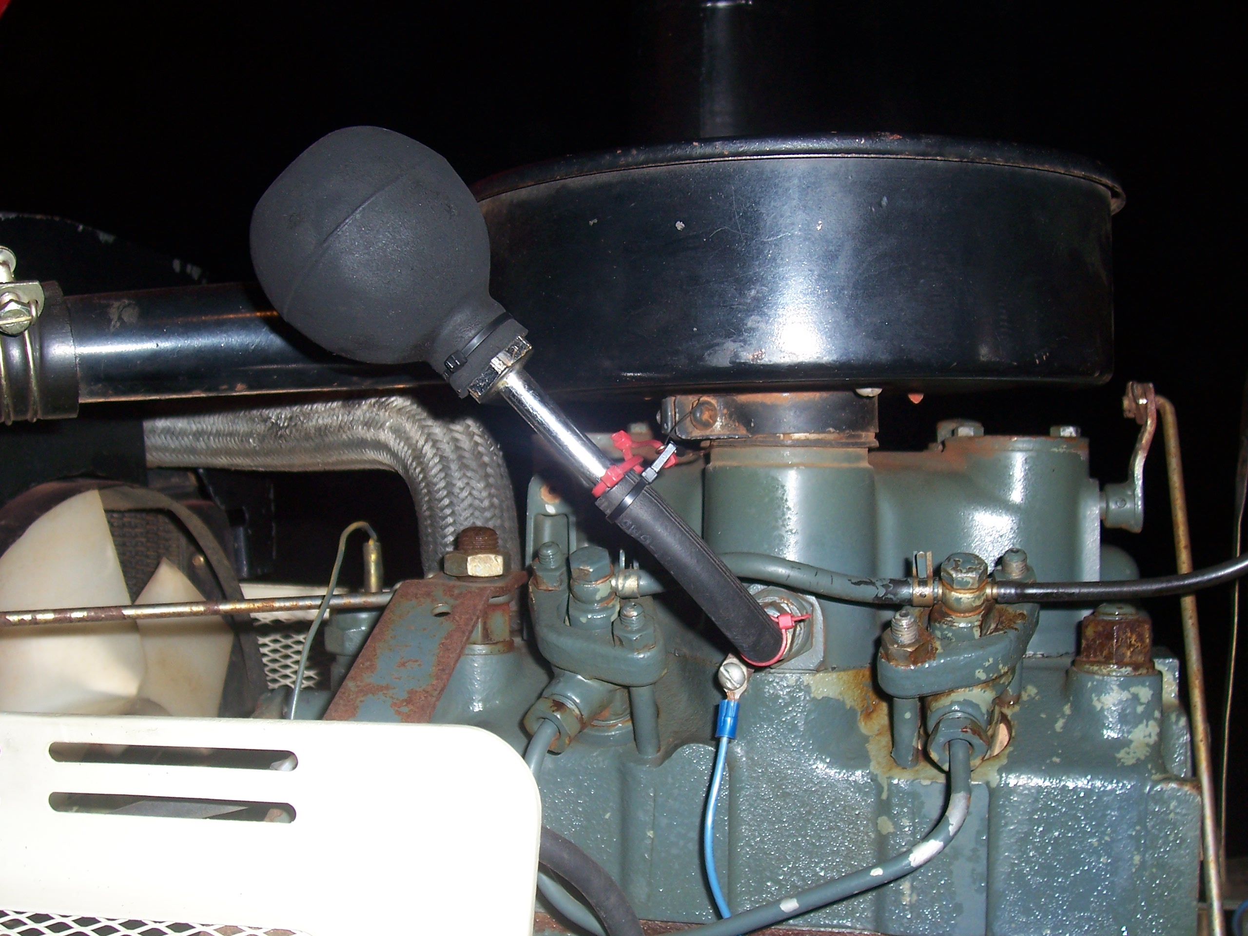

I use my decompression every time I start mine. When the oil light goes out I let go. Not much to the Linkage in the Valve cover. You can adj. the stop if I recall.
I hardly ever have to use the Thermal Start in Ga.. I've had to and I don't have the Fuel bowl either. The Thermal wasn't even Wired up when I bought it. Here's What I do in the Pic. if I need to use it. Works Great. And for me instead of leaving it hooked up. Which I have, I just Squirt the fuel in the bulb back in the Tank.
