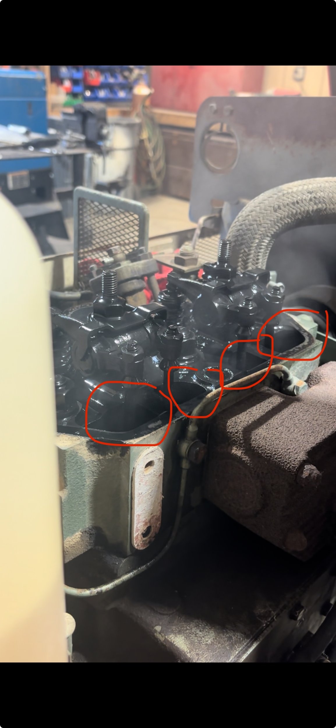

I circled where the smoke was coming out of and I took the pic when I was cranking the engine over so the smoke is visible in pic but a lot more obvious in person.
/ Yanmar ym2000 no start #24
That is engine blowby. I suspect if you have it running your vent tube will be blowing pretty hard. Similar to this.
/ Yanmar ym2000 no start #25

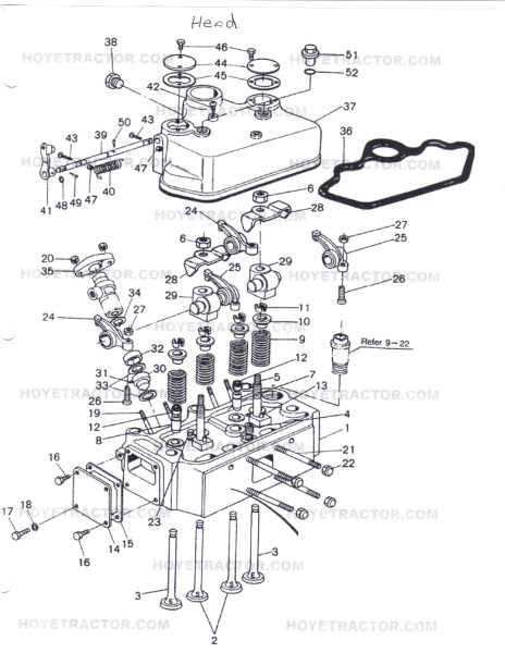

No valve cover gasket. I didn't have a gasket either when I pulled the cover to CHk. The valves Yrs. ago. I ran a small bead of form-A-Gasket round the head and never had a problem. Thought it was odd no gasket but I seen it come up before.

So no valve cover gasket can cause issues? Or were you just saying I don’t have one?
/ Yanmar ym2000 no start #27
Your going to end up with a leak. Doesn't take very much. You can get a Valve cover gasket from Hoye I'm pretty sure. #36 on the Ym2000 Dia.

/ Yanmar ym2000 no start #28
But will stopping blowby at valve cover help engine start? :cautious:
/ Yanmar ym2000 no start #29
Valve cover gasket has nothing to do with blow by or starting, only seals oil from running out. Any blow by is coming from crankcase and that is the smoke you are seeing when valve cover is off.
