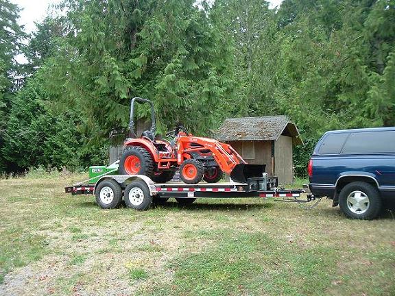

   / Proper way to bind tractor onto trailer? #3
4 chains and 4 binders. 1 for each corner of the machine. I use the drawbar in the rear and the frame of the tractor in front. I believe using straps is not appropriate, and I believe tying off to the loader or an implement is not a replacement for chaining down the actual tractor.
I use the stake pockets on the trailer and the chains have a hook on each end like logging chains. All 3/8" chains and ratchet binders that only get used for tie down duty.
I tow my tractor 43 miles each way to my remote property and have gotten it down real well now. The attached photo shows my tractor which is about like yours and my 18' trailer. The combo weighs 7000 lbs. It took a while to figure out optimal chain routing and tie down plus positioning on the trailer for the best ride.

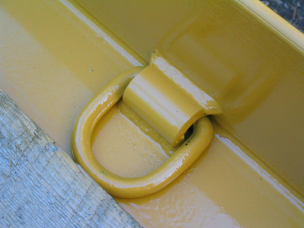

   / Proper way to bind tractor onto trailer? #6
HarleyBob, .... Locate your tractor where it feels right (ample tongue weight etc.) and chain from your tractor's frame (front & rear) with
chains on four corners and binders. D-rings are a great way to secure
your load. Stop after about a half hour and check the tightness of chains
and adjust as needed. ... RayBee /forums/images/graemlins/grin.gif

   / Proper way to bind tractor onto trailer? #7
Here is where the chains terminate. I welded 4 of these after locating
the proper location of the chain from the tractor frame.
Good Luck /forums/images/graemlins/smirk.gif RayBee
