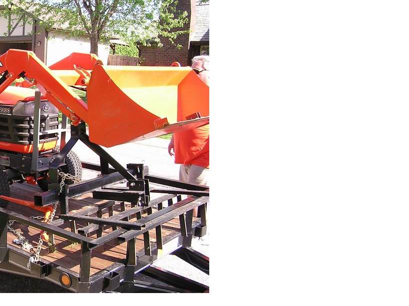

HBob,
Here's a not very good pic of how the front is chained. The tool on the trailer blocks your view, but the chain goes through a clevis attached to the grill guard and crosses, so the tractor can't easily slide left or right.
The rear chain goes through a clevis on the drawbar and crosses (without a binder).
Disclaimer: This setup works for me. I believe it is legal in my state. Many would argue that since I don't have FOUR chains and four binders, I'm not legal. As I've stated previously, if I were going coast to coast, I might do it differently, but this works for me and I believe it to be safe for a variety of reasons.
Ron
