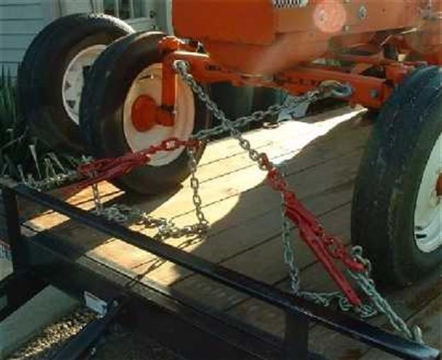

Farmwith junk; you have said it well.
I also cross the chains to help keep the load centered. See picture.

For my small Bota, I use two chains (grade 70 that don't get used for ANYTHING else) and one over center binder. I run the chains through a clevis on the front and rear, crossing the chain, and attaching the binder in the front. Excess chain wraps the binder.
I have a rachet binder, but its too slow IMHO. If I were towing cross country, I'd use it, but not for short hauls.
