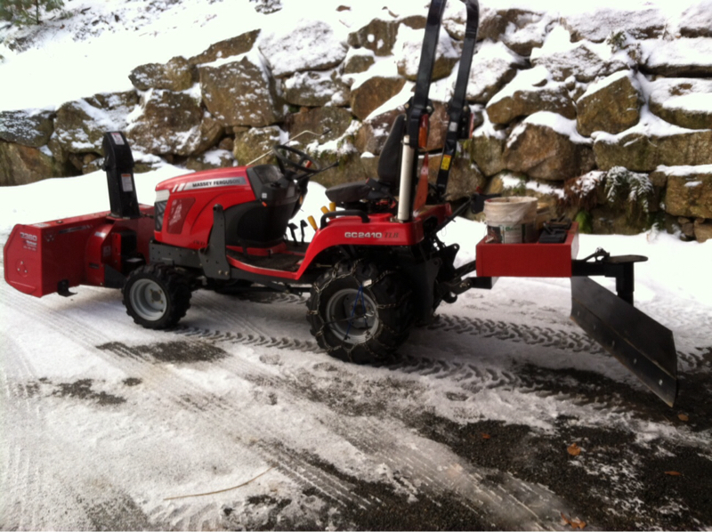

Just bought my neighbor's Kioti DK50 and been plowing my 1.5 mile long driveway with it this year. Considering getting a blower next year and wanted to know the pros/cons of the front mount to the rear mount. I am thinking with a front mount I can leave the box scraper on the back to quickly push piles while blowing with the front. It is not uncommon to get 4' snowfalls here and a couple of times last year I had to make 2 passes with the blade to get down to the road because of so much snow. Anyone have any experience comparing the two? Ideally, I'd like to get a hyrdaulic front blower, but I need to make some money this summer to afford that, so most likely I'd be looking at a pto for the front.
I think your thoughts with the front blower is the best bet. Sure it's more money but most guys have a sore neck after an hour of looking over their shoulders. I blow on pavement and scrape on our gravel roads. On gravel in big storms, I'll keep the blower an inch off the ground to avoid rocks and scrape the little left. Blowing the snow also keeps the driveway and roads from building up on the sides.

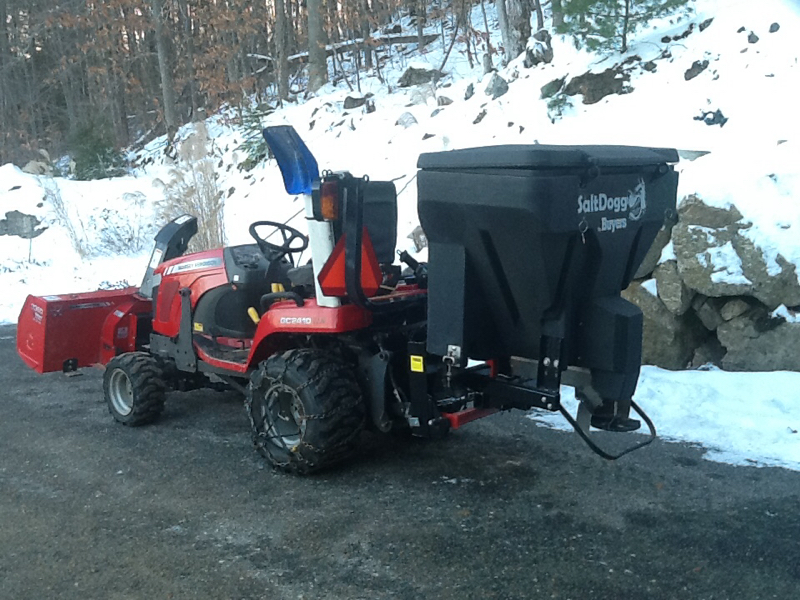

I also added a quick attach so I can take my scraper off and add the sander.

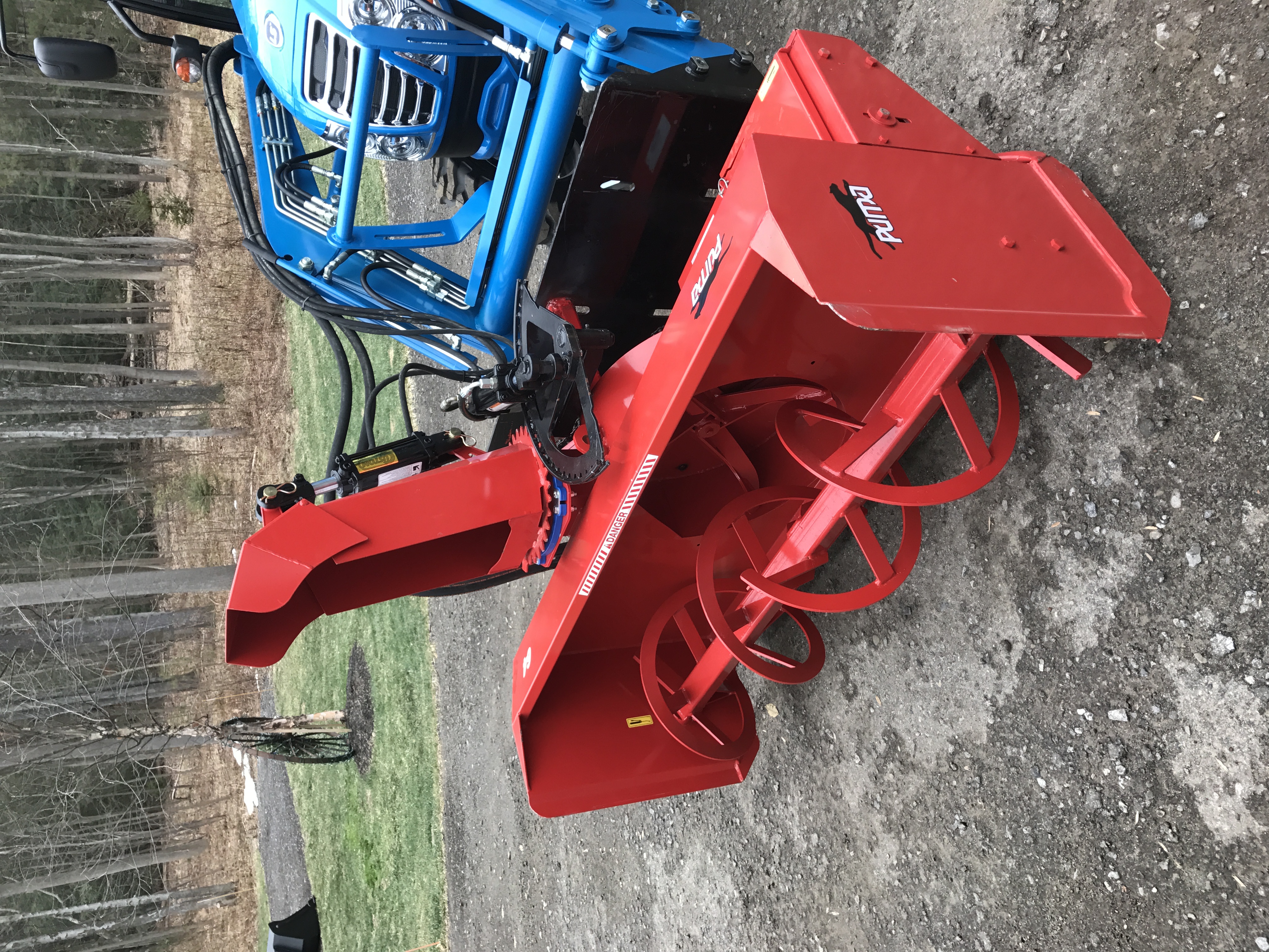

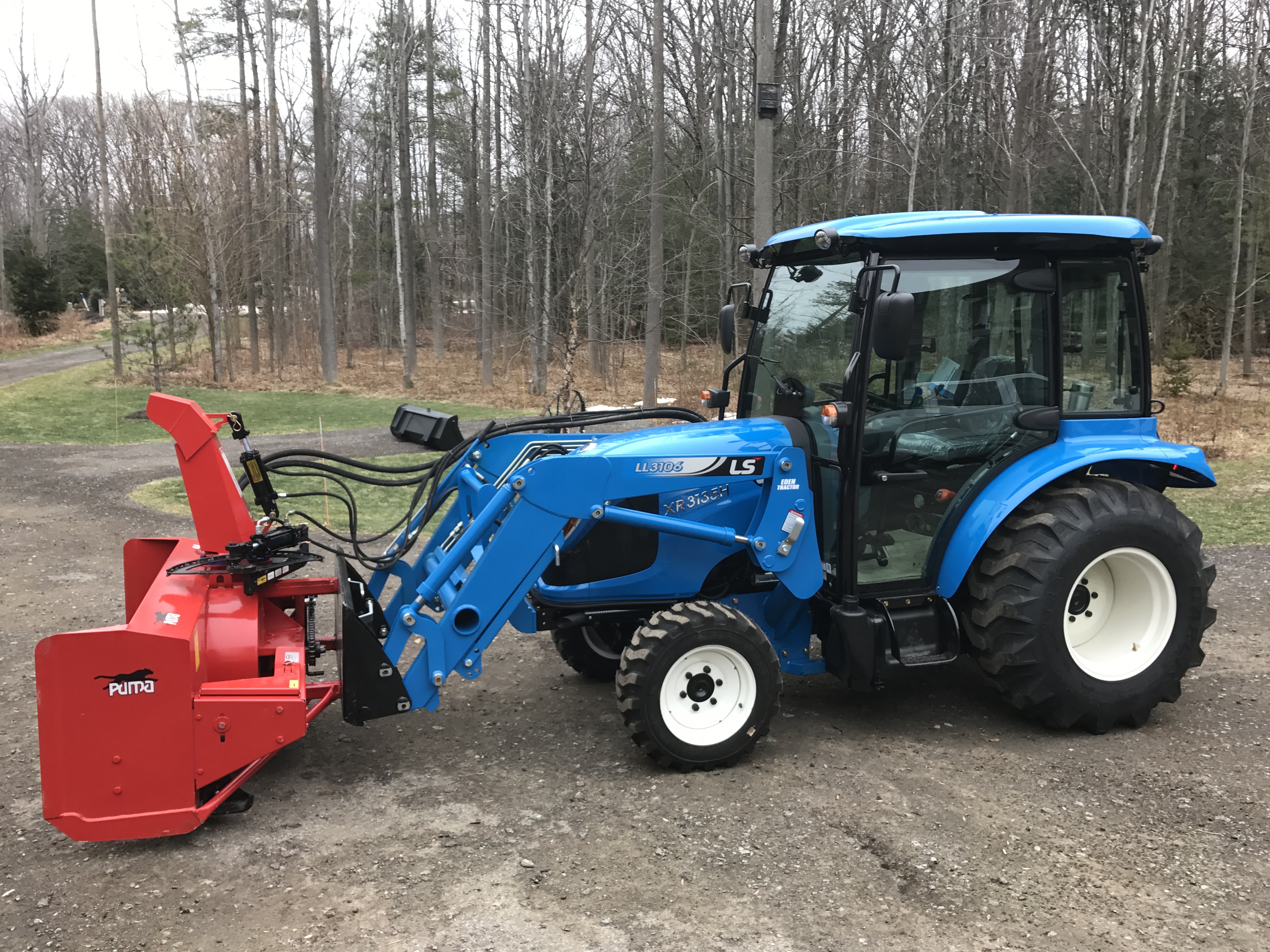

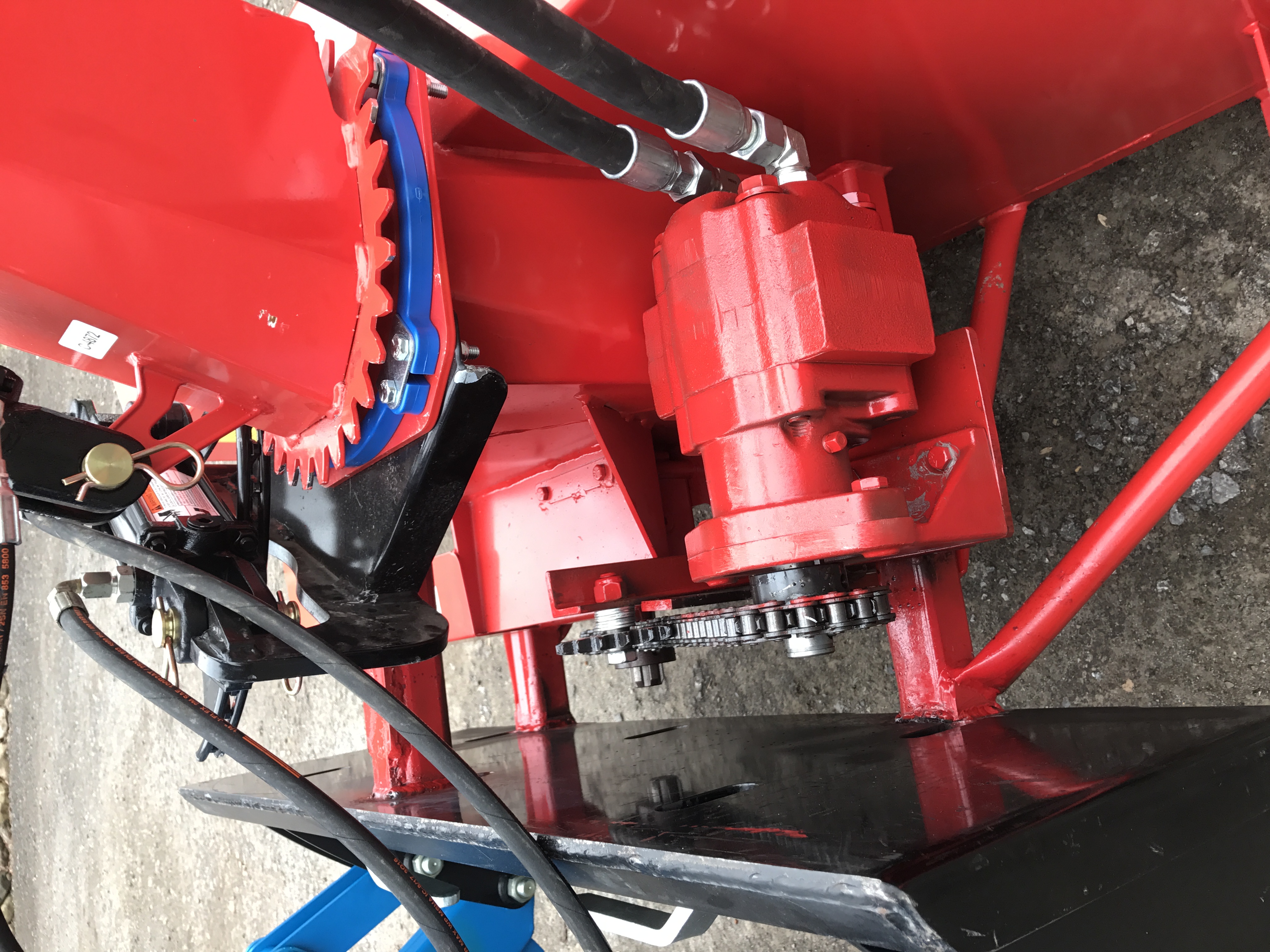

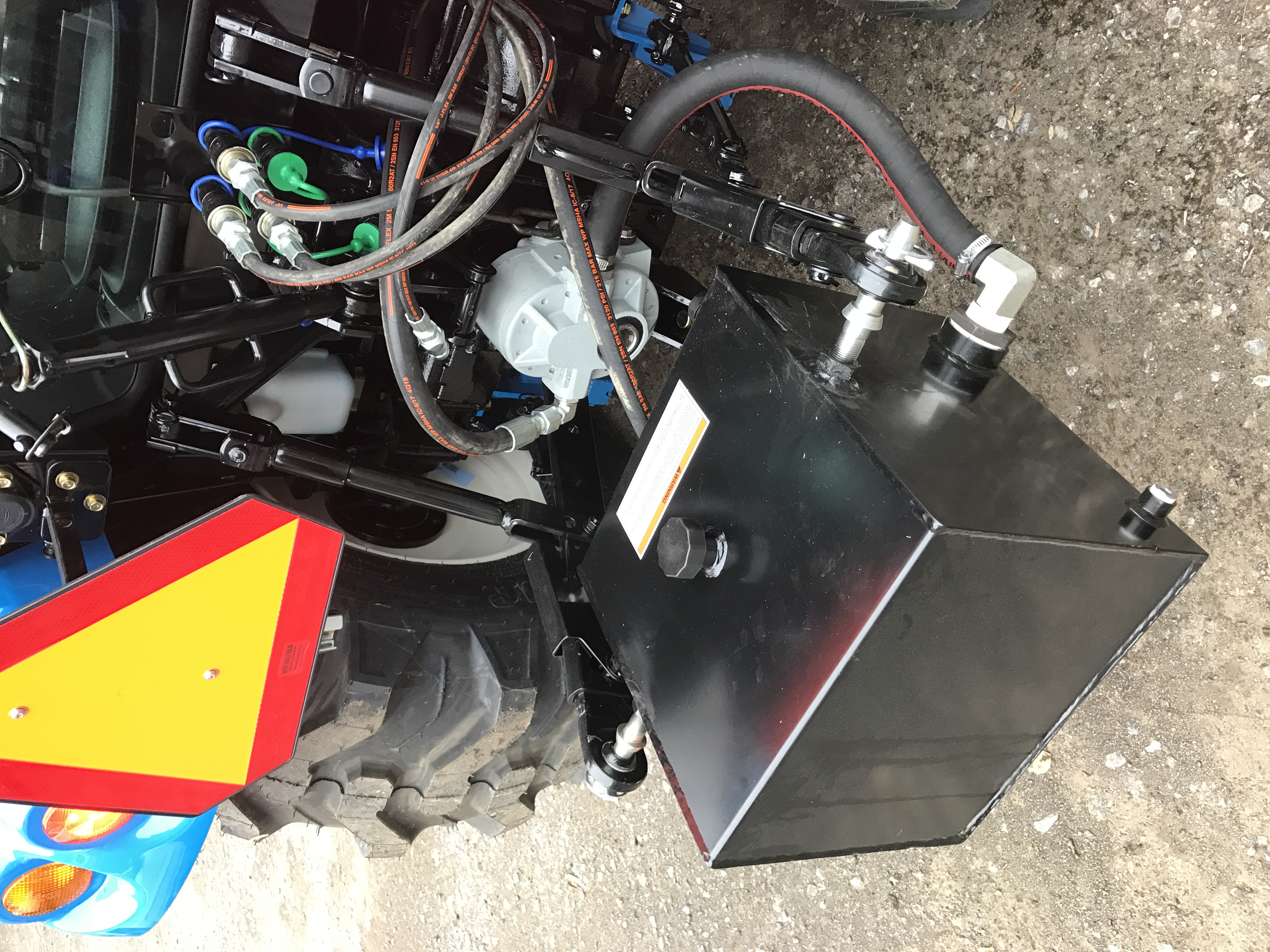

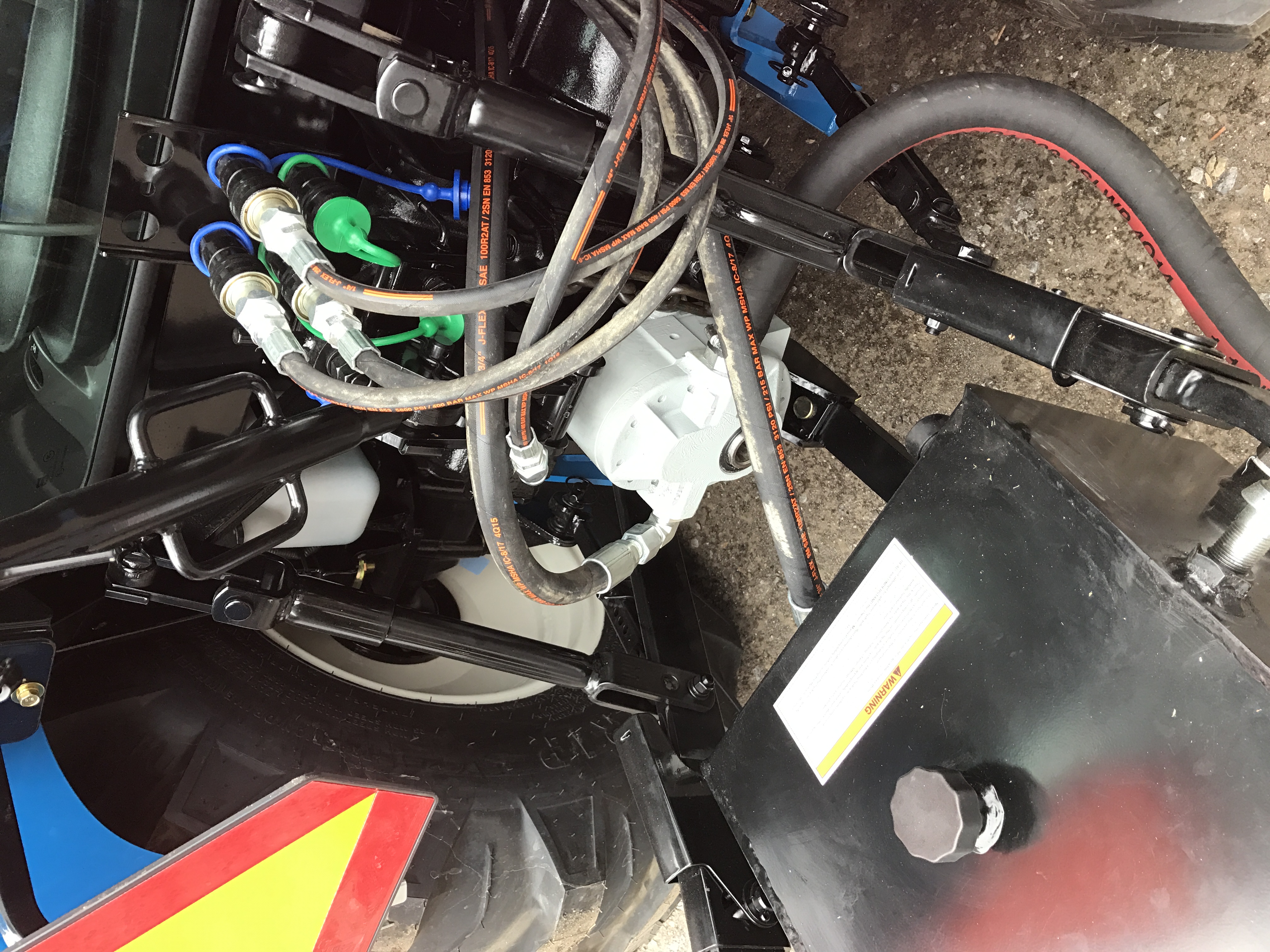

I have not had a rear mount blower but I have had a PTO driven front mount and this I purchased a new tractor and had them build me a loader mounted blower from a Puma rear mount. First the PTO driven one was on a John Deere 2210. It was a pain to put on and take off. Put the mounting bracket on, get the blower on, run the lines and connect the shaft. Reverse to get it off.
The loader mounted one has been great. It was a Pronovost Puma 3pt blower. My dear removed the 3 pt and added a SSQA plate and mounted the hyd motor. Yes you would need a rear PTO driven hyd pump and a small tank on the 3pt.
Since these pics I have added quick disconnects for the hyd motor on the blower and will be adding them to chute lines also. That will allow me to swap to the bucket by simply disconnecting 6 quick disconnects and drop the blower.
Blower was $3000, conversion was $4000.
I highly recommend the Pronovost. The Puma is a mid line blower. The Lynx is the entry level, but still very well built. I think the Lynx would have been about $2500.
