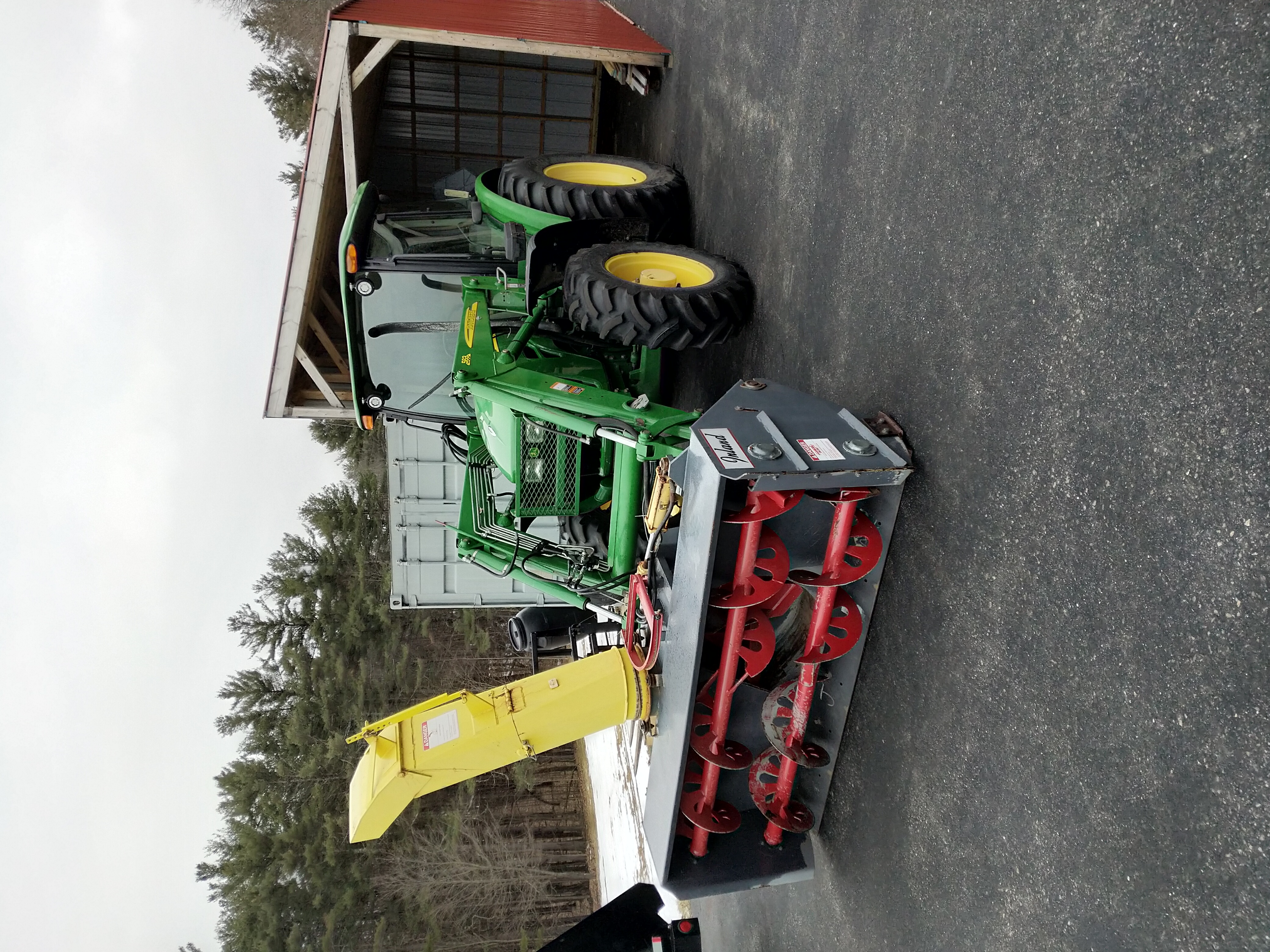

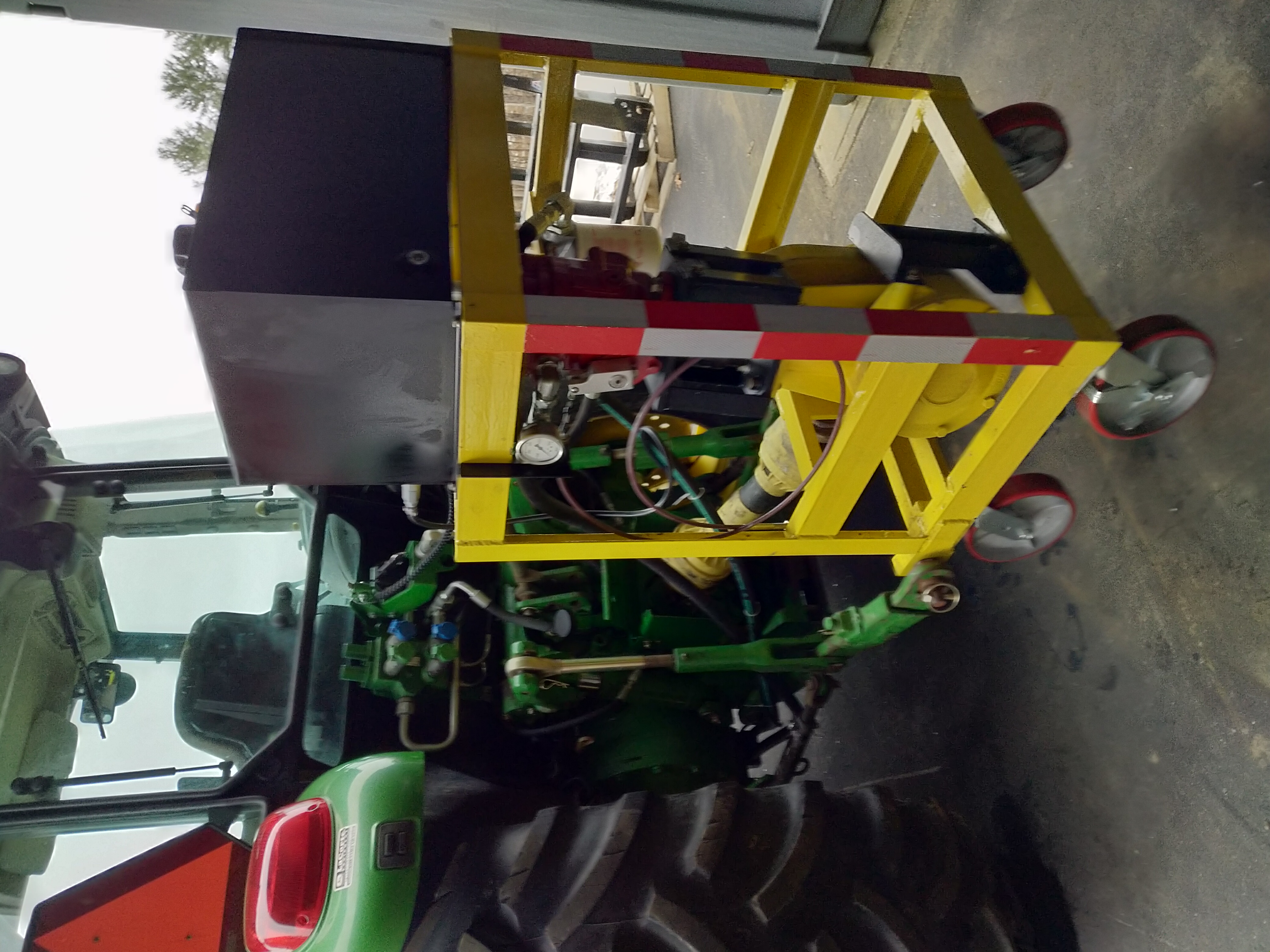

I had this Inland blower on the three point on an 84 JD2350. I later built the power unit and modified it to run on the front. It was great and still is now setup on my JD 5105M. Let's just say I never looked back! There is no comparison having it on the front and it is all set up with quick disconnects so I can put on my bucket or forks if I need to. 6479F26E-86E0-4E9A-A56A-A62F115F9218.jpeg55C30C1D-D2CB-4DD4-A92F-728033232F5E.jpeg

I had this Inland blower on the three point on an 84 JD2350. I later built the power unit and modified it to run on the front. It was great and still is now setup on my JD 5105M. Let's just say I never looked back! There is no comparison having it on the front and it is all set up with quick disconnects so I can put on my bucket or forks if I need to. View attachment 678867View attachment 678868
Very cool!
So, you added a hydraulic motor? Does it drive the installed PTO gearbox? Or, did the motor replace the gearbox?

So, the blower is powered by a CharLynn 6000 series hydraulic motor. The power unit is driven by the 540 rpm PTO. The key is a 1:5.51 speed increaser that I bought from Surplus Center. That allowed for a much smaller hydro-static pump. The combination pushes 30gpm at up to 3,000 psi to the motor on the blower. The hydro-static pump allowed for a much smaller reservoir and of course the pump pressure adjusts based on the load.

I just realized you were asking a different question. The CharLynn motor drives the original PTO gearbox on the blower. The motor is a 112-1064.
