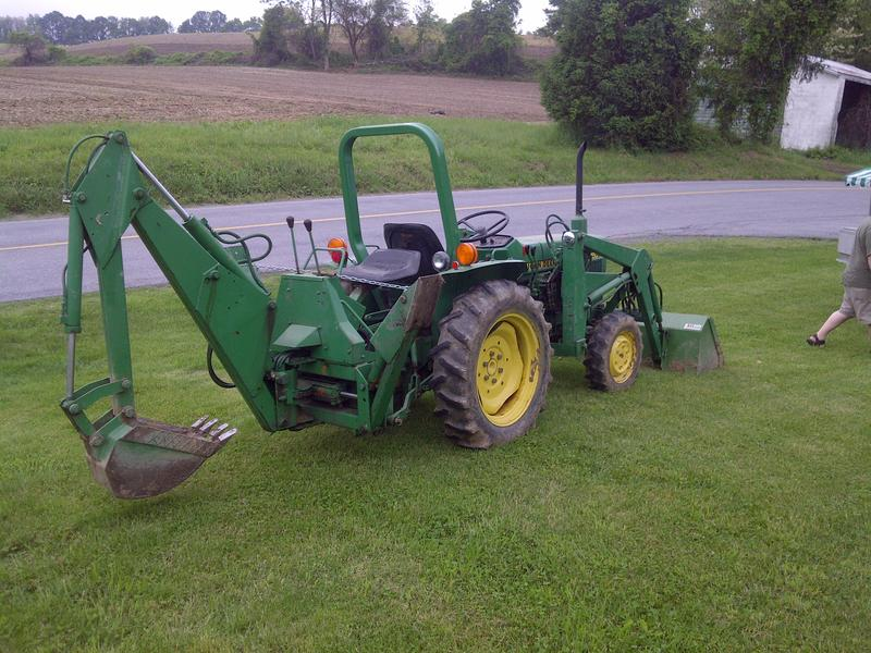

Here is ours, sprayer attached, with a remote for the sprayer motor. It gets used a few times a year for lawn roller duty, spraying the dandelions in Sept and for spraying the driveway throughout the summer. I paid $1500 for it last year and my wife informed me I'm not allowed to sell it. I buy and sell things a lot ;)
No mowing, and I'm about to take the deck off of it. Though I did use it to finish mowing my MILs yard when both the ZTRs were down for about a week before I could get time to work on them.
