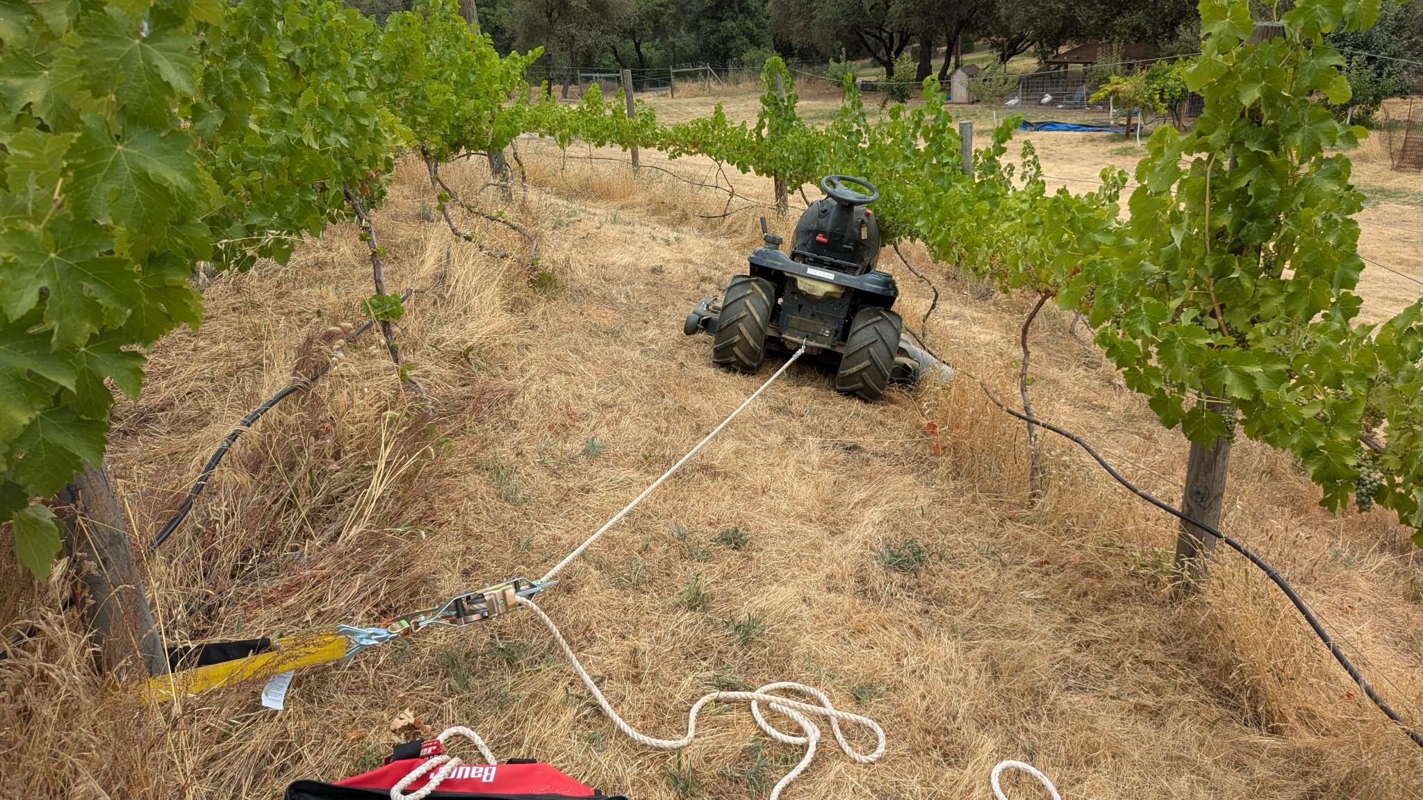

With a riding mower you can get yourself into these situations because
well, only if you're an idiot, which apparently I am
That dry grass is like straw, very slippery as it turns out. About 10' in front of the mower it really gets too steep to go around; I was trying to back up and the front of the mower slid down and the rears (no locking diff on this one) lost traction.
I bought this mower for $800 on CL about 15 years ago; a mechanic was selling it as he took it from a customer to release a lien.. it was almost brand new at the time. It's been used and abused here but any more is mostly a garden cart puller and does small mowing jobs only now that I've got the tractor & rotary, I don't have to cut as much with this guy. And no, there's no seat. I keep thinking $100 for a replacement seat when this thing may die at any time? eh. It's also easier to hang off to the side without a seat, though my butt does hurt after a bit bouncing around
It's been pretty reliable. I did replace flywheel and starter a while back, and a couple years ago took apart the transaxle and cleaned it replaced filters, so overall I've got about $1200 in it for 15 years.
I suppose you could do ^^ the above on a zero-turn too but with the side-slope you'd be even less inclined to do so

This does show the ONE thing I can think of that a lawn tractor may be better at, steep hills. Though in my case my ZTR still handles my hills as good as my JD used to and actually doesn't bog at all going up them like my JD did.

ZTR's seem more stable than a riding mower, as they're generally wider and with a lower COG than a riding mower. They also have have pretty good traction when going up a hill, as all the weight is on the drive tires.
Where ZTR's suck is facing down a hill, as all the weight comes off the drive tires. I've slid that way a few times.
Cross-hill mowing can be a challenge, as well, as they always want to turn down. Your ability to keep facing across the hill can also be limited by traction of the uphill tire.

This is all true. My ZTR is almost as wide as the deck which is 50" so it is very stable on hills, but as you mentioned side hilling it has a tendency to want to slide if its too wet.

If you have a lot of area like that to mow (and have an open checkbook), I would get one of these!:
Absolutely AMAZING on slopes and ditches, and definitely good on high grasses.

I "regularly" mow something we call a lawn - it was laid with sod in 1997, and all that ever happens to it is it get cut (mulching blades) and chickens/ducks/geese poop on it. It's still green and IMO looks good but will win no prizes though I can still play croquet on it. It gets mowed maybe once a week. Other mowing is doing some fix-up in a couple spots we sort of care about where the big tractor just misses because of maneuverability, but those are just mowed so it doesn't look wild... and only once the growing stops and everything's dried. I may mow the little orchard here or there...
so definitely no "open checkbook" for a mower! but as a machine aficionado that looks pretty awesome. maybe after i win the lottery i don't play?
