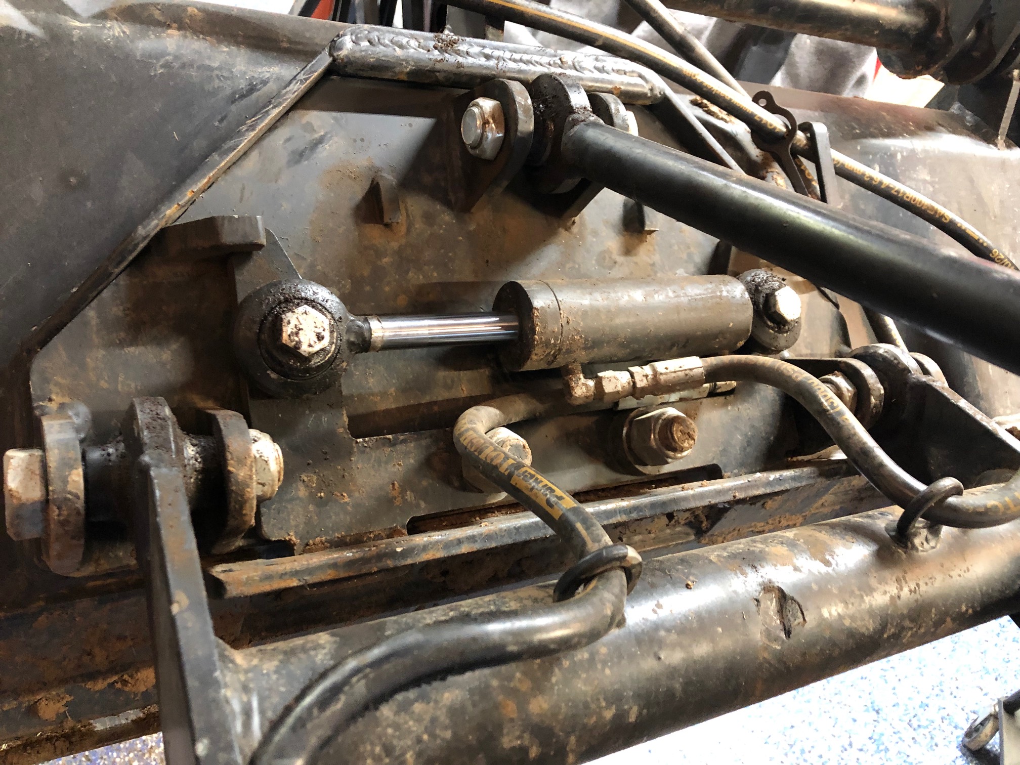

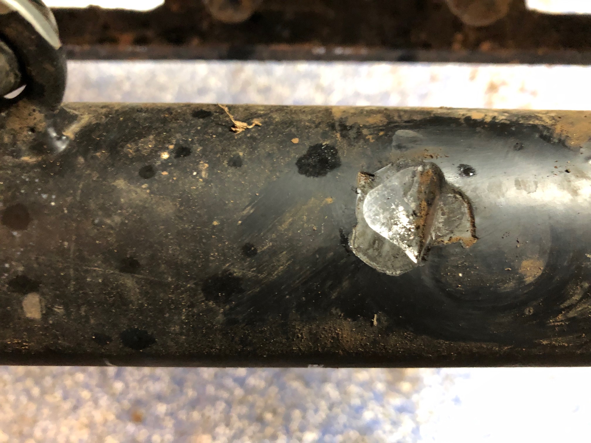

I'm wondering if any other 425 owners experience this not - The front horizontal tube on the lifting arm assembly is developing a fairly deep dent/crease (see pics). It appears to be from making contact with link rod of the Quick attach assembly though I am not aware of it as it's happening.
I'm guessing it's occurring while using the mini-hoe during full extension but not sure. Only about 100 hours on the machine so far.
Either I need to correct something that I'm doing wrong, or I may need to weld on an additional piece of steel to shore up the dent. It's not all the way through the tube but I'm afraid it might be getting close and then I presume it loses structural integrity.
Any thoughts?

I haven't experienced that. I recall years ago people having problems with the roll-over tube cracking, and PT coming up with a beefier solution, but that damage you show isn't on the roll-over tube. I did bend my top-link. But that was from extreme abuse. Next time I see my machine I'll look at it. I have a 2001 model year, so my lift arms may be different.
What year is your machine?
/ PT-425 dented lifting arm #3
I think you nailed the cause... An stroke limiter will help. Send the picture to Keith (to print for terry.).

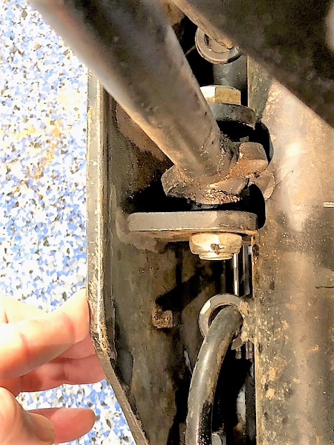

Thanks guys. Moss, I took delivery July 2018 - presume it was made same year.
I see now where contact is being made. The front knuckle of the control arm makes contact when the lifting arm is lowered to floor level. That would be the general position when pushing a bucket into dirt.
I notice that there's about 1/2" of free play in the QA plate (front to back) and that's just enough wiggle to drive the knuckle into the cross tube.
Weird, since it seems like that would be a pretty standard and well used position when using a bucket.
I'll talk to the Power Trac folks.
Thanks again

That is weird. I'm trying to remember the configuration in my head....
So that knuckle you speak of is where the rear of the QA top link attaches to the top arms on the roll-over bar? At that point, the dump/curl cylinder is retracted all the way, correct?
That knuckle clears that cross-brace through most of the raise/lower cycle of the FEL arms, but at the lowest point the knuckle starts hitting that cross-brace?
Sounds like the geometry is off a bit.
Find someone that has a similar year model, and measure the length of the link arms on the top and bottom of the roll-over tube. See if yours are the same length as everyone else's top and bottom. If they are the same, then never mind my thought process. However, if the top and bottom arms are different lengths, and your measurements of top and bottom are different, maybe your roll-over tube got installed upside down? Just a thought. Most likely NOT THE CASE.
Another thing would be to measure the dump/curl cylinder and see if it's the same as everyone else's. Could be wrong cylinder.
Do the same for lift/lower cylinders. Be safe and don't get under the FEL, of course, without blocking it up.
And measure the QA top link rod length, too, while you're at it.
Then you'd have to look at cylinder and FEL mounting tabs to make sure they are located in the correct positions, etc....
Something in the geometry is off.
As someone mentioned, you could put a collar around the dump/curl rod to restrict retraction. That would keep it from hitting, but also lose you some range of motion.
Good luck in your investigation and hopefully PT will have an easy solution.

Yikes! Yes the geometry is off, and it is not the plate, though that sounds like a lot of slop.
Talk to Terry.
If he does not send you a replacement link, I would shorten that tube before that dent gets any deeper. (Might cut it out and weld a patch onto the other tube while I was in there.)
I hear plasma cutters do a great job of cutting tubing...
All the best,
Peter

I added another pic of the arm position when contact is made but Moss, yes, you understood the position exactly! Based on coolconnection's experience, this is not a unique problem so I've sent off some pics to Terry for comment. Funny, these days you tend not to think in terms of hand made equipment and the possibility for human errors in the build process. We'll see if that's the case or not.Contact point 3 - free play.jpg

OK that picture is perfect. I was thinking of the other end of the top link hitting it in full dump. It's the far end hitting in full curl back.
It happens when the dump/curl cylinder is fully extended, correct?

The easy fix would be to weld some stops on either side so it doesn't contact the rod ..... Jim

Talked to Terry this morning - apparently not a "reversed control link" like cool connection experienced (though he did acknowledge that they had a batch like that in the past). Shouldn't be possible to make that dent. I'll tell the dent that and maybe it will go away - problem solved.:) I'll just have to keep playing with different attachments and angles to see if I can see the dirty deed happening real time.
Welding/filling the dent and or a protective plate to the tube is option 1. welding a stop to prevent the contact is option 2.
Peter, you wrote "I would shorten that tube before that dent gets any deeper. (Might cut it out and weld a patch onto the other tube while I was in there.)" Can you clarify what you mean by shorten the tube? And yes, I suppose a plasma cutter would be useful but I'd hoped not to use it to cut up my new machine!!!

What I meant was that I thought that your upper arm was hitting the tube and denting it. I meant to suggest that you take the upper arm off. Sever it, and shorten it by whatever amount is needed, and reweld it. The cut out thought was that a dented tube is significantly weaker than an intact tube and that it might be useful to cut the dent out, or fill it before a sideways impact causes it to crumple. It is the old crush an aluminum can trick. A small dent or two on the aluminum can and it crumples like tissue paper. Sealed, you can break a window with it.

Moss: It happens when the dump/curl cylinder is fully extended, correct? - Yes
