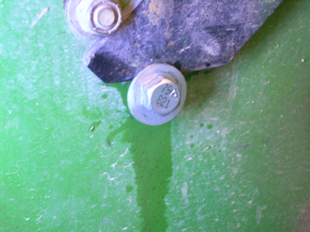

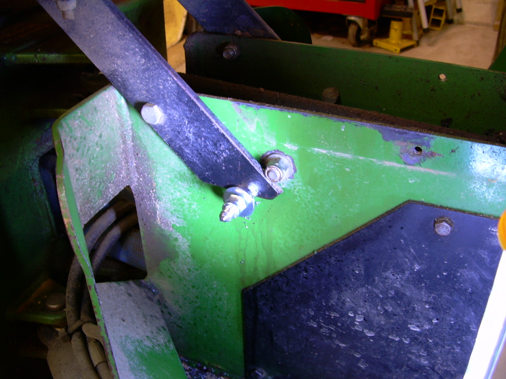

OK it's done. I used one long 7/16 inch bolt. It goes below the seat bracket instead of through it. Thanks to Fourteen for another good modification. See attached pictures.
I tapered the end of the bolt (after threading some nuts on it) using the belt sander. The nuts had no trouble coming off after that. The taper hopefully will allow me to find the far hole during bolt insertion without removing the PT tunnel cover.

Those pics have me wondering if it would be possible to cut/grind the top hole (the one it pivots on) into a slotted hole in the seat bracket, elongating it down toward the end of the bracket. The slot would parallel the edge of the bracket. Then you could lift up and back on the seat, pulling it up the slot, then pivot it forward. When the seat is down, the pivot bolt is at the top of the slot and the angled end of the seat bracket is wedged between those two bolts you have there...
Not sure that this communicates what I'm picturing very well, but this would allow you to lock the seat to where it wouldn't fly forward, yet allow you to lift it and pivot it forward when you need to access the hydraulic tank, center pivot, etc.

I can't quite visualize that, but I kinda see it. Sounds like it might work sometimes, and not others. You could slot the bottom forward end of the seat bracket so the slot goes into the existing stop bolts or maybe new bolts. I guess I need to order the milling machine that I have been thinking about. This might be difficult with my existing tools.

Does this help? I think it would work, but you'd need to use a large flat washer on each mounting bolt to spread the stress. You may have to round off that pointed nose on the bracket to get it to clear the bolt on the bottom, left.
