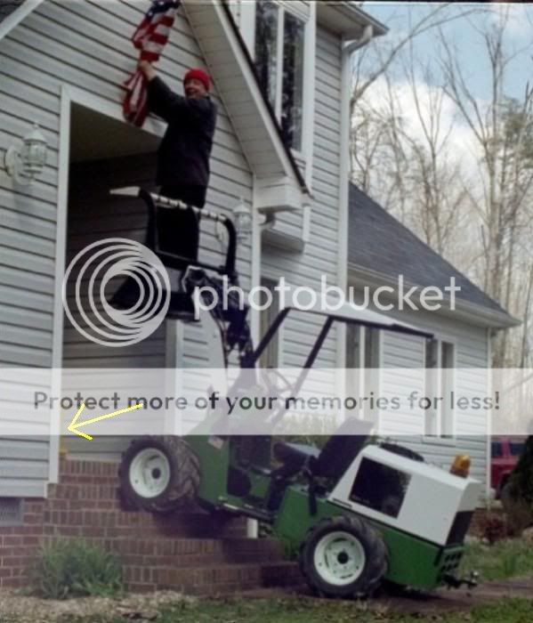

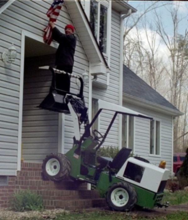

PRO: Power Trac Stability (PT Pucker)
Problem: Some newer TBN visitors may not know what "PT Pucker" is, or may be in dreadful fear of ever encountering the beast, or may be reluctant to get a PT for fear of it. I recently was visited by it while leveling the site for my new 30' x 38' Morton Building. I found it to be highly over rated and with some knowledge and practice can be tamed!!
DON'T TRY THIS AT HOME!! I loaded an ~750# sand filled roller into my LM Bucket to provide nearly 1000# on each front bar tire to nicely compact the newly placed clay fill.
Around and round, and up and down, I went with the bucket raised to clear the lawn as I came down the slopes. Then, while going down the slope I saw that I had missed a spot, so I instinctively pushed the Reverse Pedal and turned the Wheel to go back up and get it! That is when the PT Pucker struck!! Down went the Bucket, and up went the PT and I!!
After the initial surprise, and since I was WEARING MY SEAT BELT, I soon discovered that no harm had been done!! After gently climbing off, I found that the PT was solidly planted, and could not be rocked toward roll over even with the rear fully raised and the Wheel turned fully to one side!!
It is reassuring to know that even in seemingly disasterous situations the PT-425 keeps it's composure!!!!
PS: I usually drive with my left hand on the Suicide Knob, and with my right hand on the Joystick - ready to drop the load if needed to avoid the pucker.
It's all about learning the limits of your equipment, and not exceeding those limits! Sort of like driving on snow covered roads!!

Yup, that's the Han's pucker factor /forums/images/graemlins/blush.gif. Everyone who owns a PT knows about this. Your correct, easy to get out of (straighten the wheel) and your on your way. /forums/images/graemlins/grin.gif

This also seems to be a good way to service the wheels as well as clean underneath and touch up any rust spots. /forums/images/graemlins/grin.gif
Cool pics.

Yep! That be the PT Pucker. /forums/images/graemlins/wink.gif

On your pictures with the roller in the bucket it looks like you have reversed the rims to give a wider stance, and it looks like you have more clearance between the tires and the frame of the pt than on my older 422pt. Your pt being a new model is that the way it came or am I just not seeing it right?

"" you have reversed the rims to give a wider stance ""
Yes! It makes a world of difference!!

"" it looks like you have more clearance between the tires and the frame of the pt than on my older 422pt ""
OEM is the same - very little!
The extra clearance makes it easy to clean the mud and crud out from around the wheel motors for better cooling.
Great stability, as you can see!! It will now go places, and do things, comfortably, that I previously would have considered reckless, even on one of my ATV's!!
