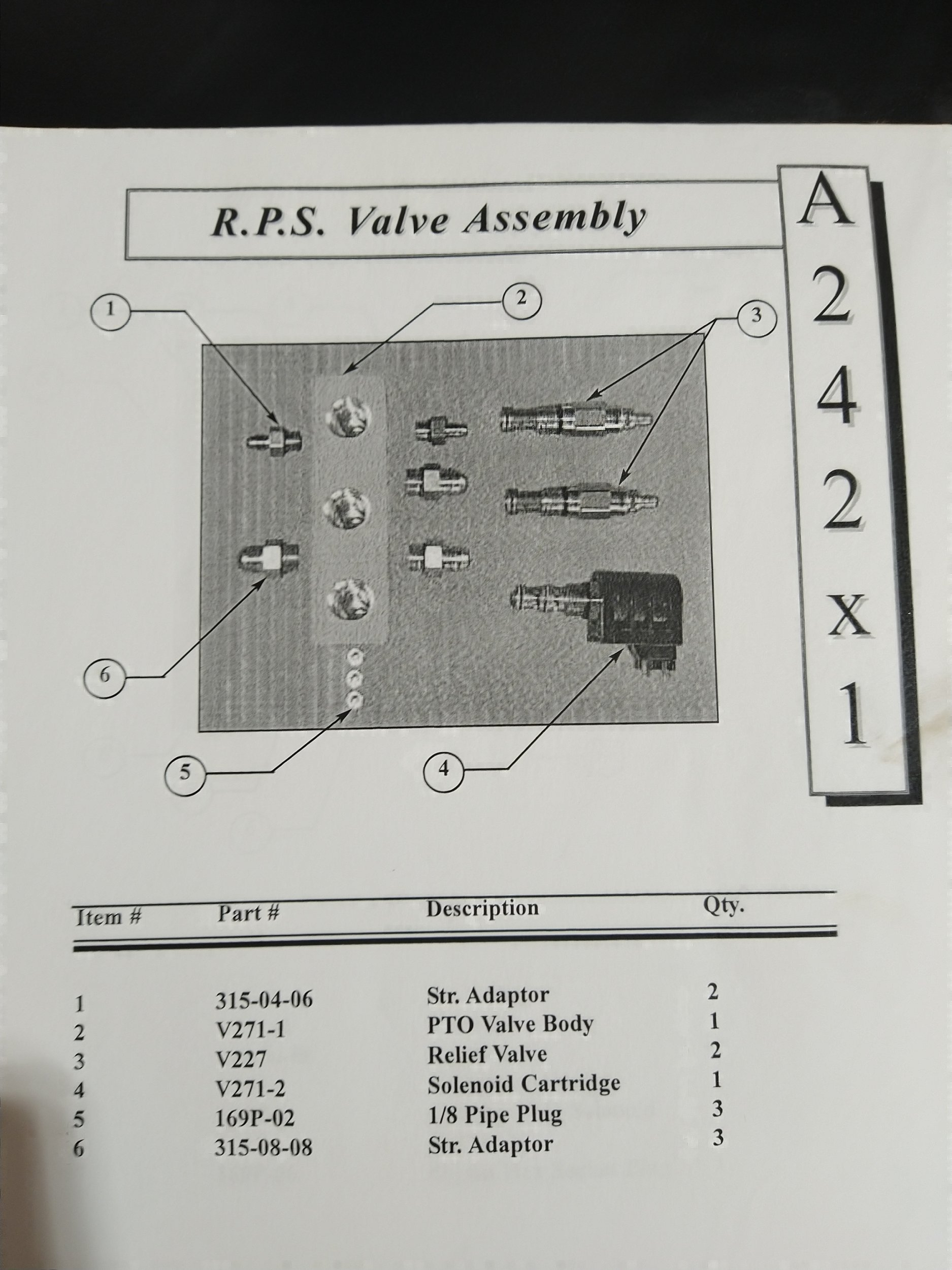

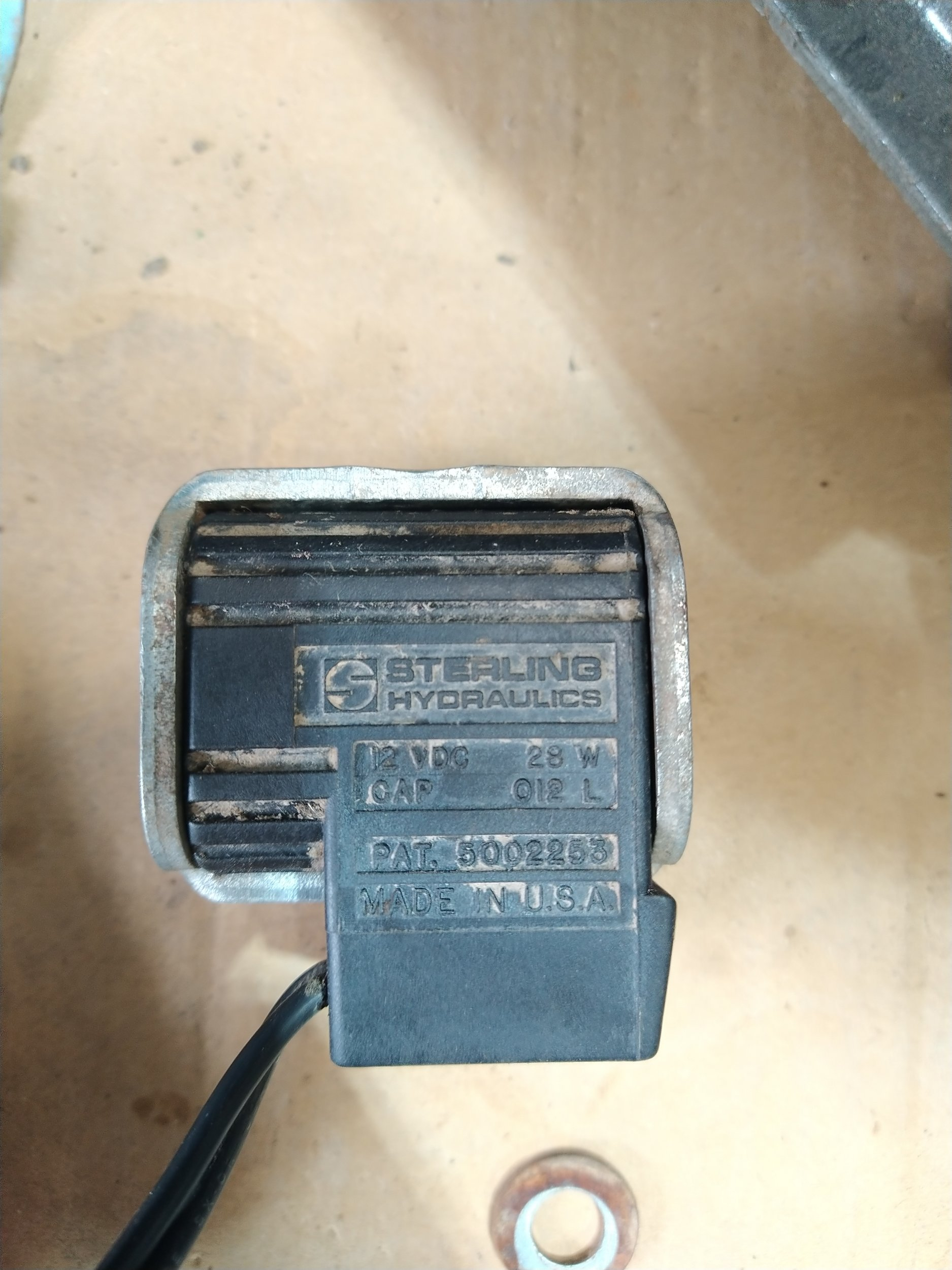

Well my battery has 11-12v and when I have key on and flip the PTO switch I don't hear anything on the solenoid. Cleaned it up a bit as it was covered in a little grease/dirt. I tested resistance on the solenoid and Im getting about 5 Ohms (although it starts out really high then settles at 5 fairly quickly). Not sure if that's the range it's supposed to be in (anyone know what that should be?). Left key on with the PTO switch on and felt to see if solenoid got hot and it wasn't. I am having a hard time seeing if power is getting to it as not sure where to test that at exactly. Was thinking maybe a ground and the connector to the solenoid. Also had it running (no hoses hooked up) and flipped pto on/off quick to see if engine bogged down and nothing changed.
Didn't have a chance to call Terry today before they closed but hopefully tomorrow I'll get a hold of him. Figured out I have a Sterling Hydraulics solenoid cartridge that was used in an earlier version of the 425.

Sorry to hear that you are having troubles. FWIW, 11-12V is a functionally dead battery, having 10-20% of its capacity left. It should be 12.6V (Measured between the two battery terminals with the PT off, right?) Nice plots here, the first chart is the most relevant.
So, can you charge your battery for a day or so? If not, can you jump it? If the answer to both is no, buy a new battery, or get a battery charger, preferably one that can do a desulfator process.
I would worry about trying to do more troubleshooting without having enough voltage to ake things work.
Once your battery is charged, you can troubleshoot the rest about whether the battery is old and dead, your alternator is having trouble, your solenoid is in trouble, or you have some bad cables, or grounds. Personally, I am a big fan of cleaning all grounds and battery connections, spraying the terminals/cable ends with battery protection film, putting on copper dielectric grease on the other ends. Having reliable grounds helps electrical items run better, and makes trouble shooting easier. I ran an extra ground from the dash to the engine block, where the negative battery cable ends, and one from that same point to the tub. (Did I mention I hate running down intermittent electrical gremlins?)

@Husker34 In the minor FWIW category, Ohm's law is V=IR, or I=V/R, so 12V/5ohms= 2.4 amps, about what many solenoids draw, so you are in the ballpark on the solenoid resistance.
All the best,
Peter
