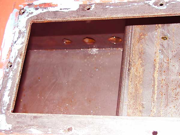

My new filtered vent cap. I machined off the old cap and drilled and tapped mounting holes for the new one. The new one has no dip stick but there is a screen which hangs down just the length of the old dip stick such that if I see oil covering the bottom of the screen the tank is up to level.
While I had the cover off I spent a fair bit of time wiping down every surface I could reach. In addition to the larger bits like welding slag the whole interior was covered with a thin film of very fine particles. Dust from all my road work last year maybe? There's a scary thought.

PT changed the vent cap on all new production tractors. I forgot to ask if the new vent cap would fit the older tractors. I also did not ask why the change was made. At the time, my thoughts were elsewhere. Anyway, FYI.
