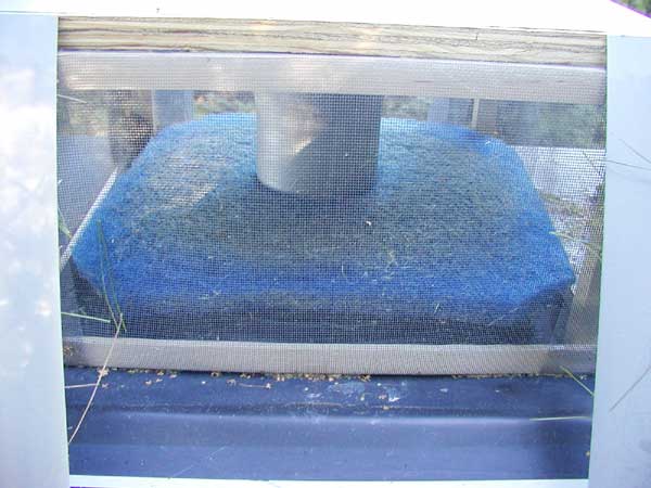

Here's a picture of the filter after the 1-1/2 hours of brush hogging. There is no accumulation of chaff on the screen (no intermediate cleanings were needed) but there is a fair bit of light stuff inside on the furnace filter. Whether that light stuff would pass through the cooler or become lodged I don't know.

Pretty close...here's the way I saw it... take off the top plywood and replace it with screening, 2) take off the "venturi" 3)take off the furnace filter over the fan and apply it to the 5 surfaces of your "box"(increased surface area=increased flow rate) and replace duct tape with "strip" magnets under box to hold it to the hood(in it's finishing stage,not for testing's sake)...
