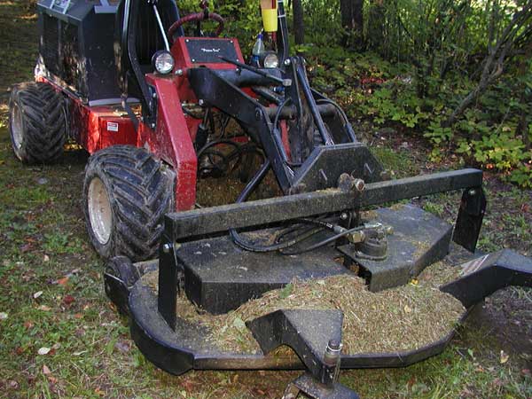

Guess it's about time I added something here since I seem to have started this discussion about chaff filtering. /forums/images/graemlins/tongue.gif
My mowing is probably a bit different from most, especially this year since I just started the mowing season last week /forums/images/graemlins/tongue.gif
Let's start with a picture from yesterday after 1-1/2 hours into brush hogging an unmowed field. And not a terrifically heavy chaff day at that - the growth didn't include much dry grass es- mostly mature goldenrod etc.
<font color="red"> I get some chaff on the screen material in a circle that exactly corresponds to the intake for engine radiator air cooling but it simply brushes off. I have not had build up on the hydraulic oil cooler since the changes.</font> I say a light chaff day yesterday because I only had to brush off the rear screen half a dozen times in the 1-1/2 hours - instead of the usual double that.
<font color="red">One thought about running the fan reversed--if you do get chaff it will be much more difficult to clean.</font>
I'm not sure it makes much difference - once I determined my cooler was full of last years chaff, way deep inside where you can't see it, it took nearly an hour with the hose to wash it clean. That's from last years stock non-reversed fan setup.
Sedgewood

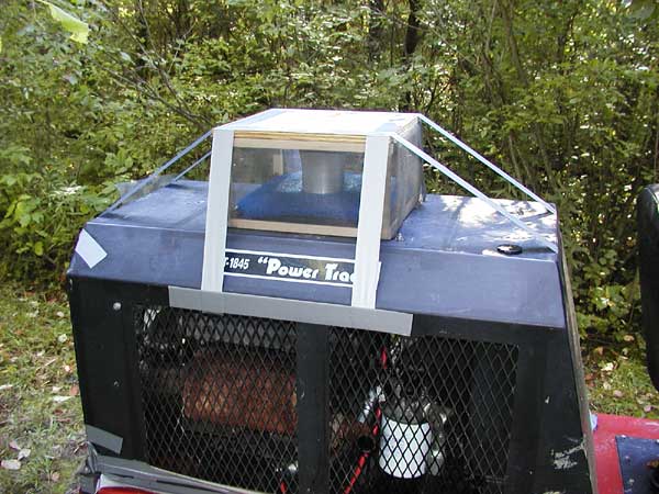

   / PT Rises from the Ashes
#60
bmkar: <font color="green"> Good point...Ahh...Now, with a short wood/metal framework over the top of fan with house screening attached and held on with strip magnets (fridge door style) we'd keep positive pressure in the engine bay(keeping it cleaner) </font>
Kind of like this? What you see is a screened "house" (with a solid roof - screens on sides only) taped on the hood. Inside is a piece of furnace filter material lying atop the fan. In the center is a trumpet bell shaped piece of aluminum I thought might redirect the flow.
<font color="green"> ...Not sure if the "clean" factor would be worth the effort , but, a cooler operating environment for the motor would be a worthy goal(??) </font>
Blowing 150 degree air over the engine doesn't seem to help the cooling much. It's running hot as ever.
Sedgewood
