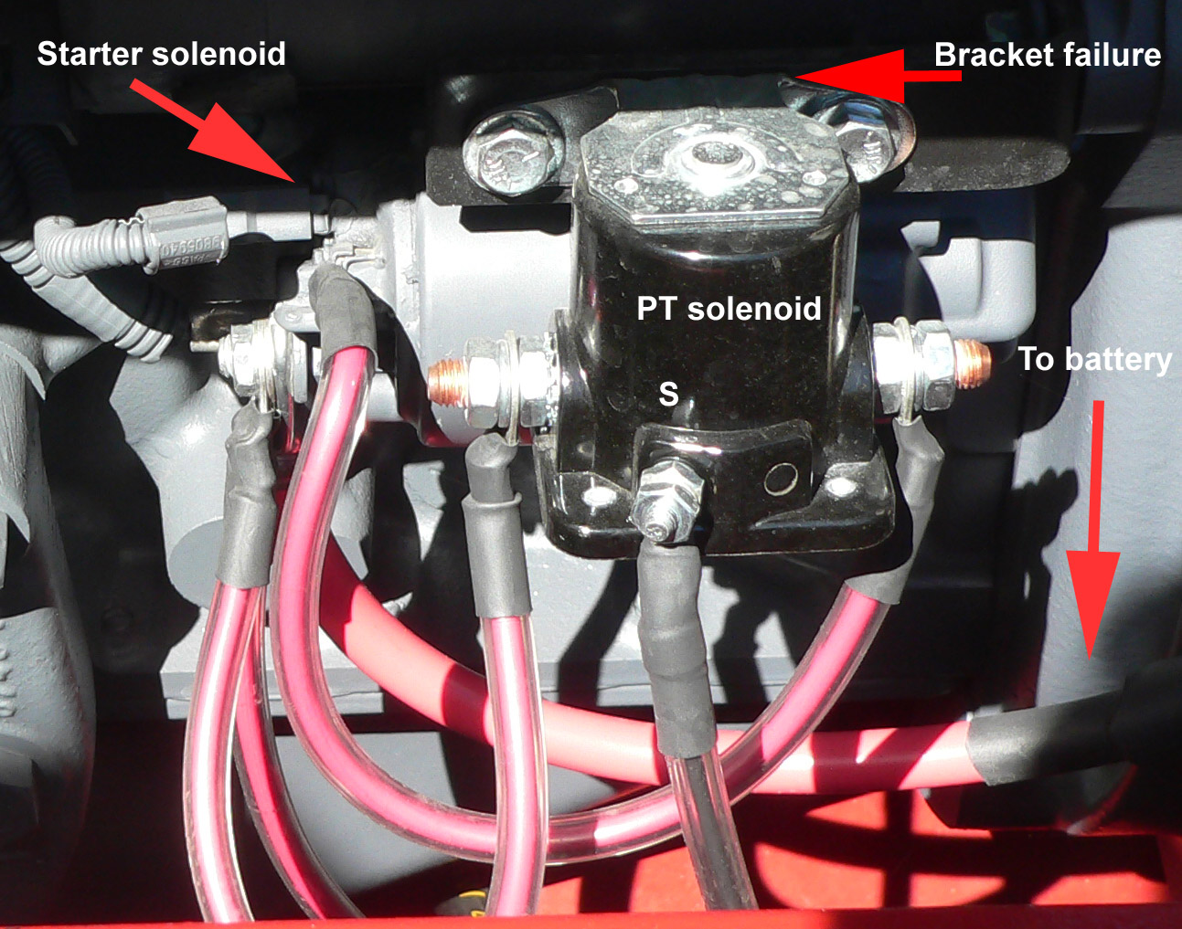

This is a little amusing.
I've been doing a lot of work on a corral for our horses. I laid out the grade (but that's another thread) and I've been trenching to get some subsurface drainage in. Trench a little, use the bucket to remove the spoils, repeat.
After some manual surveying, hop back on the tractor. Belted my self in. Put the key in the ignition, turn it, not even a click. I repeated it a few times, just in case the switch was dirty, but no luck. OK, must be the engine interconnect. Reseat it a couple of times. No luck.
Walk around the other side to check on the wiring to the solenoid. Hmmm. No solenoid. Gol durn coyotes must be getting real hungry!
OK it is after dark, but how can you miss a solenoid? Looking around, I realize it is hanging just off the floor of the tub. I think about holding it up, to manually crank it, but then I realize it won't have a circuit to ground to function. So, I leave it and hike up to call it a night and hit the showers.
About twenty minutes later, I start thinking about Sedgewood, and shorting and how bad it could get. I decide that discretion will result in an untoasted tractor for sure, so I hike down again, and take off the battery cable.
This morning, I stop by the auto parts store, and pick up a new "Ford style" pre-1981 starter solenoid. You only need a three terminal version, but the four terminal version is more common, and cheaper;
You don't need to connect up the "I" terminal, just the "S" terminal.
Three minutes later, we're back in business.
The old one had had a crack in the metal support that just got worse with time.
On Terry's advice, I added a rubber gasket behind it to reduce the vibration, but watching it, the solenoid certainly bounces around at idle. I'm not sure it will make much of a difference, but we will see.
Happy tractoring!
Peter

Dear Charlie,
You've got it on both counts. (resistor, and solenoid) Actually, I have two solenoids on the engine. Here is the logic as I understand it.
The Deutz starter solenoid (at least in the 2011 series) is apparently really, really sensitive to getting 12.5V to engage the starter. Apparently the long circuit path (over thin wires) lowers the voltage enough to keep the Deutz starter solenoid from functioning reliably, so PT added a second solenoid (the "PT solenoid") mounted on the engine about six inches away from the starter, so that the Deutz starter solenoid would have a high enough voltage to function. They are both just below the muffler.
I have attached a photo, so that you can see the layout. Basically, the battery is connected directly to the starter, a lead comes off of the starter to the PT solenoid, which is controlled by the ignition switch at "S", which then applies the full voltage back at the Deutz starter solenoid, which engages the starter to crank the engine. Is that clear?
All the best,
Peter

I think the older 1011 Duetz is quite sensitive to a voltage drop as well. there have been a number of posts on the subject where people, including me, have had starting problems when the voltage dropped. It is good to see that PT has recognized the problem and installed a fix. Hopefully your post will alert PT that they still need to improve the bracket mounting the solenoid!
/ PT won't start
Dear Bob,
If you have starting issues, it looks like the fix is pretty easy. If you do it yourself, I'd put the solenoid on the wall of the tub. You can look at the photo above to get wiring layouts.
The bracket is made by the solenoid manufacturer. Both solenoids look nearly identical. Short of relocating the solenoid to some place with less vibration, I don't know that there is much PT can do. I thought of adding a piece of angle iron on the inside, but bracket is reasonably hefty to begin with. Actually, I'm surprised it failed. Looking at it, it is clear that the crack has been there a long time, so I don't know whether it was a manufacturing defect or fatigue. But I only have 112 hours on the PT, so I lean towards the former. :) Terry didn't seem to surprised by the failure, but he's a pretty low key guy.

After reading all the post about starters and solenoid, I see no reason for a second solenoid. If you are getting low voltage to the solenoid on the starter, then the voltage loss is up stream, meaning thin gage wire, starter switch, or a neutral start switch. I had similar problems on my 1445, which has the Ford 4 cyl engine. I could start it by jumping the terminals with a screw driver, and also with an external starter switch. I replaced the start switch with a push button switch , and installed new wire from the switch back to the starter, bypassing the neutral start switch. Have any of you put a volt meter on the starter switch and the starter terminal and tried to start. How about a resistance check from the 12v source through the start switch to the start terminal, on the solenoid, with the battery disconnected? You might have a weak starter or low battery, or weak solenoid. We used to tear those starter solenoid apart and turn those big copper washers around and sand down the pitted areas. You should be able to hook up the solenoid and when 12v is applied, you should hear a good loud click, and if you have a meter hooked up, the voltage on the 12v out terminal on the solenoid should be the same as the battery voltage.
If you really want to fire that solenoid with it's own power supply, then you could use a small motorcycle battery to power just the solenoid or some other accessory and run a new wire, a relay, and a switch to activate the relay.
