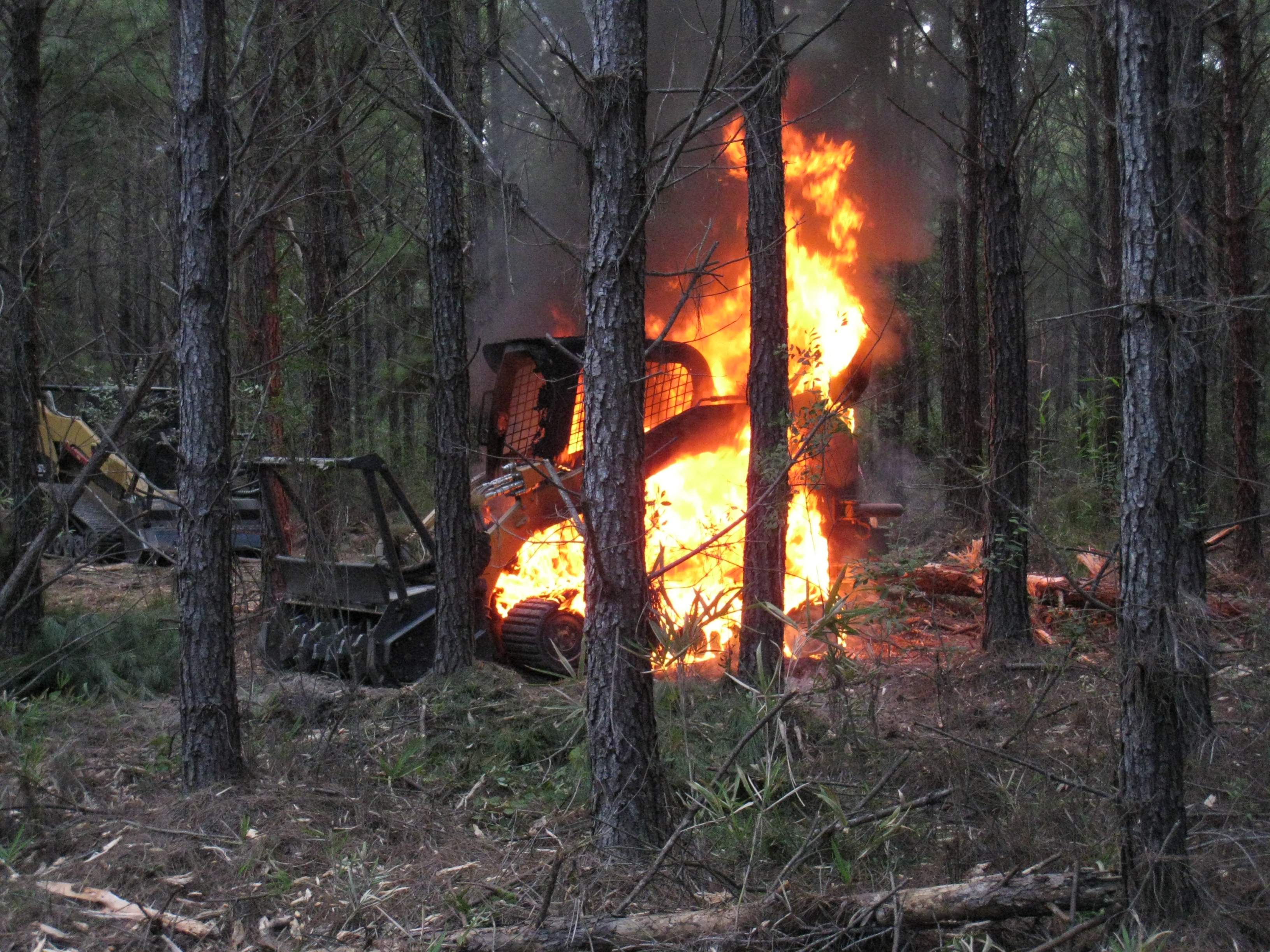

Couldn't put this one out
She was a rockin' looks like. That must have been scarey ? I don't like fire,especially when it's built under me.:laughing::laughing:

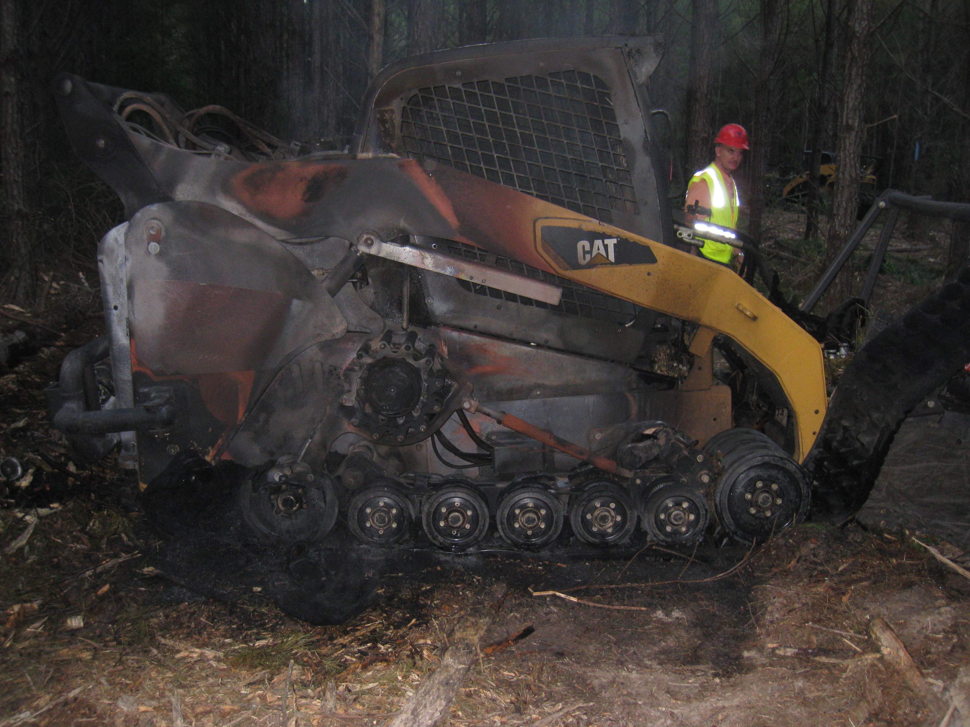

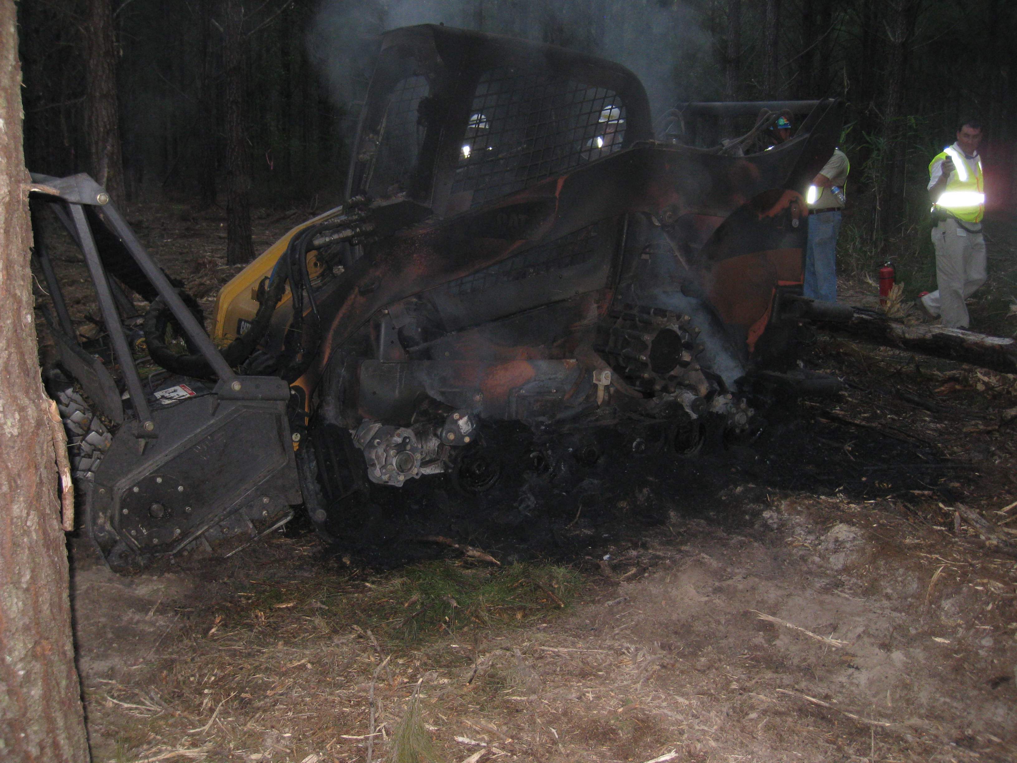

After
