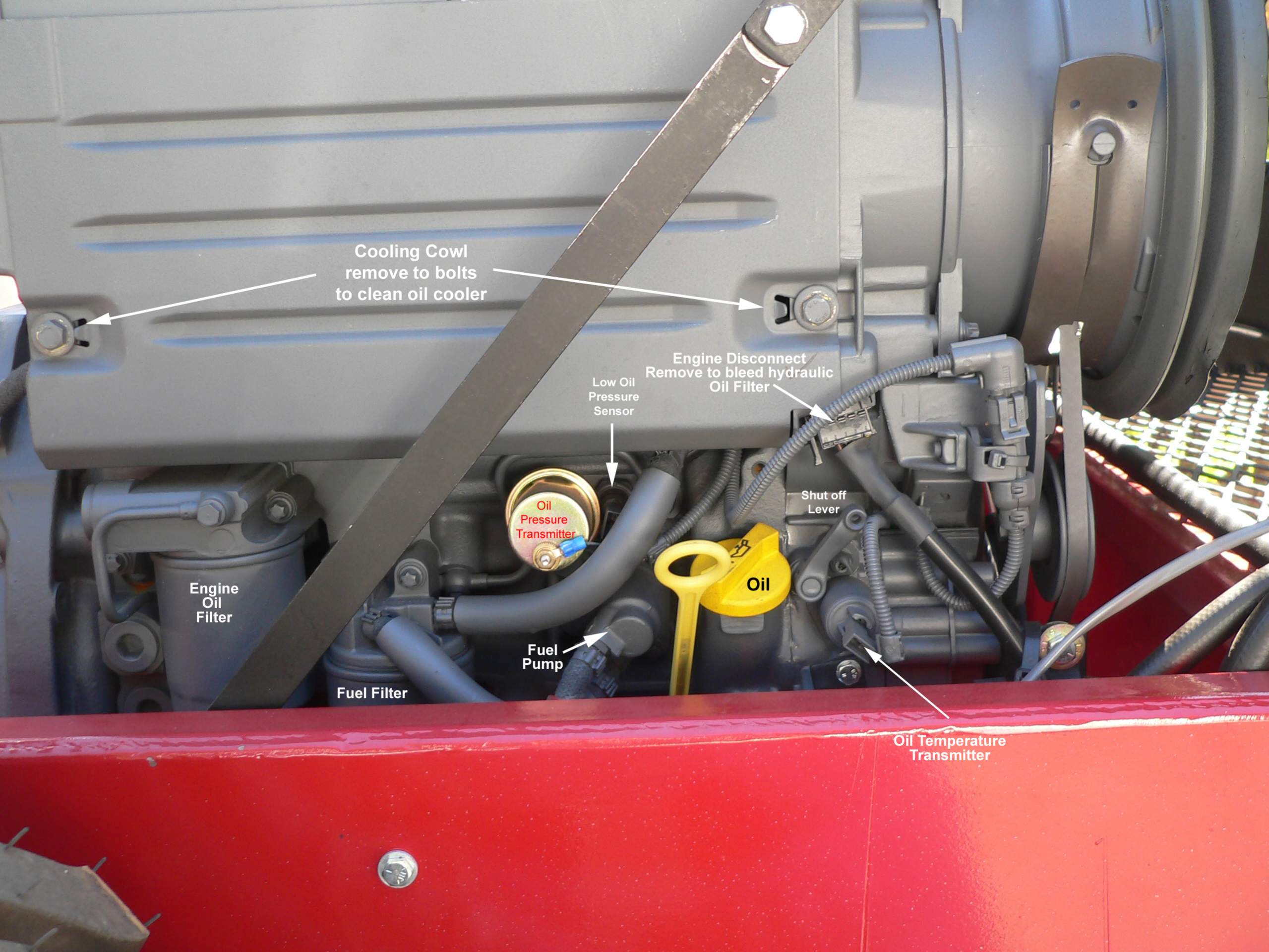

How do you guys bleed the diesel units, since they don't have spark plugs? What keeps it from starting?
There is a wiring plug on the engine that includes the circuit to the fuel solenoid. The solenoid is default (power off) closed. So all that is necessary is to disconnect the plug and then crank the engine.
   / PT1445 20 hrs, Lost steering! #102
On mine, even if you pull the clip the engine still runs.. Has both Terry and I stumped, but I now to hit it and stop immediately.
   / PT1445 20 hrs, Lost steering! #103
WF- That sounds as if someone bypassed the wiring to the fuel solenoid, or more likely, wired it to some other 12V circuit. If it were jammed open, you'd never stop the tractor, without using the manual shutoff lever.
MR- the engine connector is easy to to disconnect, but it does have a tendency to accumulate a certain amount of dust and dirt, as it is an unsealed connector. Of course, this is an added source of resistance in an already long circuit path...
Where is the "manual shutoff lever"?
   / PT1445 20 hrs, Lost steering! #105
Dear Bob,
It is on the left rear of the engine, just aft of the engine disconnect connector; I think it is labeled on the right side of the photo above. I think Deutz refers to it as a mechanical shutoff lever.
I thought about hooking up an emergency pull handle to the lever, and decided it would probably get stuck in brush much more often than I would ever need to manually disconnect the engine. I hope that it remains true... :) I have occasional thoughts of the PT owner who tipped her machine, only to have the engine race.
All the best,
Peter
   / PT1445 20 hrs, Lost steering! #106
Thanks--obviously I didn't click on the picture! And that particular feature was not included in the maintenance "training" at Tazwell!
