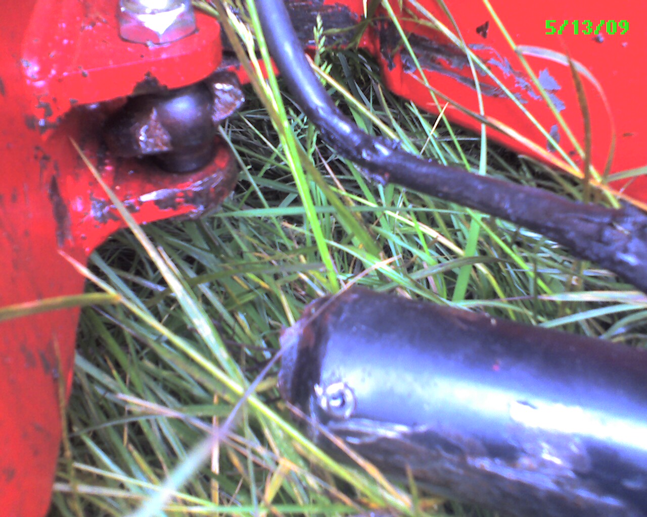

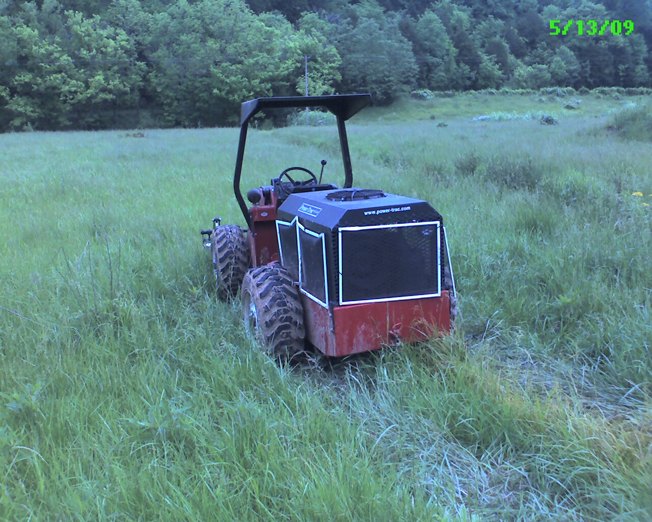

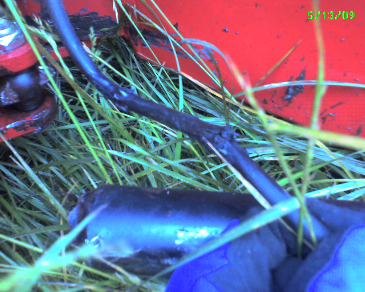

Back into town and able to load up the photos of the PT1445 in ICU.
Loaded 4 images showing the crack location, the metal scraped by the cylinder or whatever caused the crack, the hoses, and an overview of my PT1445 with attached screens - snazy huh?:D
No point in turning the air blue and hurling specially made "throwing wrenches" if this thing needs new components down the line. Talked with Terry and he said - like all of you have recommended - to check how much oil remains in the tank first. If it still has some left, then the pump and valves are more than likely still functional. If the reservoir is empty, then get out the checkbook, the credit card, and sell the family jewels, because everything might be burnt and need to be replaced.
All I was doing was ramming the multi-bucket into a hill to pick-up dirt. There are some rocks in the hill of dirt. Nothing unusual with that. Cracking the cylinder means that the hydraulic system can load the components beyond their compression, tension, or shear maximum strength. This begs for either a pressure relief valve, or a servo bypass. Better still, stronger components.

pt1445farmer from what the pictures looks to me it is the end of the cylinder that broke, you may be able to get a new eye to match the one that broke and have the rest of the old one ground off of the cylinder and have a new one welded back on providing that the cylinder rod isn't bent. It appears that the one hose fitting was ripped out when the cylinder was extending or contracting after the eye was broke. When you replace the bad hoses you can hook them up to the old cylinder and check and see if it will extend and contract without binding, make sure that the ends of the cylinder has freedom of movement since the end of the cylinder that is broke is the stationary end. If you take both hoses off of the cylinder you might be able to manually pull the rod out and push it back in to check the rod out. If you take any of my advice be careful as you are working at your own risk. To get the broke end of the fitting out if you can't get a good hold of it and have to use an easy out to get it out I like to use a left hand drill bit first because often times they will spin out the broken part as you drill and you don't have to even use the easy out. also try to get all the metal shavings out with a magnet. Hope some of this might help and you get it going without much trouble. If you have a bad steering jack[cylinder] if you block the hoses off that goes to the bad cylinder then that will make the good one steer the machine somewhat inorder to get it loaded and out to where you can work on it, but go slow, and have the bad cylinder disconnected. In any case be careful as you work at your own risk. wish you good luck at getting it going.

Toy - Not sure I follow what you are referring to with a left hand drill bit, easy out, etc. My plan includes removing and replacing both cylinders. While I might be able to repair the snapped one, it is not a priority at all. That puppy will never be on my PT again, though I might find another light duty project for it.
