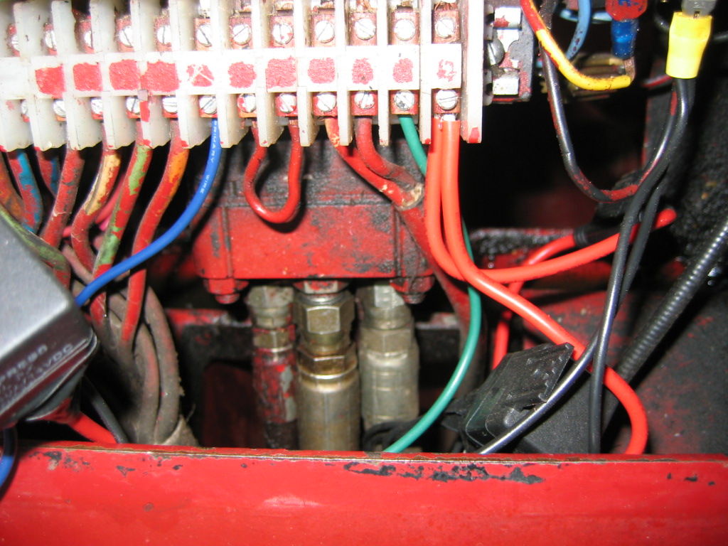

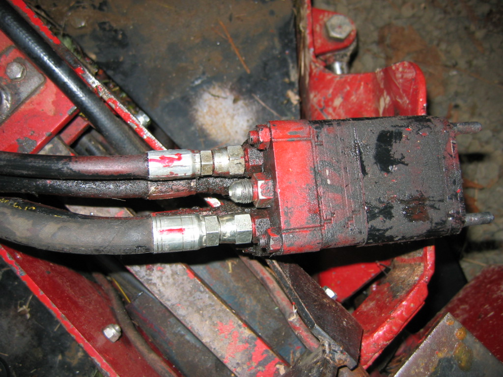

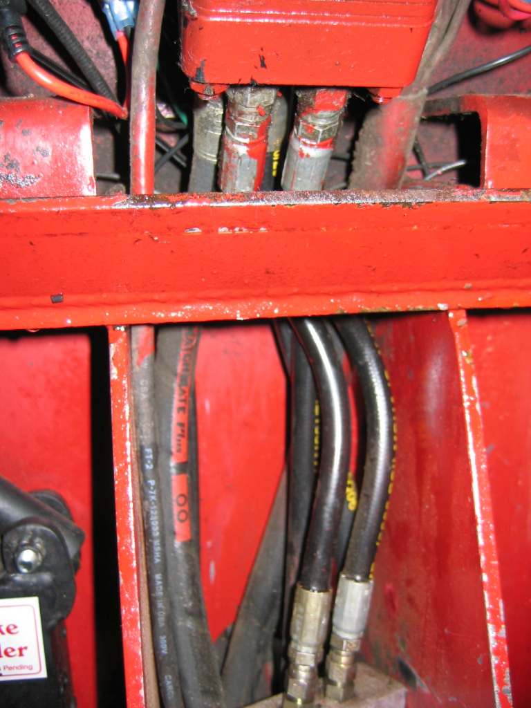

Also, do you know how to replace these hoses? They both run up to your steering column. This is NOT fun. Is the other hose toast, like is the end of it missing or does it still have a connector.
Here is my recommendation on running the hoses, and I think this is from JJ. Get yourself a barrel connector,something that is male, male on both sides. Hook your new hose up to the old hose and pull it through the tunnel. You need to take off all the protective covers (black with 7/16 bolts) and I would take it from the tunnel all the way up to both sides of your steering control, as well as take off the protective side plates down by your feet.
If you can get someone to come out and help you, you will be happier. Not only will you be easier to pull the hoses, it will give you someone to yell at when it goes south. Do one hose at a time.
I think pulling it from the cylinder to the steering will be easier, but it is kinda 6 of one.
This repair is easy, so don't sweat it too much. Just hard to get the hoses undone from the steering column. Do only one at a time. btw
Hmmm. Now that I look at my pix I am trying to wonder if you have to go all the way up to the steering with the hoses. There was this weird junction that appears in the bottom of one of the pix..
Whatever, you will figure it out. Each PT is different so it will be interesting to see why this went south...

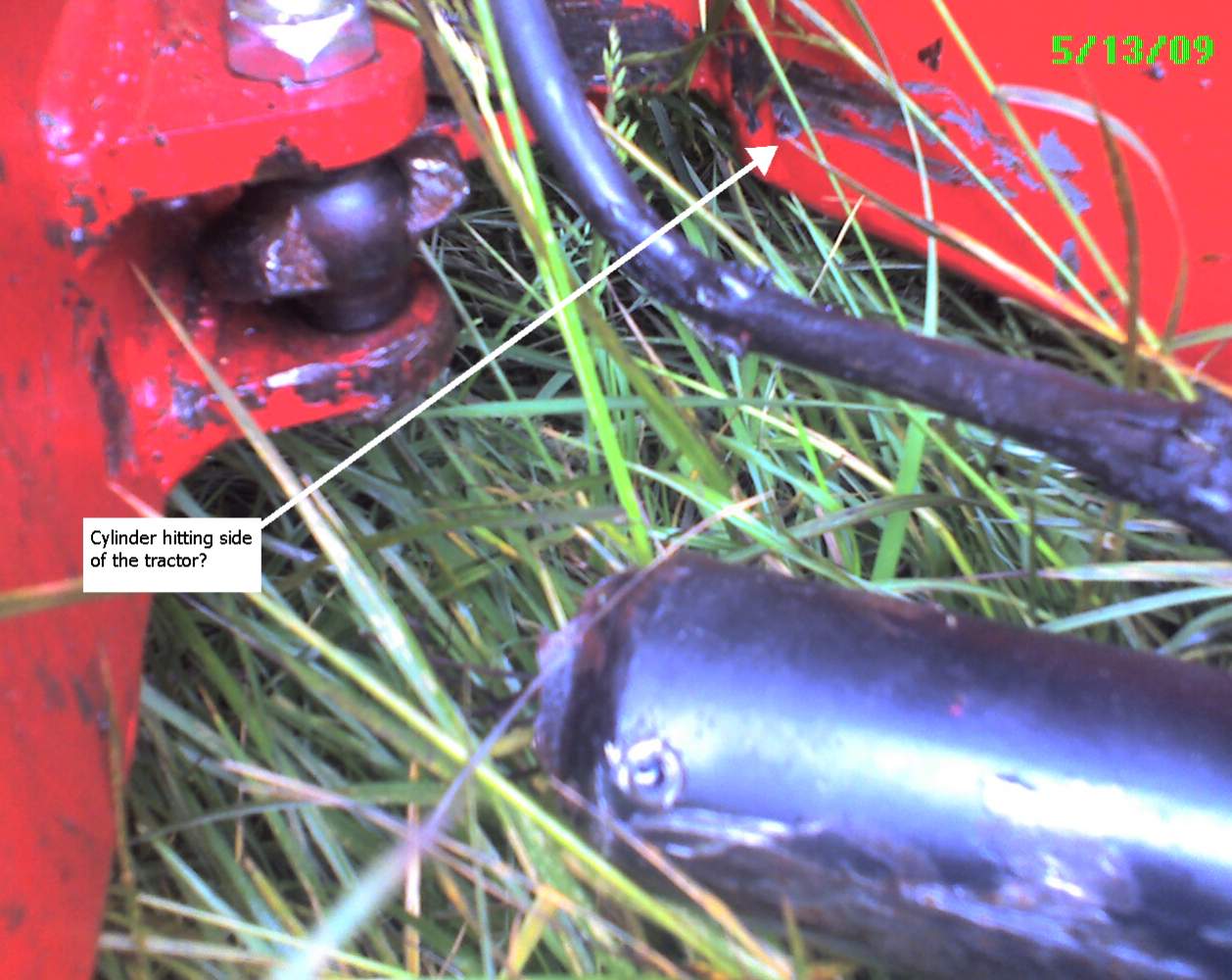

   / PT1445 20 hrs, Lost steering! #39
Was the cylinder hitting the side of your tractor when you turn all the way to the left? It looks like it even bent the plating. If so, this is the source of your problem.
#40
Toy - Have several of those bits in my machine shop, so will keep one handy if I see the need during the repair. Also, I am going to modify my technique for loading the bucket. Was definitely working the PT too roughly and have learned an expensive lesson.
About bending the plate or frame..If the cylinder does not fit, then I have another repair. I think the cylinder was caught while the other cylinder forced the PT to the right and the broken cylinder was caught and bent the plate.
Will know more on Monday.
I expected my PT to work with nothing but maintenance for years. Not using it for serious farming or anything. Already that wishful thinking has been set aside for the reality of keeping the engine from overheating, going through a huge challenge at my 8 hour maintenance, and now this. Still made the right decision though. When it works, there is nothing better.
