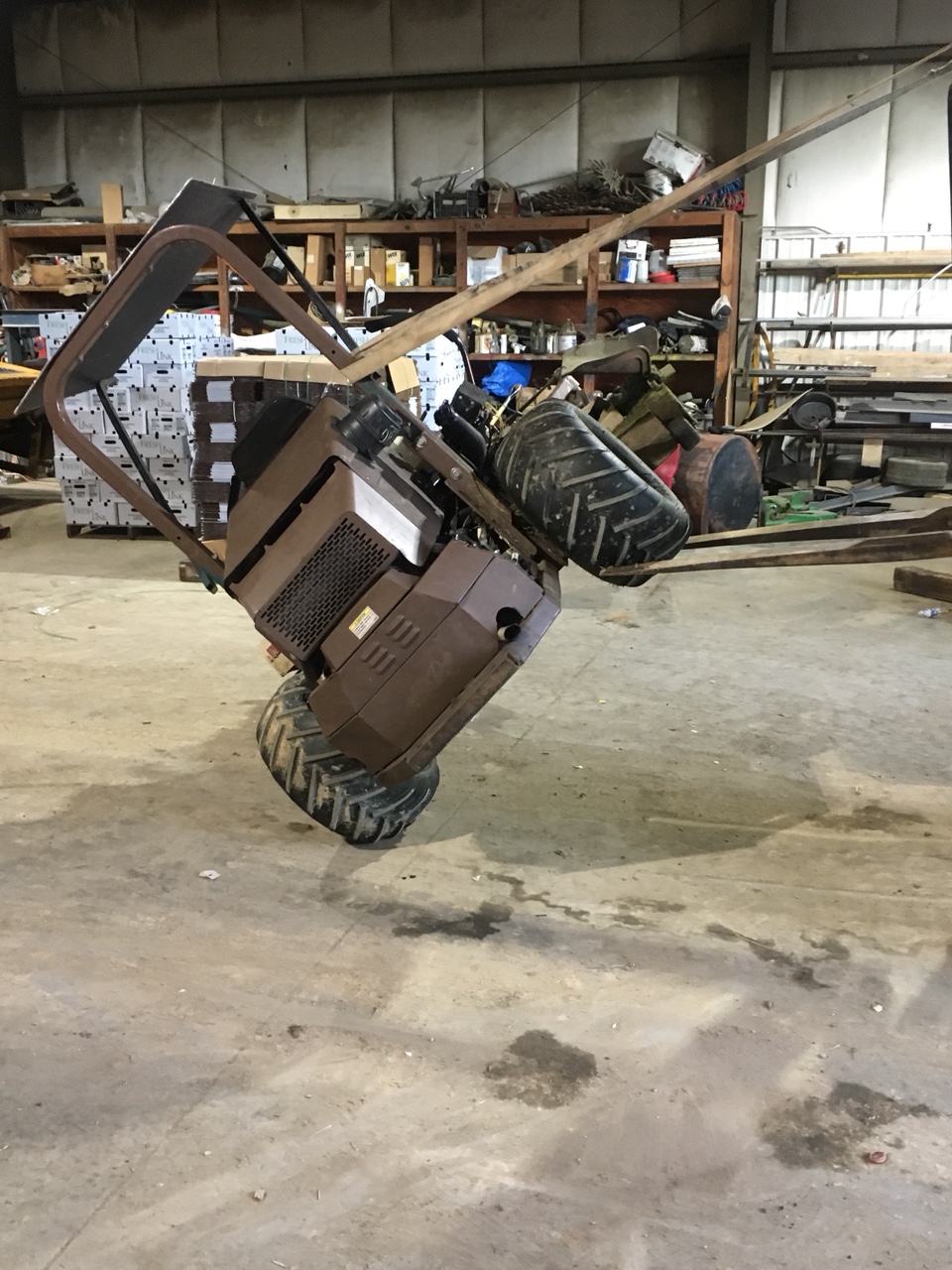

   / PT1850 Tire Pressure - 10 Ply Tires #16
This is 48 degrees. I’d like to see someone drive access a hill that steep. IMG_4414.JPG

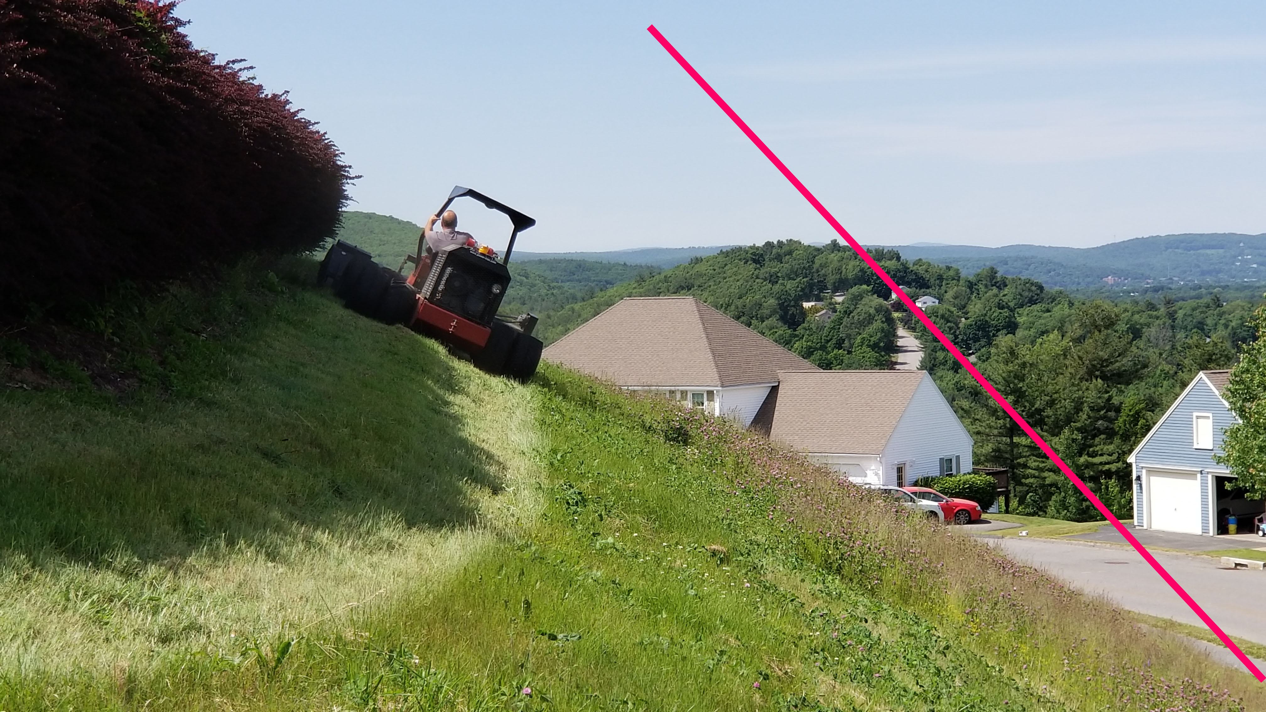

   / PT1850 Tire Pressure - 10 Ply Tires #18
The previous owner showing it off before I demoed it. Where the tractor sits in the pic is ~25*. The bottom of the slope, towards the road, "below" the red car, is 30*. It is tense, but not uncomfortable. The pink line is 45* and seems completely unfathomable to me...
I've taken the 1850 to 30+ a fair amount and after putting a permanent crease in the seat of the JD on some of my hill, the PT is very comfortable! The loss of traction becomes very apparent at and above 30, especially mowing brush. The whole bed of material starts to shear off and I quickly find the tractor in a drastic crab to move across the hill. It isn't as bad with just grass, but still noticeable.
I don't feel like the bar tires are really the best thing for a slope. I would like to try it with field trax or with the tires that come stock on the Aebi, on the outside to see if it was any better...
