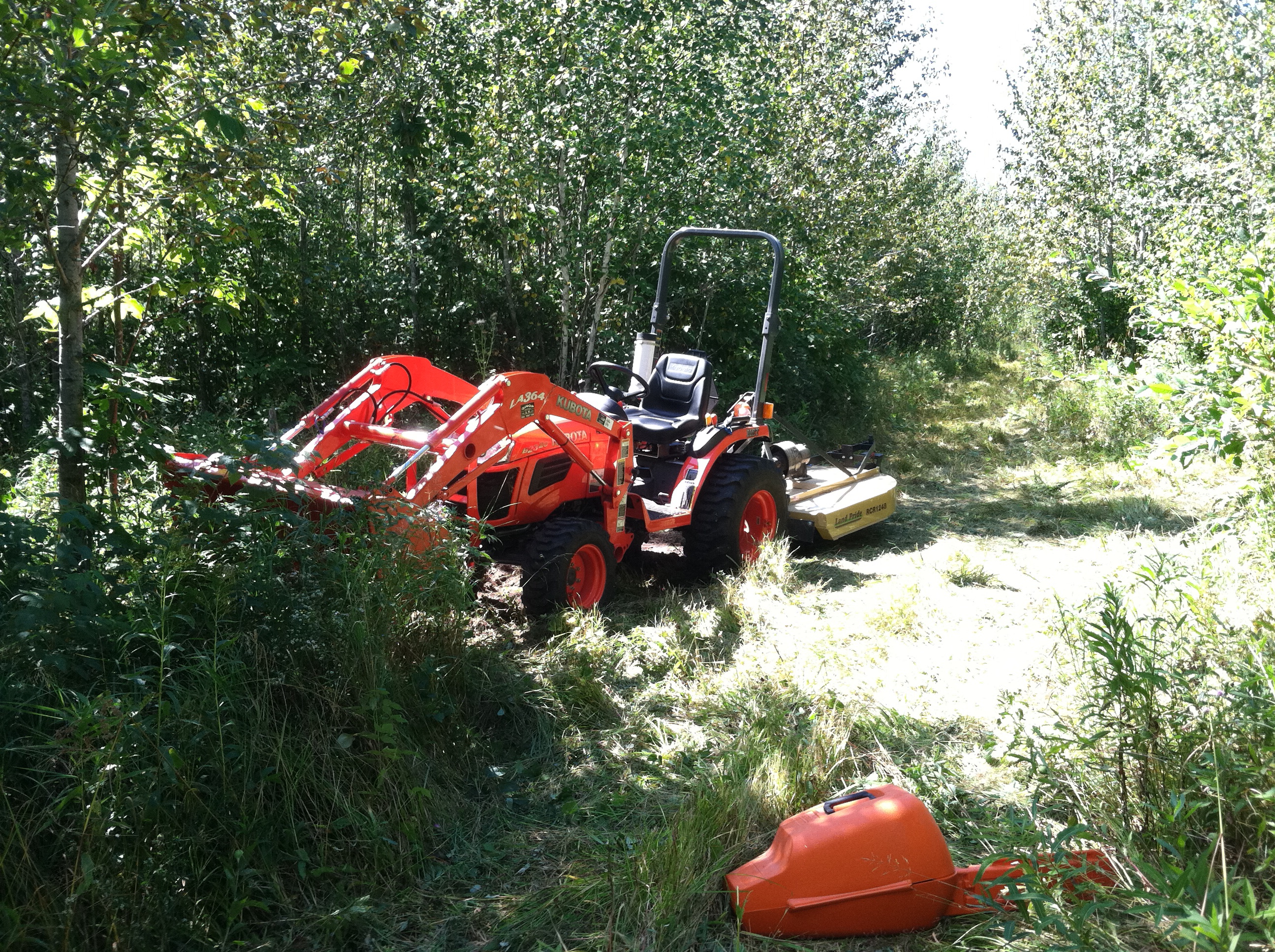

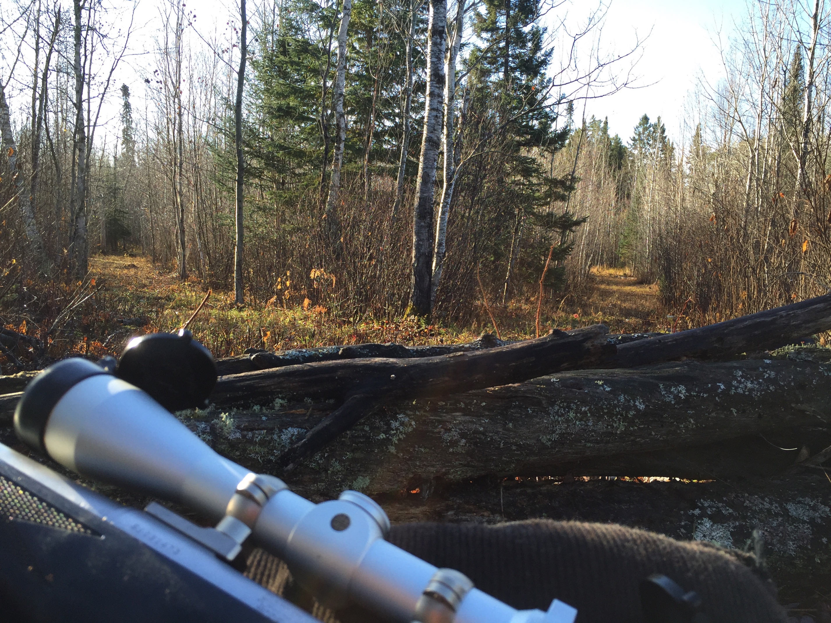

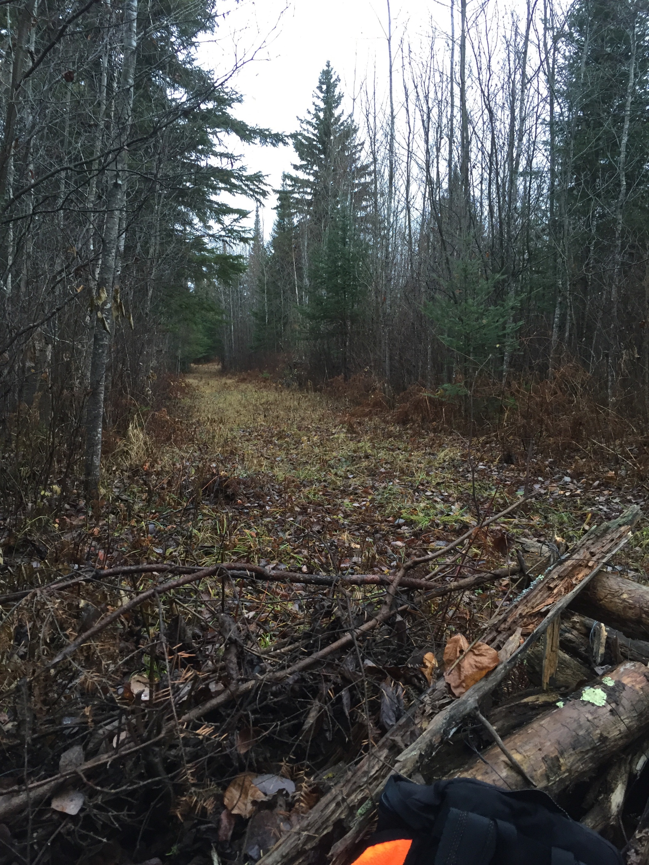

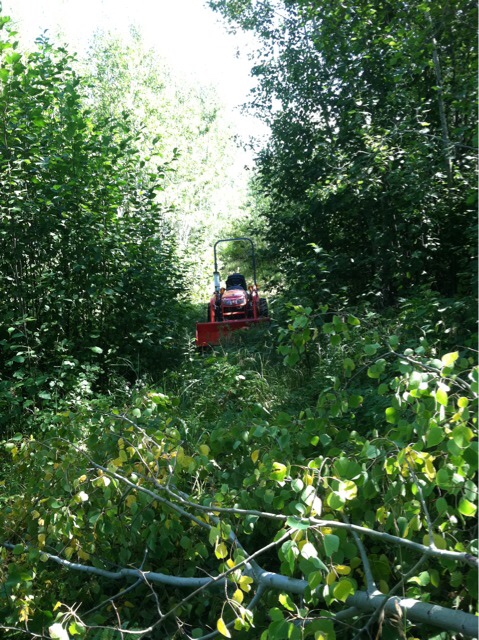

I own & maintain 330A of hunting land in Canada, and my brush clearing is probably 2-3 miles of old skid lanes and shooting lanes. I started with a Stihl FS-110 hand held brush cutter, and would spend 6 full hard working days, like 10 hours each, cutting that stuff. Great tool BTW.
I then pulled two different Swisher cutters with an ATV. First was really a grass cutter, second was a trail mower. That cut the work hours significantly, but I couldn’t turn the rig around on tight lanes with the looong tongue on that second cutter. That meant I had to unhook the 440 pound contraption, turn it around by hand and restart countless times each day. Moving that sucker in dense stuff was killing my back.
Last 6 years I’ve used my B2320 with a LP RCR 1248 bush hog. Night and day difference. I can back around in very tight quarters, no stopping except to use my chainsaw on fallen trees, and it cuts well. I can now do all my cutting in two pretty easy days. I do leave my loader on to carry my saw, plus push stuff outta the way. My B2320 will go everywhere the ATV + cutter went, and then some.
I highly recommend a bush hog and a Stihl hand held for stuff you can’t reach with the tractor.

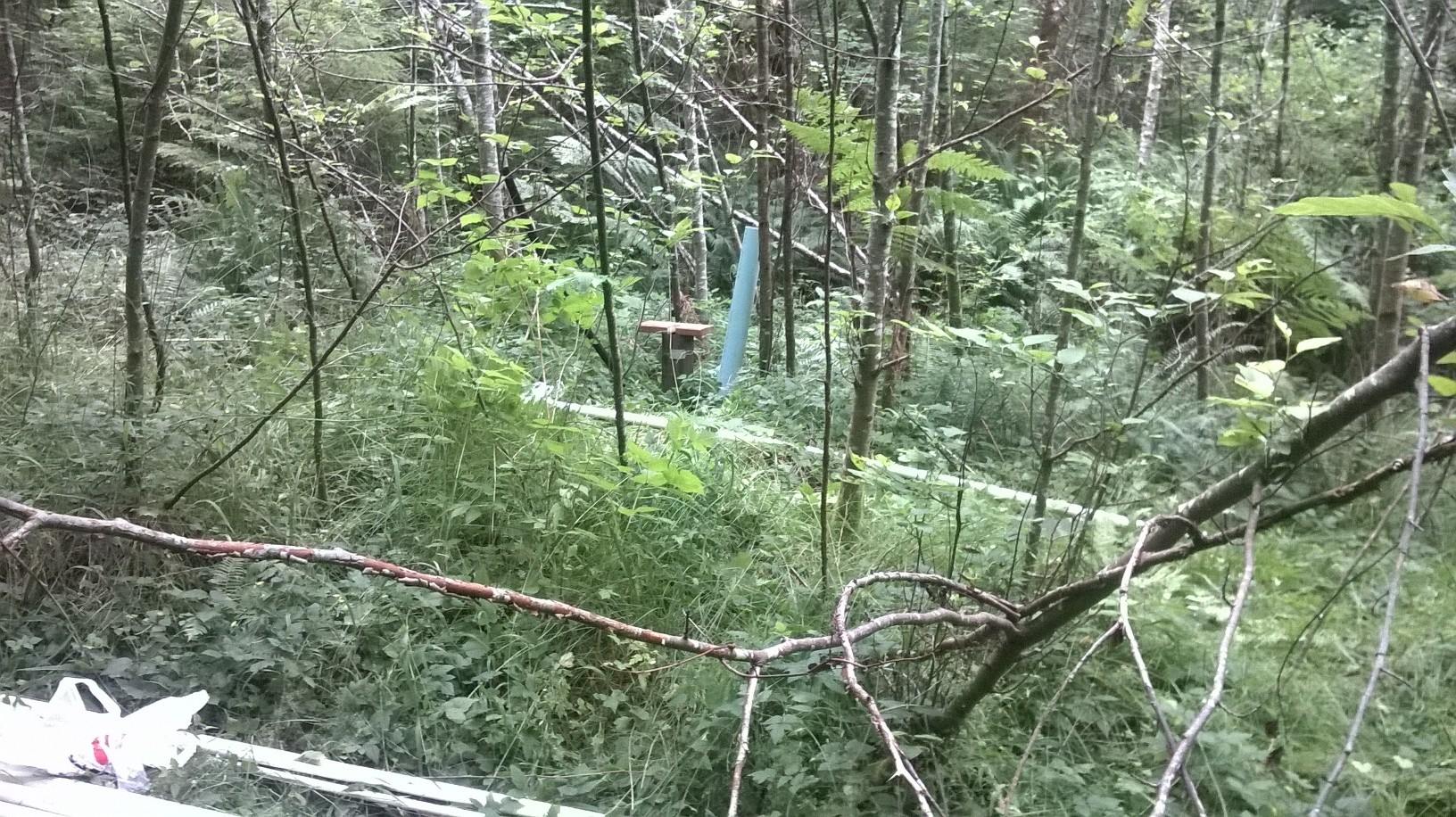

Thanks everyone for the great advice. Here is a picture of the type of stuff I am trying to clear and this is one of the more open areas, the rest is basically NW jungle. I have been hiring a machine to come out and clear that tackles the big stuff by basically mulching right in place but I am still going to need to maintain after it is all clear.

Looks like poplar regrowth? I run my tractor through that + tag alder, willow, etc. My 48” will handle 2” saplings, but I’ve driven over far larger ones that I’ve pushed over with the loader on the side of trails. It sure won’t chop up a 3” sapling like a small one, but will teach it a lesson.
