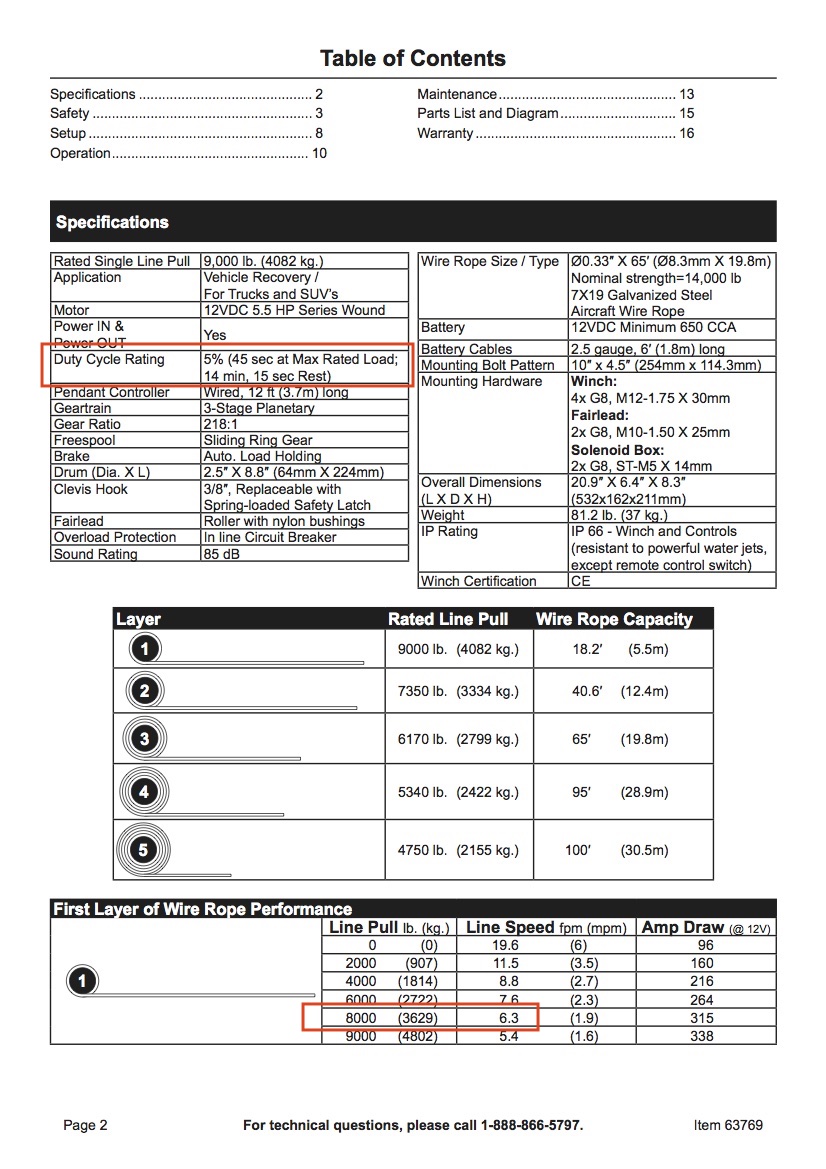

I have multiple logs and trees I need to skid out of s slough. I have a new 7,500 lb electric winch that I bought after someone posted a link on this site a few months back. It has 55' of steel cable and a 30' control cable that would keep me out of the line of fire. With several 50' chokers I could extend the reach. I was thinking about a 3 point mounted heavy plate to anchor the tractor and a short mast with a sheave to elevate the line pull. Anyone have an opinion about my poor mans plan?
   / PTO Capstan Winch (from scratch) #42
Electric winches are very slow if used near their capacity. Slow line speed for a minute or so, then a long cooling time.
Here is a HF 9000lb winch. Note the duty cycle and line speed (in red rectangles). It can run for about a minute at 8000lb, pulling about 6 feet, then a 15 minute cooling off period. That's around 25 ft per hour. At about 1/4 that load you will double your line speed, and reduce cooling time, but still slow.
Bruce
   / PTO Capstan Winch (from scratch) #43
Not to mention big electric winches draw huge amounts of current, and most Tractor alternators are really very small. Usually no more than 50 amps. Now where near what a large winch can draw. So hope your battery is in good shape.
   / PTO Capstan Winch (from scratch) #44
Thanks bcp......I didn't have any idea that the duty cycle was that low. Glad I asked! I'd say my design concept is a total bust! I guess I'll keep thinking.
   / PTO Capstan Winch (from scratch) #46
You can replace the alternator there are a number of them that I've found that work and will give you 200 amps or so. But that won't improve your duty cycle or pull speed.
