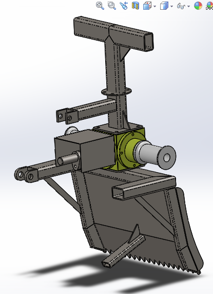

One final addition, I forgot to post the CAD files I made for this:
These are all SolidWorks (2013) files. The model isn't exactly the same as the built thing, but it's pretty close. You can take measurements off the model to get some idea of the scale of things.
This model also includes an unfinished top-link extension idea I'm still kicking around (to hold a pulley up high, like Farmi winches have).

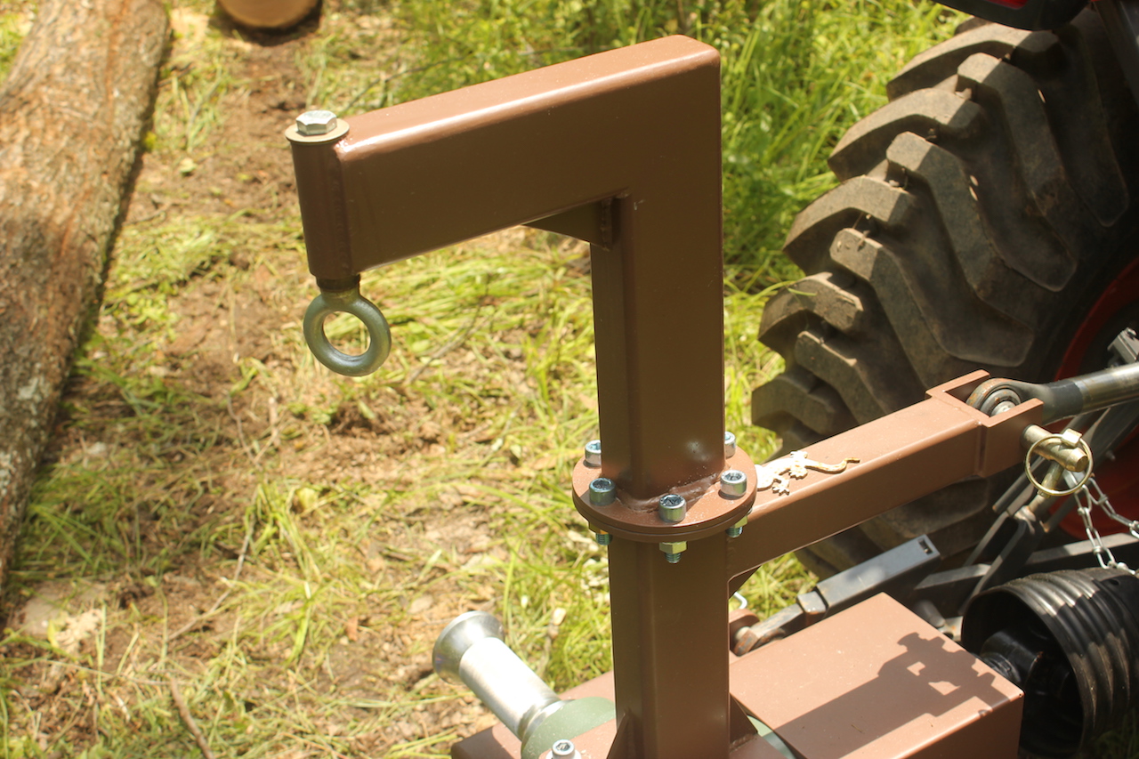

Here is the new redesigned top link attachment, with swiveling upper guide loop:
You can run the rope through the upper guide and get a little bit of vertical lift, makes getting over rocks a bit easier. Or you can skip the upper guide and just do a straight pull. Not a huge difference between the two, but it's better than nothing. I made it bolt-on just incase excessive winching forces destroy it. It flexes a little in use, but seems like it will hold up.

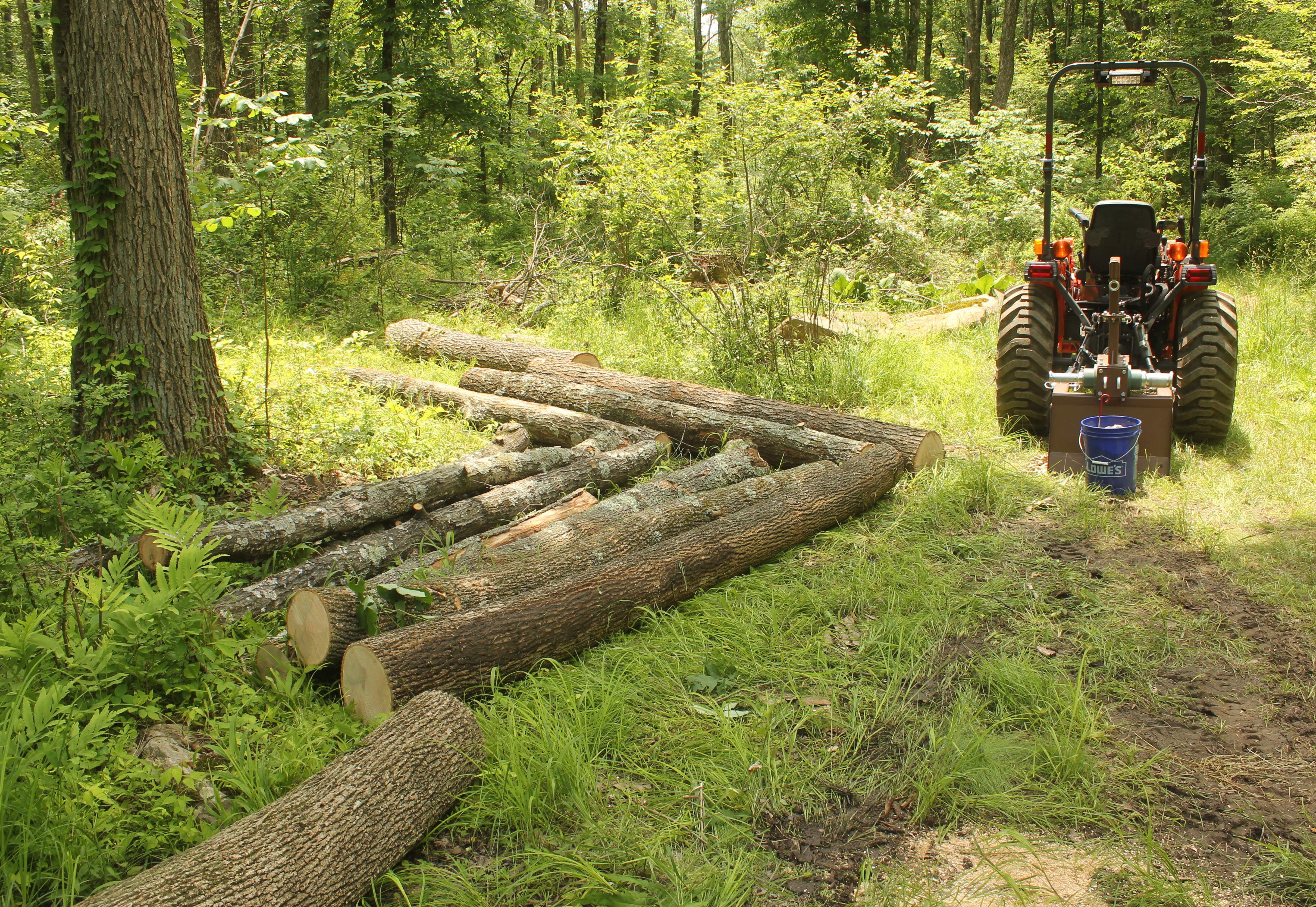

Here was todays haul, a 50' red oak and a 40' ash:
Winched both of them as whole trees, and then cut them into 10' lengths as they reached the tractor. No rocks in this area so it was an easy pull.
