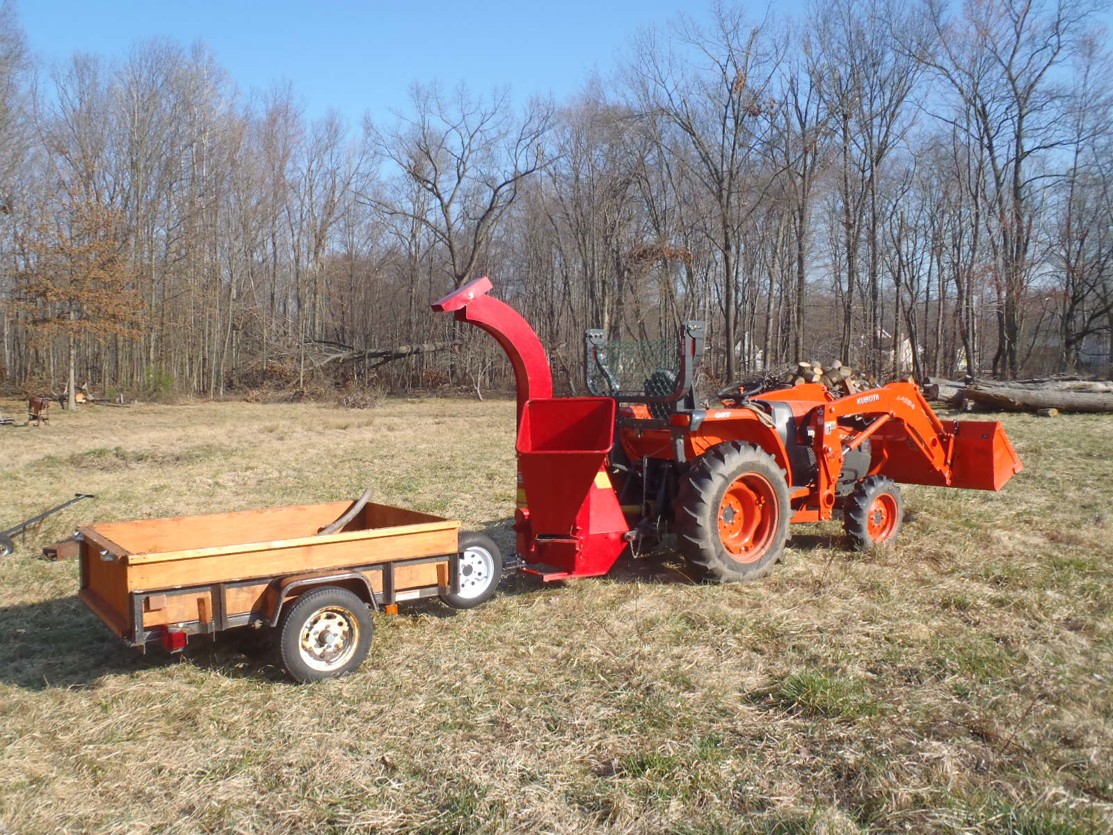

I added a drawbar to the back of my Patu so I can hitch a trailer to the back of the chipper and drive around, stop, and chip limbs directly into the trailer, then drive to the next limbs and repeat.

Well I have had the Wallenstein BX42 chipper about 3 years now. :thumbsup: I would stick with Wall. company if I wanted the brush chopper unit. Just have nothing bad to say about the unit. I keep a factory looking edge on the blades by never letting them round over like mower blades. :) That means a light sharpening every 2-5 hours of use. It's not that difficult and so much easier than letting them get really bad. :2cents:

I've had the Wallenstein BX42 and now have the BX62. Never had a moments problems with either. I found that with the '42 I had to take preventative measures to keep the smaller diameter chute from plugging when chipping green pine trees. Its easy - just keep dry limbs/trees handy and feed them thru every so often to clean out all the pitch. If it does plug - its easy to open and clean.
