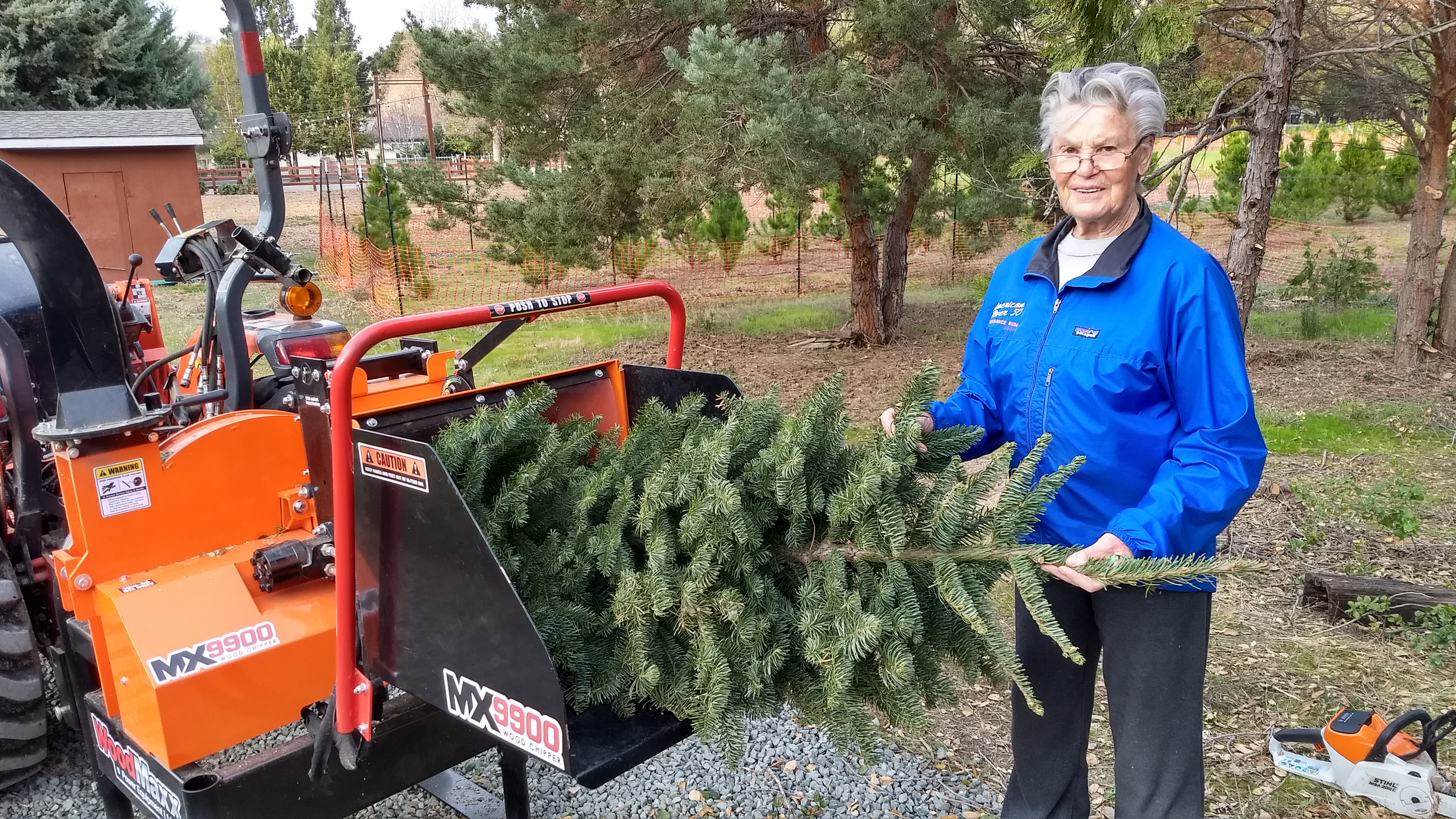

Update with picture...
Had a chance to use the chipper today... in general it worked well... no bogging down of the L3800 and the chipper part worked well most of the time.
What did happen with larger branches... either on or separately fed is the tendency for them to wrap around the feed wheel...
It is still a leaning curve with more to learn.
I also had Mom there helping...

I've yet to have anything wrap around the feed wheels on the 8H. OTOH a couple times I have had larger branches with stubs get wedged with the stub in the travel slot for the upper feed roller. Once I had to hack it apart through that slot before I could pull it back out. It's a known issue and the MX's design is different in that area. It doesn't happen often.
Is your MX's feed rate easily adjustable? On the 8H the feed speed control lever goes from 0-10 but all the speed change happens in a very narrow range at about 3.5 making it difficult to set. It's my one real problem with the unit (other than not being big enough, but a chipper's never big enough). I have a lower GPM valve on order.

The bar adjusts the feed rate... did not play around with it as things were wrapping up when I got there after work...
The tree in the picture went right on through... no problems.
Some individual long branches from 12-14' Nobles are very supple... twice branches wrapped around the feed roller...
Maybe being so green and the species being a factor?
The unit sounds good and is well matched the L3800 from what I can tell.
The initial problem was greatly improved by resetting the clearance on the knives...

The only time I have ever had anything wrap around the feed roller is when I'm chopping up grape vines, and that's only if they get toward the outer edges of the feed roller. I've also noticed I have less of a chance of wrapping if I slow my feed rate down.
