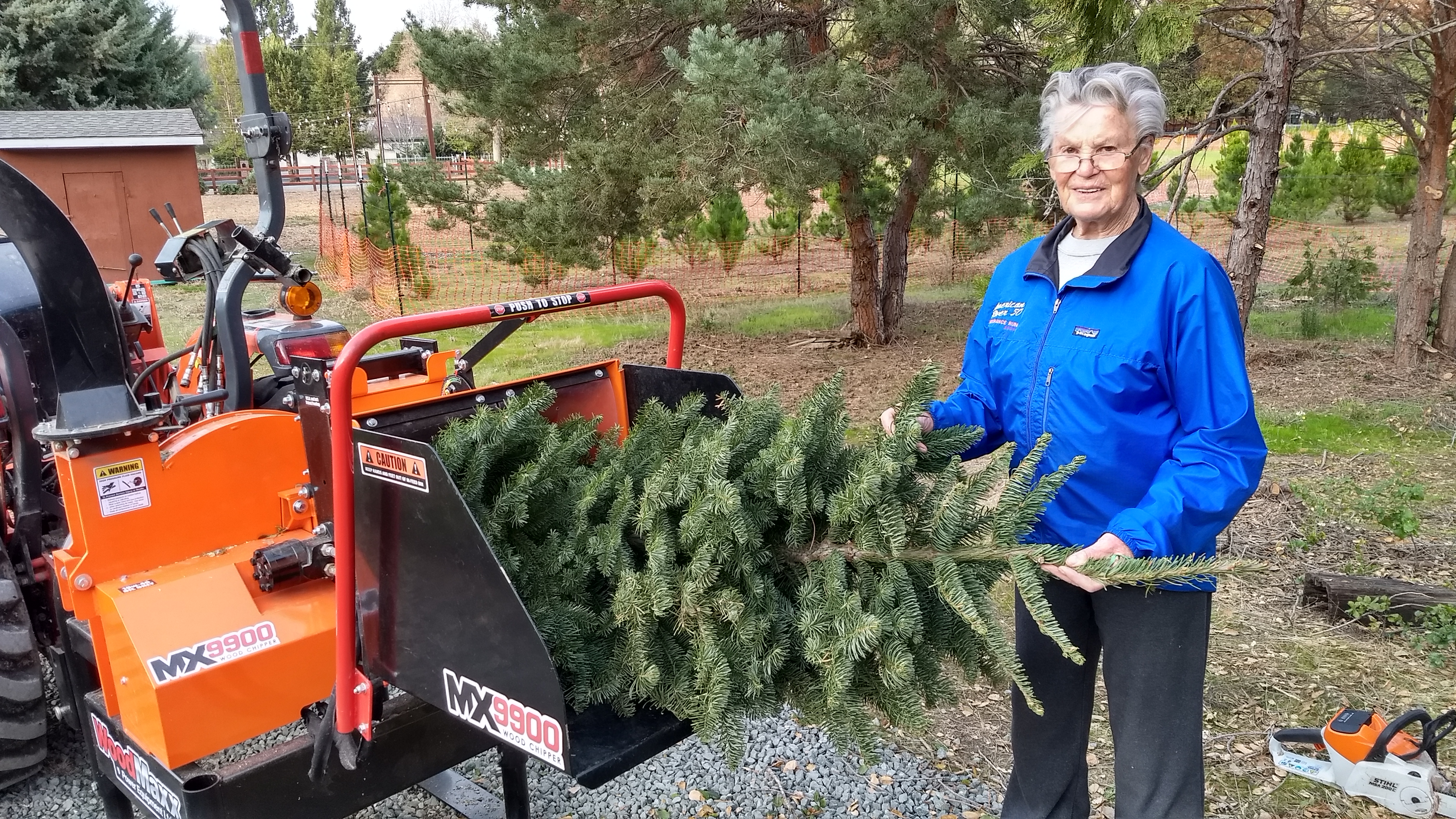

Should work fine... we use it for Christmas trees.
Out of the box it did not work well until we adjusted the knives... the gap was too large as delivered.
