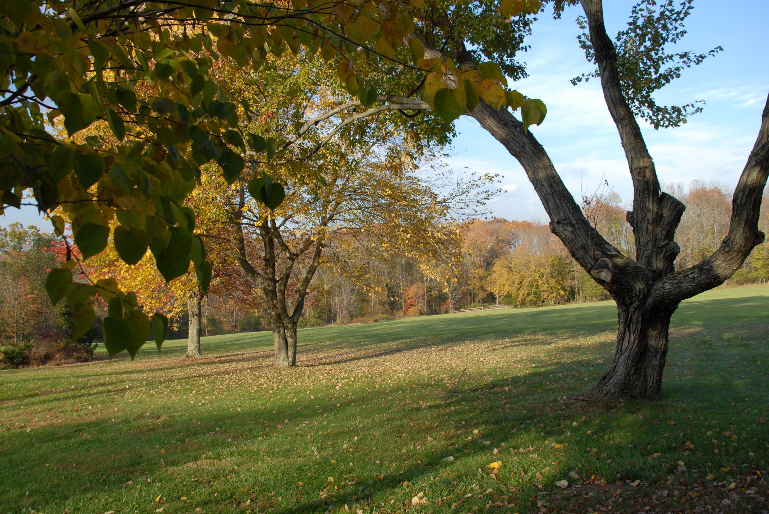

The owner's manual specifies not to mow on a slope, but across it. No mention of how deep the slope. As for the tilting, if I couldn't drive on a tilt, then I wouldn't be able to mow at all. What's a person to do with undulating land. FWIW, people really ought to read for content and address things accordingly. Assuming someone has not read a manual or been taught tractor operation is an incorrect assumption. As I mentioned several times, I have Kubota mechanics here several times a year and they are wonderful and helpful. Also, I've been driving the tractor for decades to harrow my riding ring. It did not need the pto and that was what was new to me.
Now, to sunandsand, do you consider this slope one that would would not mow on? I mow up and down this slope all the time. To mow across it, would put me on a slant.
Pretty place!
Yes, I'd mow on that. I'd be a tiny bit cautious if the grass was wet, and in any case, I'd keep the FEL down low to keep the CG low. That slope wouldn't bother me. Ten degrees lean (guesstimated), yes. 15 degrees, hmm, maybe, maybe not. More than that, nope. That's just me, some people are comfortable with greater "leans", I'm not.
Your previous experience is a great help. I've seen lots of people (myself included) who got to start from ZERO - here's your key, thanks for the money (sometimes), bye.
