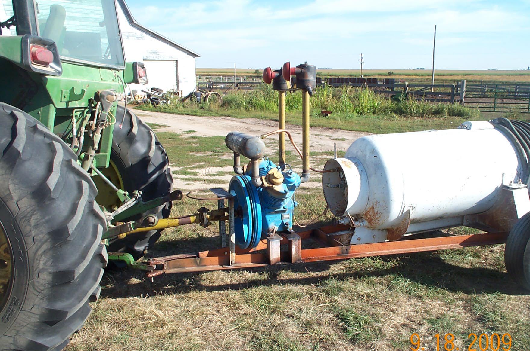

this is what I came up with, I have a 540 and a 1000 pto shaft, I do not rember but some where between 50 to 75 cfm at 125 psi,
I checked yours out when searching. Awesome setup!

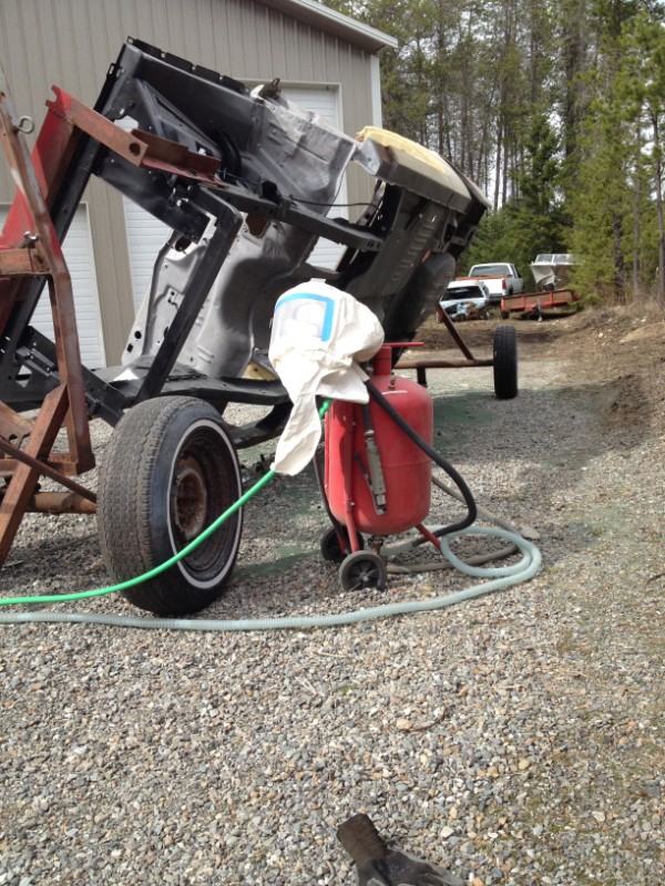

Here's the blasting project.
The white hood is provided with fresh air by a used CPAP unit (used for sleep apnea).

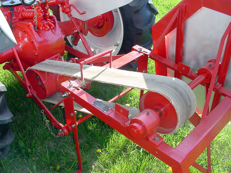

A right angle belt drive pto gearbox like this would make a nice driver. I have an extra one of these, and I always thought about taking the flat belt pulley off, adding a v-belt pulley, and driving an air compressor with it. With the pulley arrangement, you can match pump speed as required. Plus, I have a 3 speed pto, so that helps as well. Mount everything on a carry all and off you go. I have a 18 scfm 175 psig in the shop, so I have all the air I need there. I also have a 10K generator, so if I work away, I have enough electricity to power all my saws, drills, battery charger, and even a small 15A compressor. Philip.

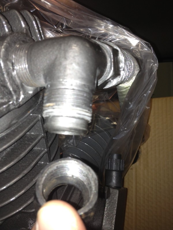

I'm puzzled by this fitting. It's a flared fitting like hydraulic hose but with a nut kinda like a copper compression fitting would use. Anyone know what this is?

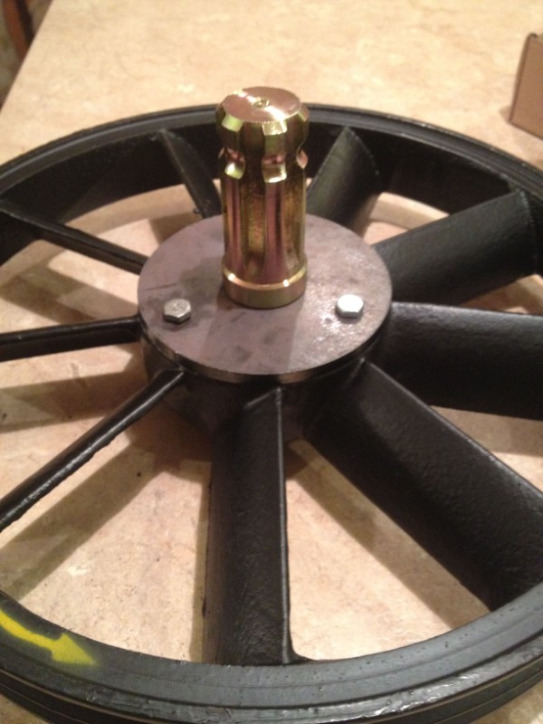

The other pic is the pto adapter ready to be welded onto the 1/4" plate which is bolted to the flywheel.
Edit: OK so its just a flare nut fitting. Never seen such a large one and don't have a 3/4 flaring tool. Another challenge...

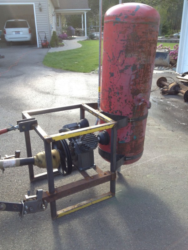

Here's some shots of the assembled unit. The tank was free from a friend. I think it is off a large truck but not sure. The tank saddle was bent out of 1/8" x 4" steel.
The compressor output fitting is 3/4" OD flared copper. A nuisance to track down as this is not used in general plumbing. I finally found it at a compressor shop :ashamed: :laughing:
I installed a 150 psi blow off valve and have an overload valve waiting to be added before I put it to work. I wound up taking it to my local tractor repair shop to get an opinion on a PTO rattle when down at idle at higher psi. We decided it's due to a combination of straight cut gears driving the pto, and the on/off rotational forces of compressor function. I was advised not to worry. It won't be running at idle anyway.
I'll paint it Kubota orange after it has proven itself.

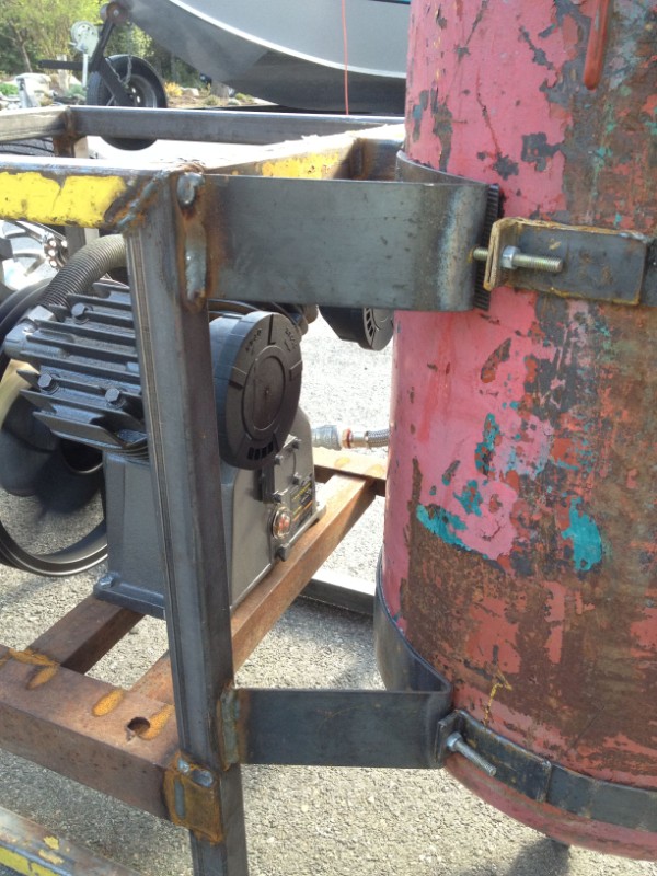

Nice unit. Just a few comments from my experience. The vertical tank is not well supported, and will put stress on your piping. Laying the tank horizontal will be much more stable. Philip.
/ PTO driven air compressor
#20
Thanks for the input.
I chose vertical so it's more compact for storage. It also gives the option of adding a second compressor mounted above. The drain fitting on the bottom is set up so it contacts the ground providing tank support and balance when not connected to the tractor. I may add something there so it does not sink on soft ground.
The mount is actually quite solid. There is no movement of the tank during operation. It might be a concern if it were being transported long distances on rough ground but such is not the case. The compressor does bounce somewhat while running. The piping has a flexible connection so the solid pipe is not affected.
