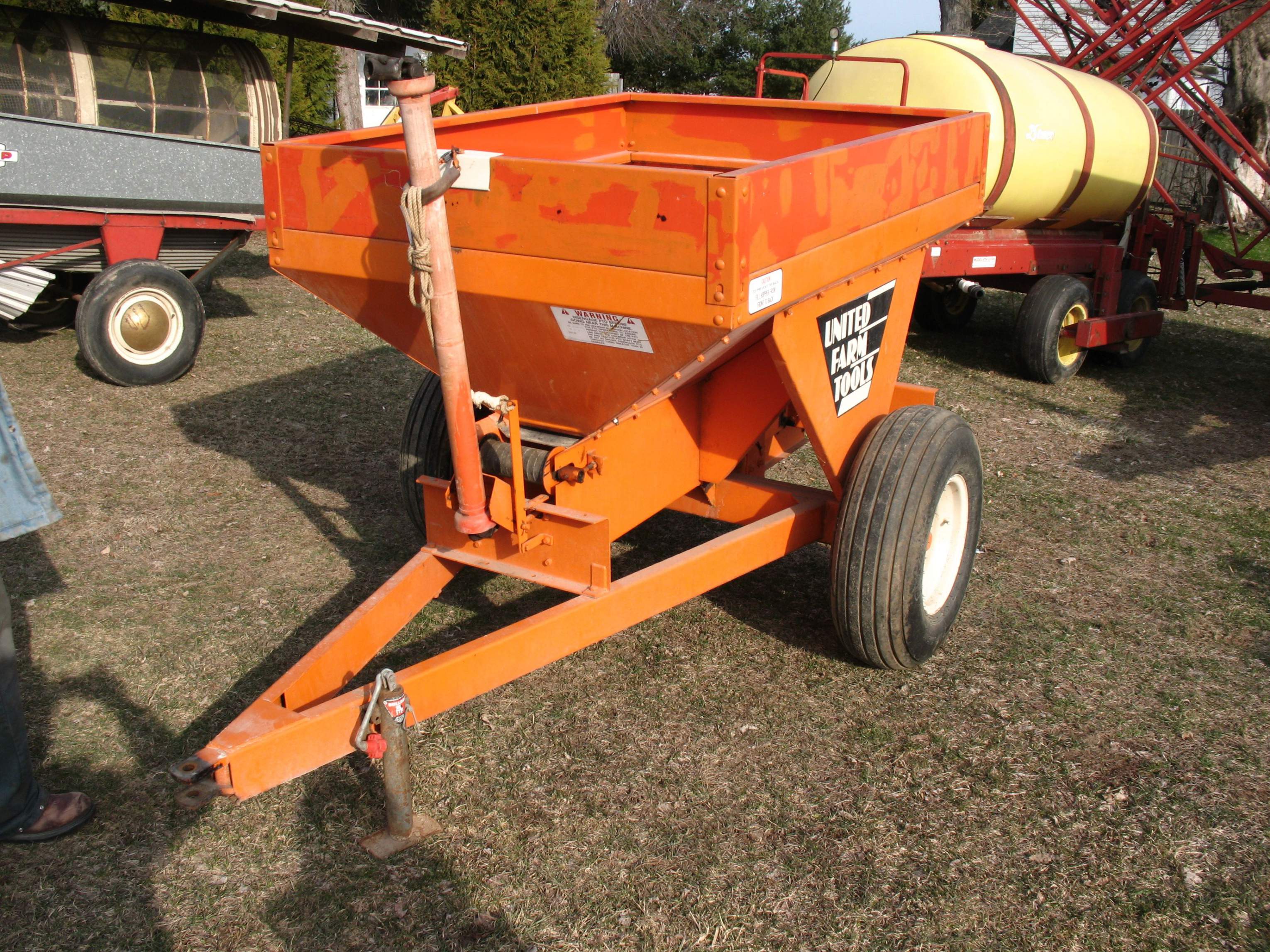

3 pt., or pull type for lime & fertilizer..?? If pull type, I have an older United Farm Tools 450 spreader like pictured below, although not in that good of shape. They hold about 2-3000 lbs. of material. Perfect behind my Super C's, 240, etc. I don't believe UFT is in business anymore, but there are used one's out there like this one.
Most are made for golf courses, so may try looking at some golf course equipment sites too, if this is something that would work for you..
