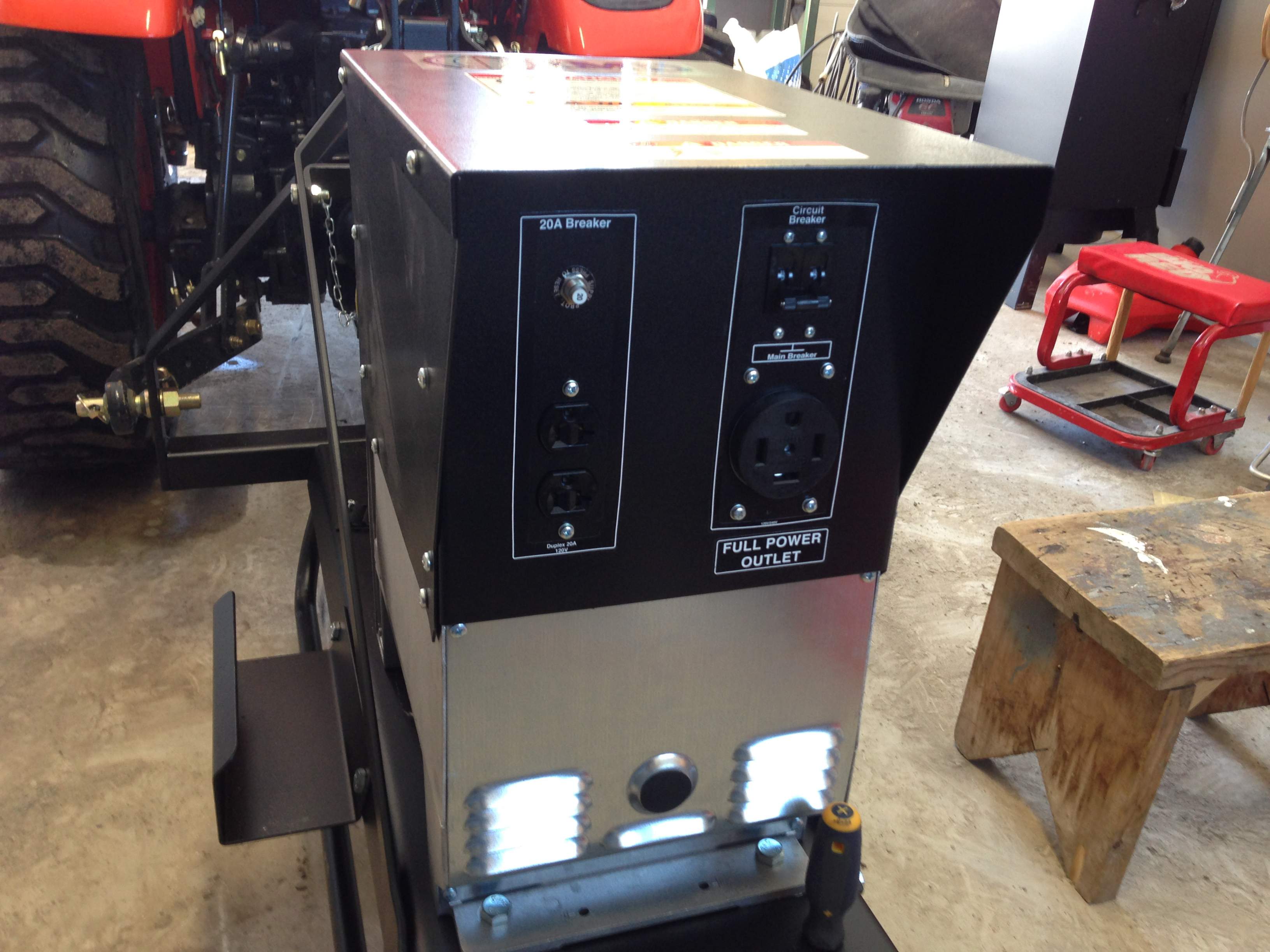

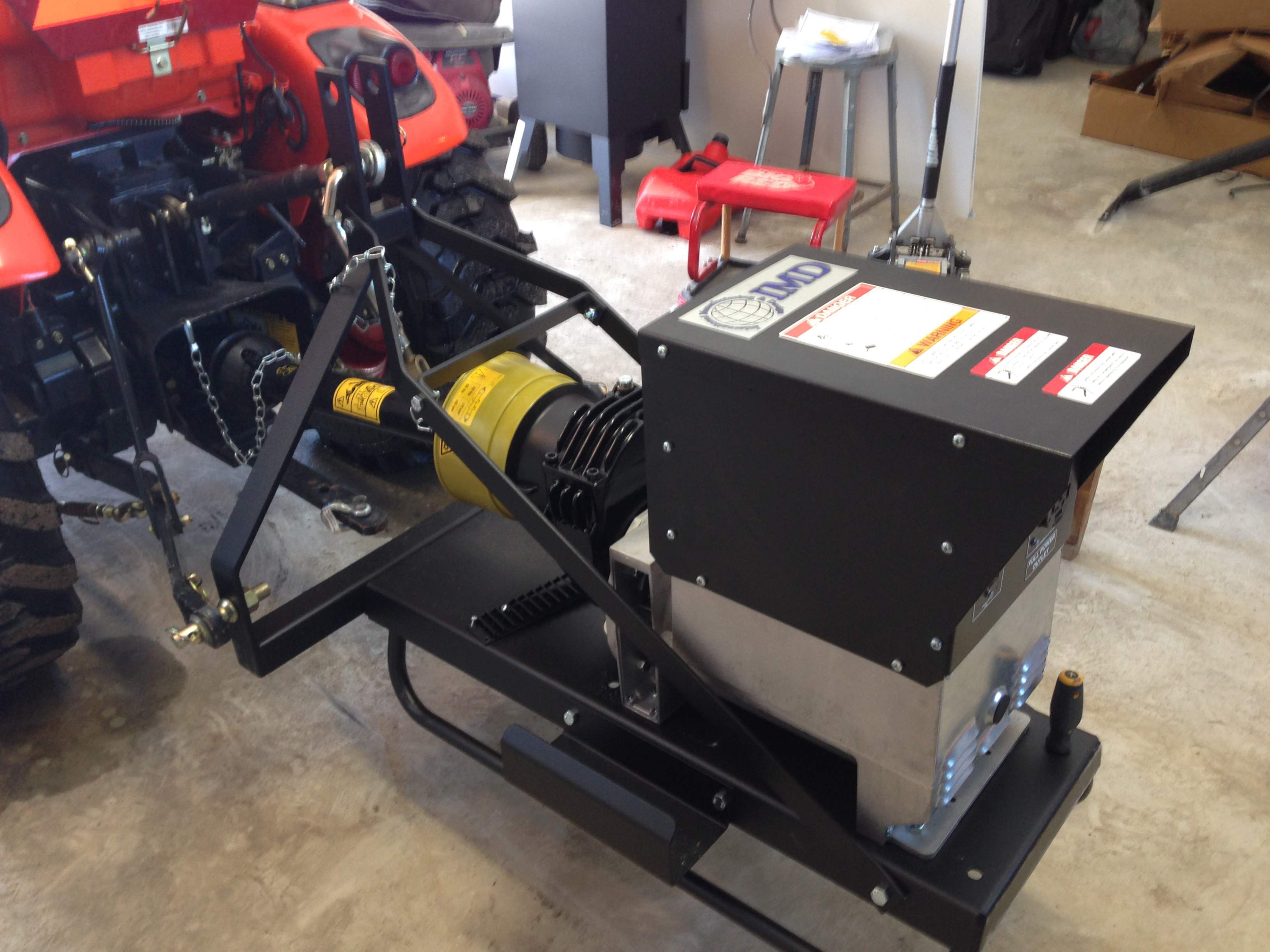

I ended up buying a 16kW PTO unit from IMD.
15kw.jpgIMD 16KW PTO Generator
I picked it up at their plant in Greer SC. Very nice company to deal with, and I'm very happy with the generator so far. I appreciate the advice from you all.

WW, did you set it up on a pallet, or a trailer...pic's????

The deal I got with IMD included a 3-pt hitch platform. It too is nicely built, with quality fasteners and good powder coating.

Great photos. Thanks for sharing.
