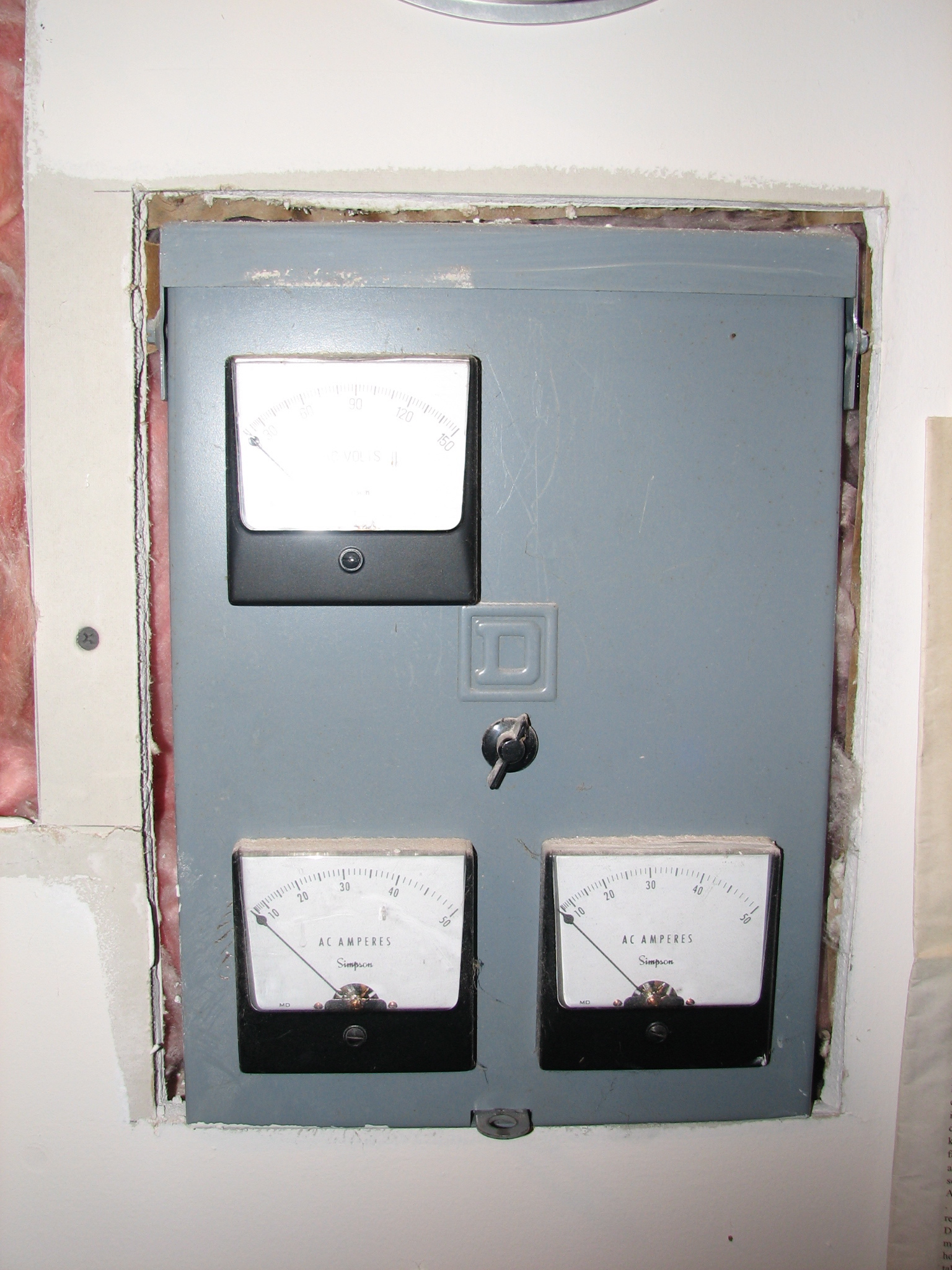

Thanks for the reply, checked them out, all I want is something that will read each leg in current draw and give it to me in amps.. I cannot find anything that will do it in amps...
Other than a good old wired amp meter..

Because I want something in the house , would like wireless so I don't have to run wires and have a permanent place.
Otherwise I have this in my shop.

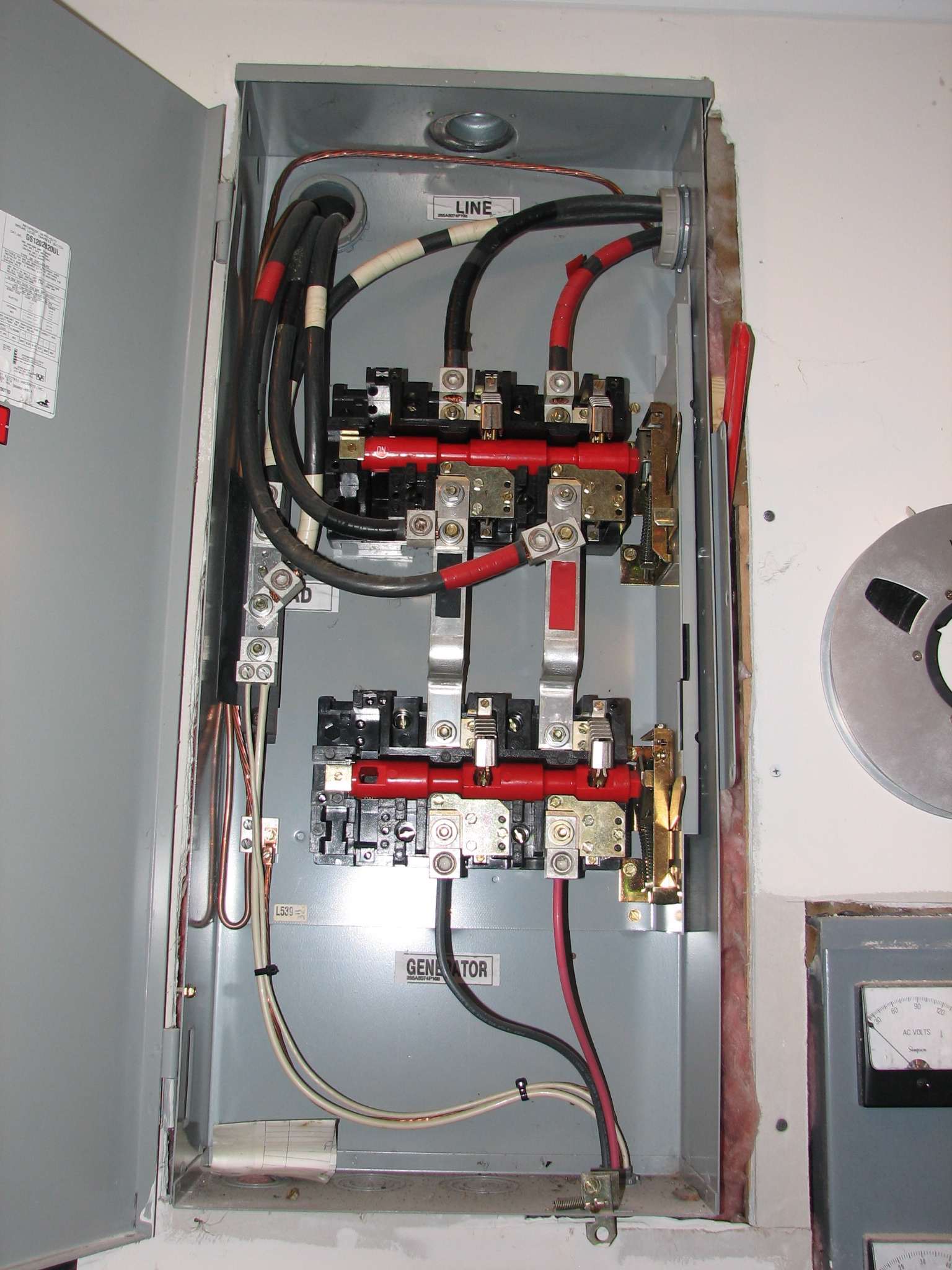

/ PTO Generator Question #139
What the heck is that tape reel just out of the picture???
