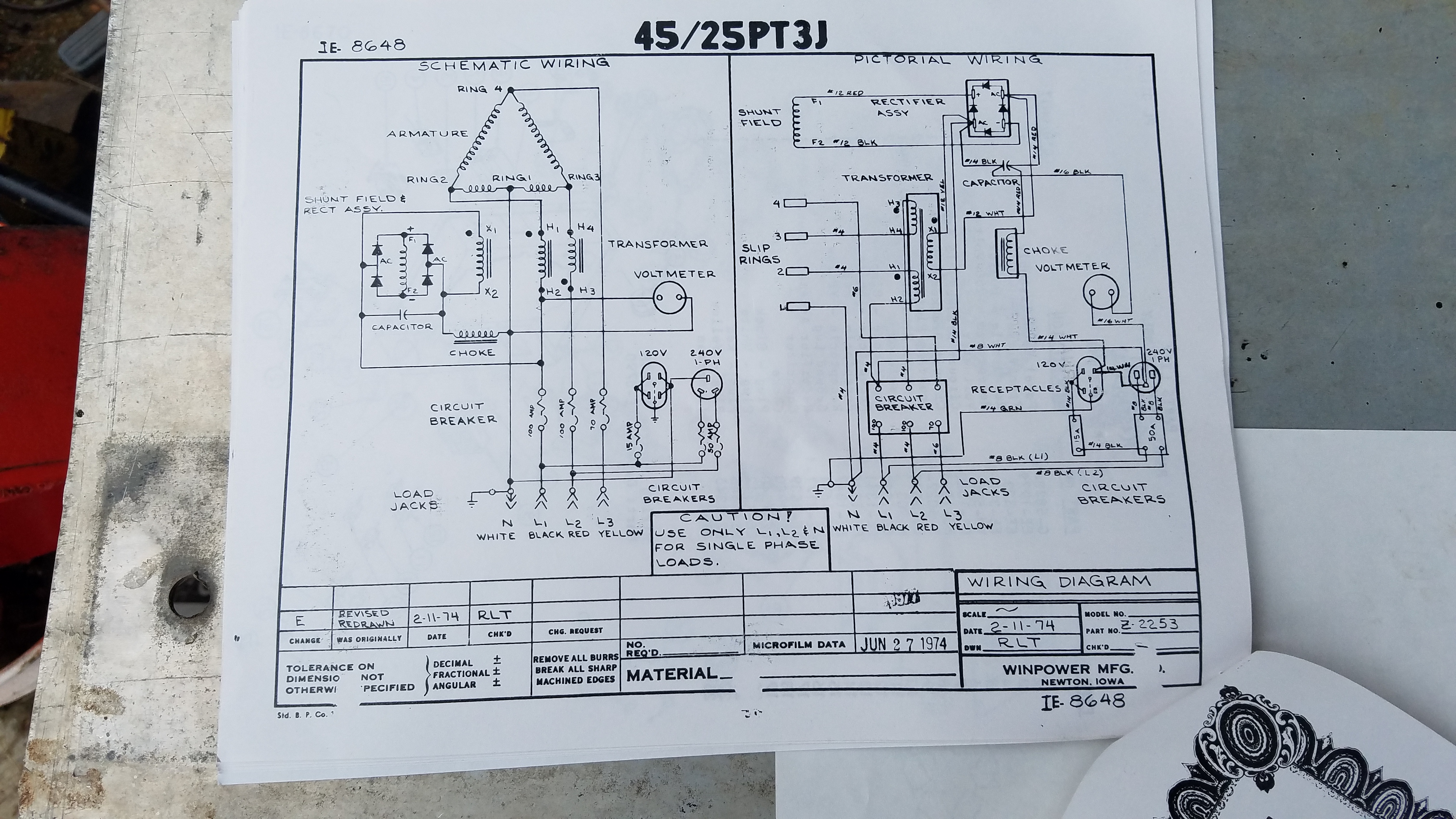

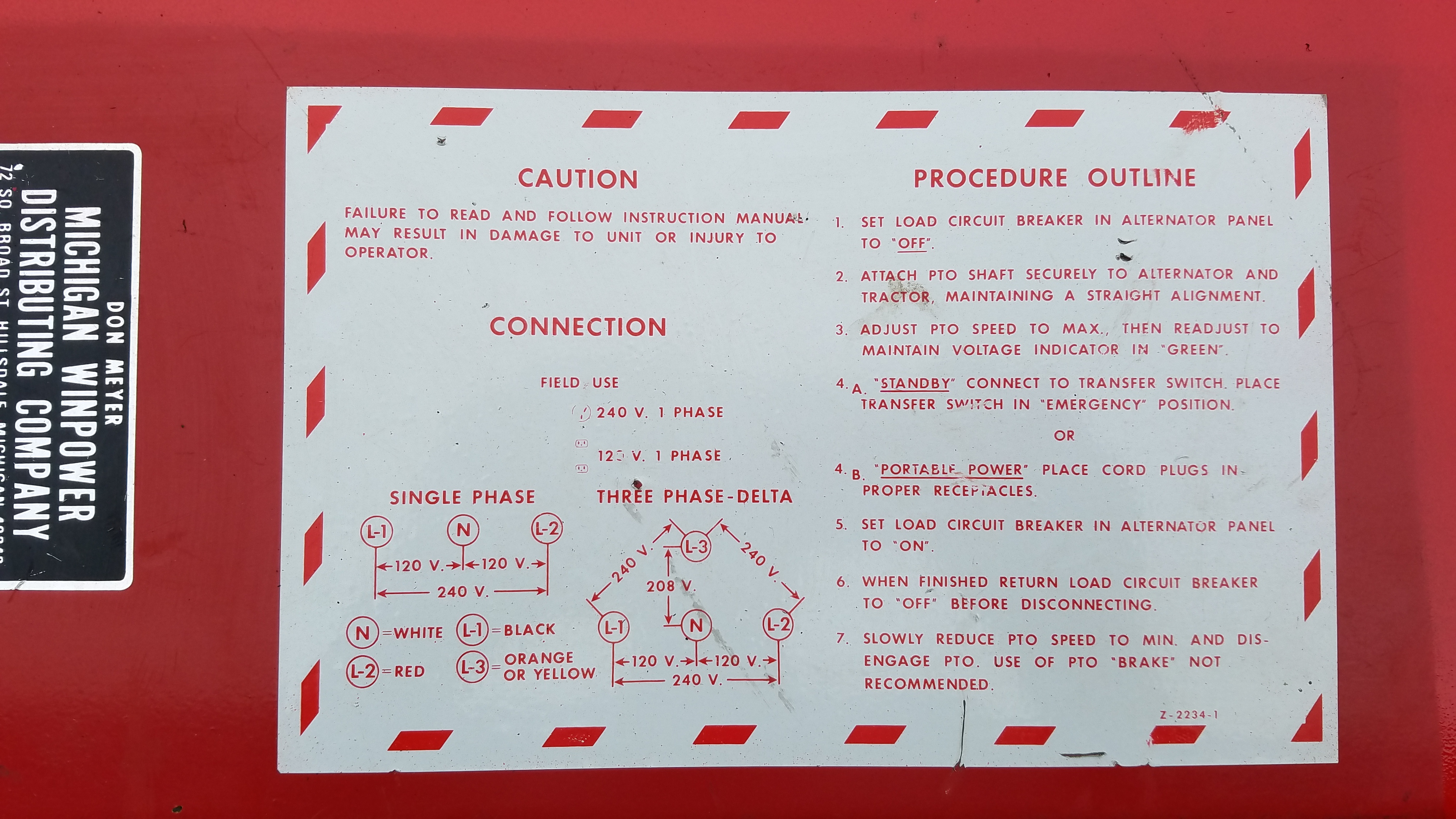

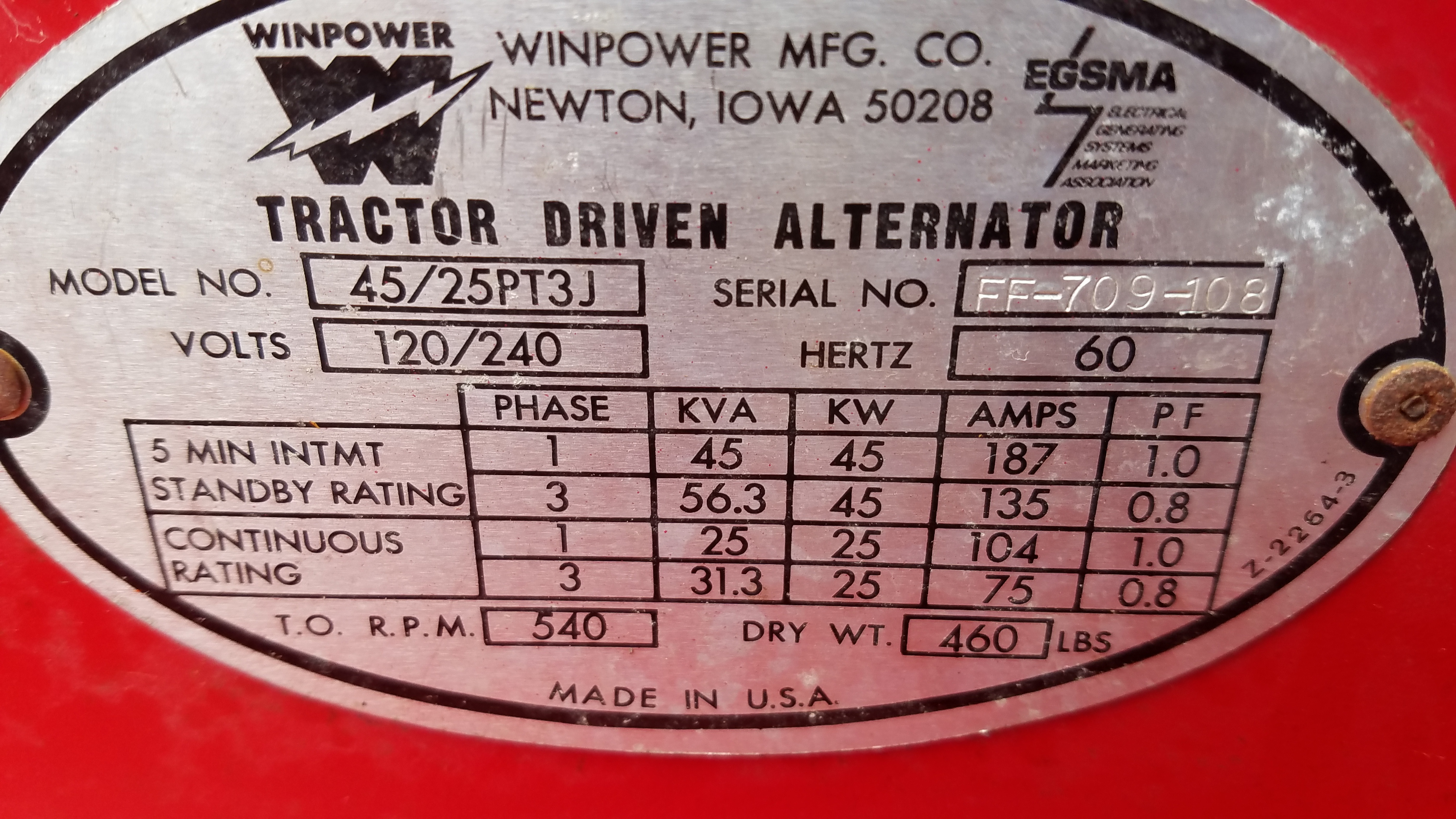

Just to add some color to the otherwise dry discussion. Here's the plate from my WinPower PTO Alternator and some other Big Science farm owner technology. 20190912_145647.jpg20190912_145708.jpg20190912_145830.jpg
