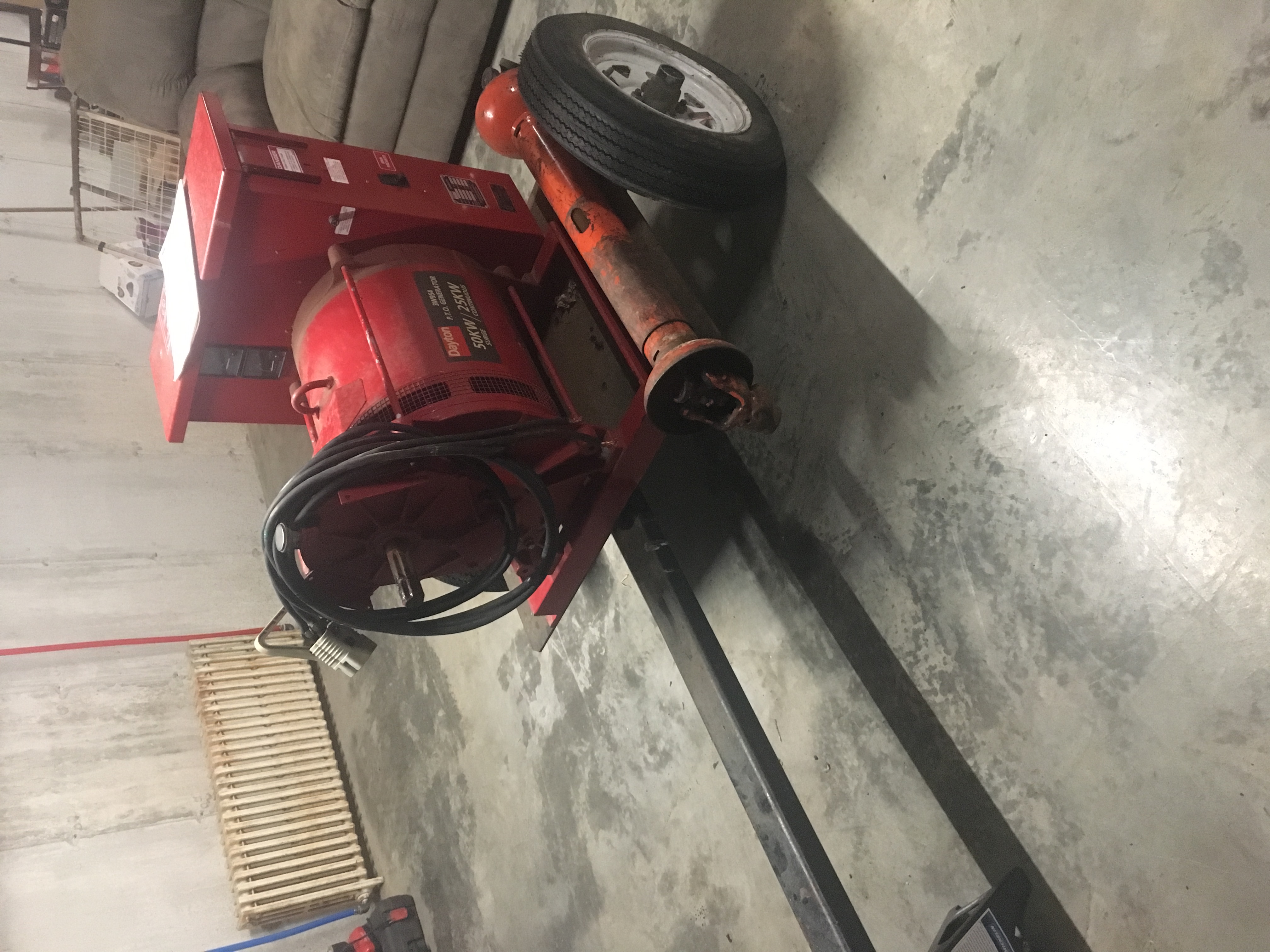

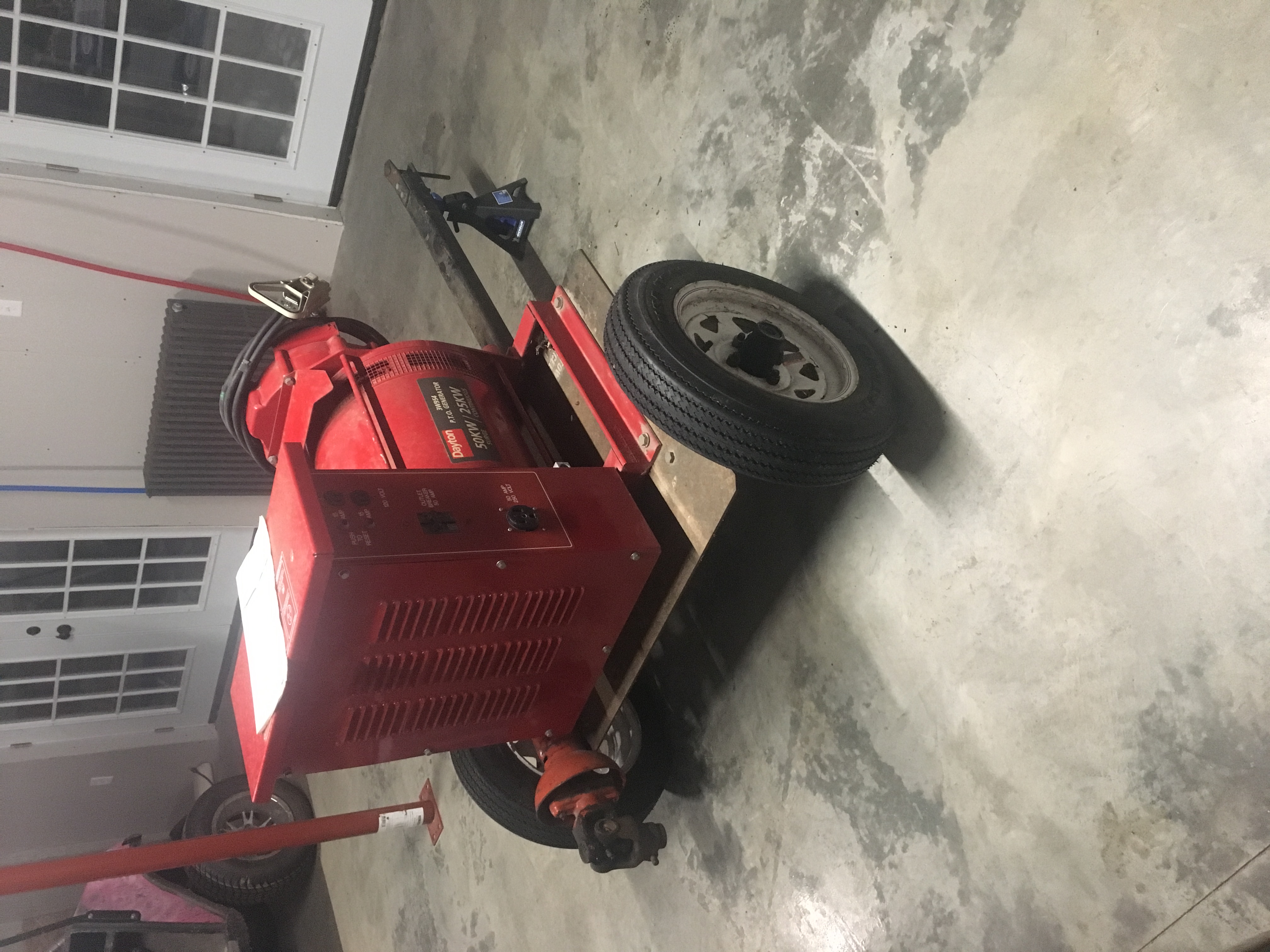

Here she is, paid 1500 for it. Surprisingly it is very quiet!

Absolutely that’s the plan! I will never need 25,000 Watts, if. I had everything on in my house I may tax out at 15,000 Watts, I can always turn my tractor up anyways, they are the same engine from the 35 hp up to the 55 hp. Manual calls for 45 hp FYI.
I can’t even buy the northern tool generator assembly alone for less than 1800 shipped to my house, this came with everything for 1,500 and it’s a 1800 RPM gen head. Good deal!
