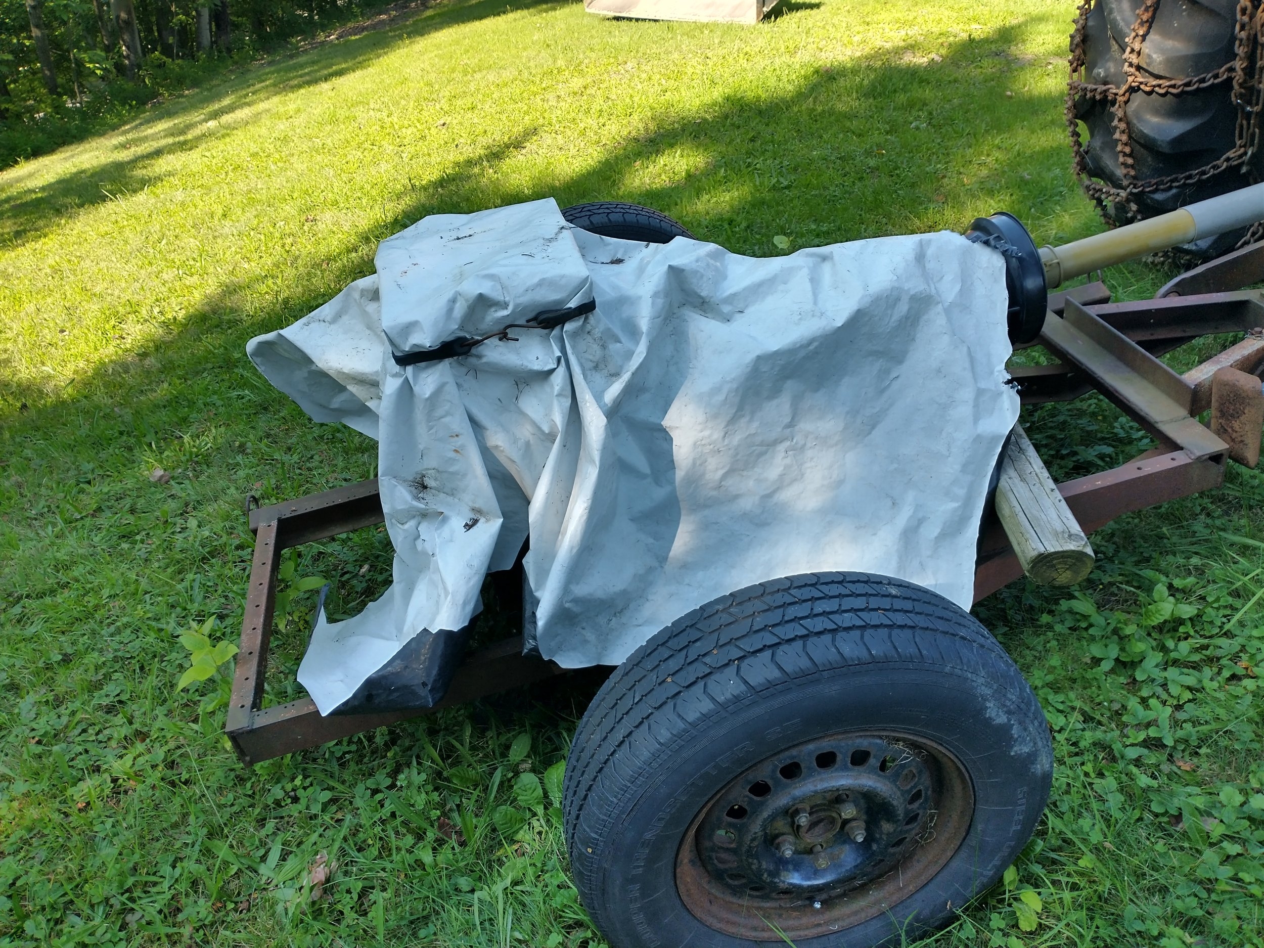

I store my WinCo in a shed with a standard nylon generator cover over it. I haven't needed to use the generator in inclement weather yet, but my thought is to stake a 4' x 6' tarp over the generator head and outlets (perpendicular to the pto shaft).

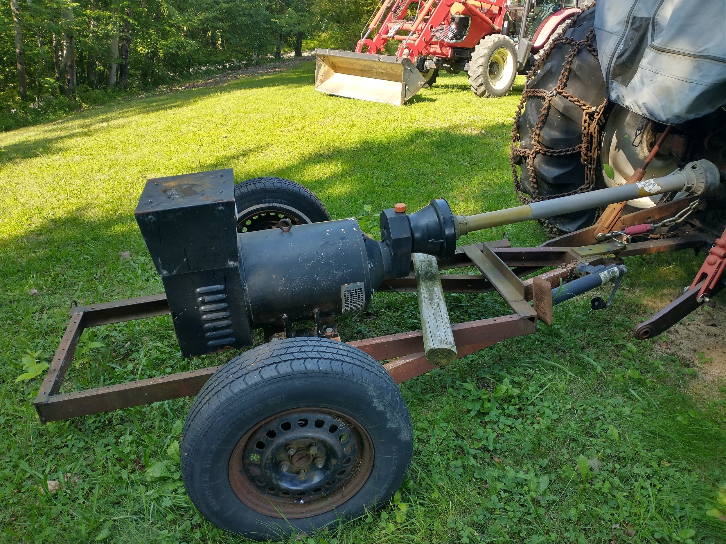

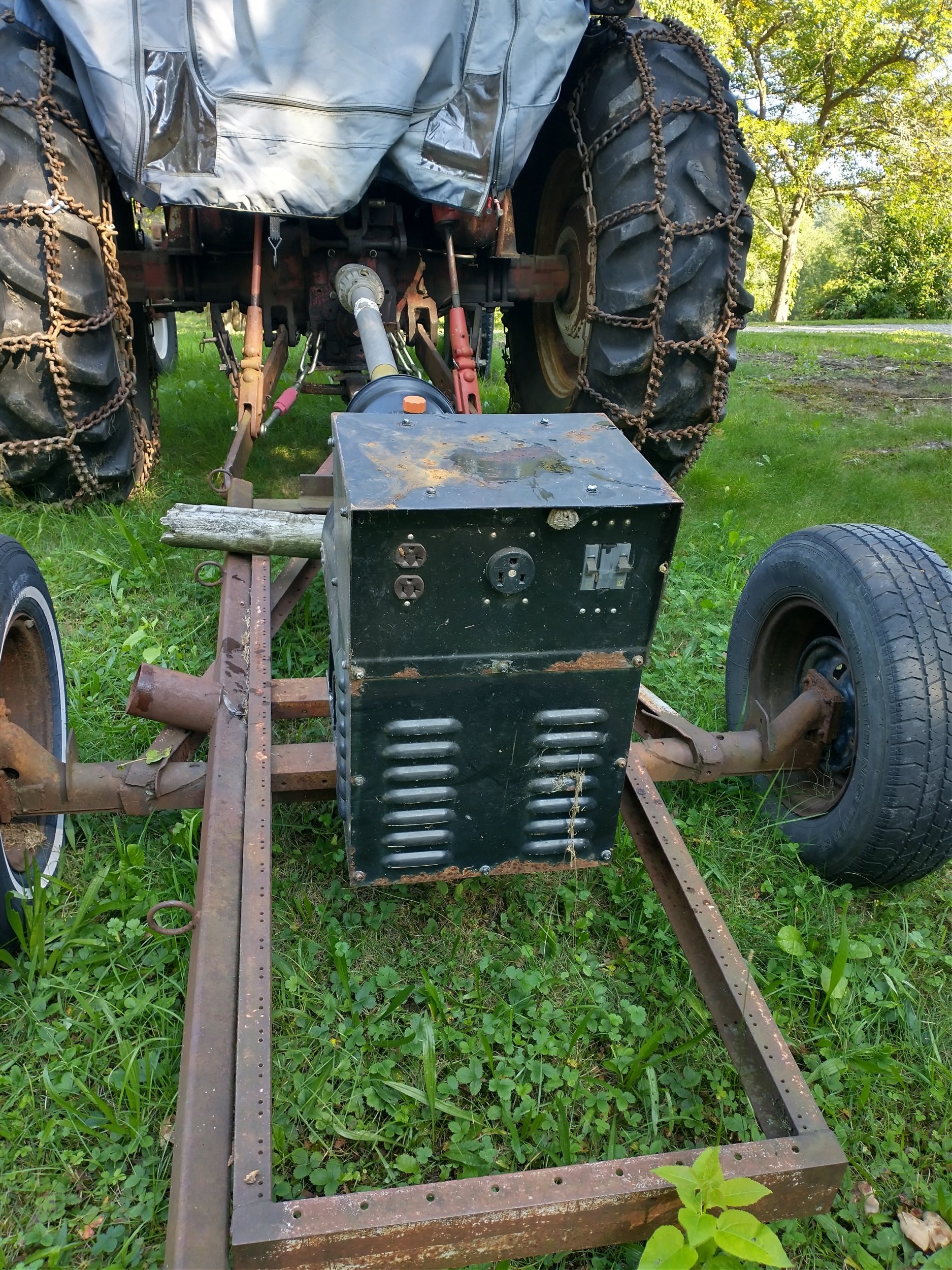

Well heck my old 25 KW unit sits on a trailer, out in the weather. This year I haven't even unhooked it from the tractor.
They are built to be weather resistant, I do have a piece of ag bag plastic covering mine. In the winter time I've been know to run it with the plastic still on.
She's well over 25 years old with several hundred hours on her.
It's had 5 or 6 week long or longer outages and lots of 1-3 day ones.

As I recall you are going to 3 point mount yours.
I prefer a trailer mount for a couple of reasons.
1) I can pull it anywheres with a pickup for someone else to use.
2) I have been know to just backup to the generator and hookup the pto,
and start using it, not even hooking the trailer to the drawbar.
Also I know of several that are on ground "platforms" that are just backed up too and pto's connected and run.

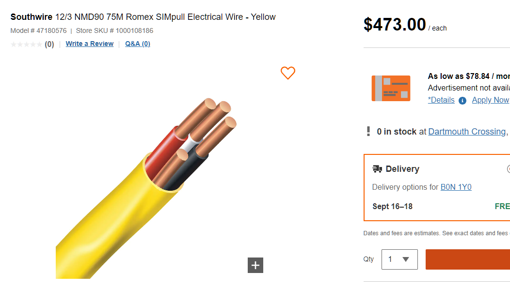

I will not purchase any electrical supplies from home depot.
HD price on a roll of 12/3 250ft $75 went to electrical supply
store $110 purchased 2 of the rolls for 500 ft
willy
   / PTO generator weather proofing #9
I wish $75, here's what our HD charges for a 250' roll, works out to USD $350

Just make sure your trailer or platform is wide enough. If it's not connected to the tractor, torque from a sudden heavy electrical load can cause the generator to flip over.
