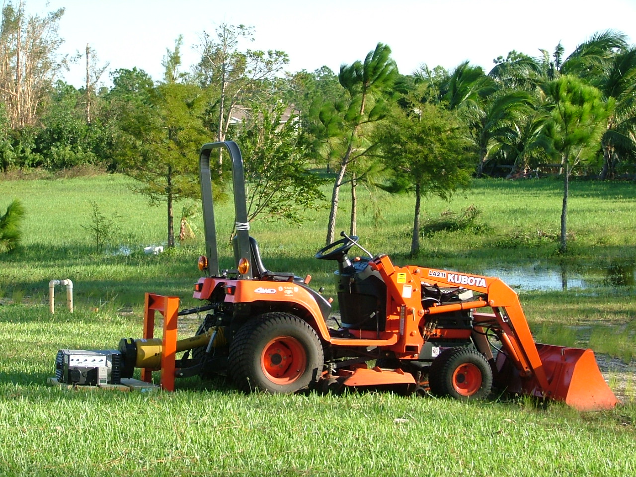

It's a Blue Seas Systems AC Digital Mutimeter. I've installed many of them on boats as well as lots of other Blue Seas products and I knew I wanted one for my gen; it will display volts, amps, frequency, and watts for each of the two legs (you need to use the switch from this panel to switch between the two legs and show both legs at the same time...can't use a double throw switch). Plus it makes it really easy when it's dark and rainy (which is the case 100% when we loose power) to see the frequency as I adjust the throttle.
16valex said:
How do adjust the frequency? Do you mean by adjusting the RPM of the engine the frequency changes?
Yes, you adjust the frequency with the throttle and then the injection pump governor tries to maintain that RPM (whatever gives you 540RPM at the PTO) even as the load changes but sometimes you need to bump the throttle up or down as load changes dramatically because the governor can't keep up. I usually start at 63Hz no load then start loading up the gen which brings the freq pretty close to 60Hz which is your target. I also keep a small digital multimeter (Fluke 111) plugged into an outlet in the house to see if there are any huge fluctuations. You can see incandescent lights get brighter and dimmer as the voltage changes. On this unit the voltage and frequency seem to be linear...so as freq drops so does voltage (courtesy of the simplistic voltage regulator). So, I can also tell if the frequency is off by the brightness of the lights. Remember, the 60Hz frequency is critical for motors (refer, water pump, heater blower, etc...).\

A freq counter or VOM with a freq function should be available at most supply stores that sell meters.
freq will be a direct relation to your pto rpm.. IE.. run the genny at exactly the rpm it wants.. and thet is when yuo will gett he correct freq. Let oyur governor throttle up for power if the load goes up.. That's the benefit of having more tractor than needed. A 12 kw genny on a 24 pto hp tractor works fine on paper. However, in practice.. a 12kw genny on.. say? a 40-50+ pto hp tractor works better... more reserve torque and hp so that rpm doesn't drop while waiting for gov'ner to pump engine up during high loads... more rotational mass int he engine helps this as well. And.. as long as your engine is running pretty good, you won't burn that much more fuel than you need based on pto load.. etc... so having the larger tractor run is not a huge waste of fuel.. etc.

I spoke too soon:mad: . Lost power last night about 7 pm, ran the old girl till 5 am.
Maybe someone can guide me here, under certain circumstances, the pto gen won't power the well pump (3/4 hp). Last night we lost water, went down and lifted the lever to bring the pressure up and it kept cutting out (internal circuit breaker?).
Went out and checked the gen, meter was reading 230 v or so, so I idled back a hair and it seemed to be fine. Not sure if an a/c was running and caused the pump to kick out or my adjustment fixed it. I know that hz? must be off slightly, as my UPS for the 'puter won't work when powered by the gen, it detects a voltage/hz problem so we don't use it while on gen. All the other electronics are fine, and my outlets read 110-120 depending on load. How do I check hz and where do I get a meter if that's what I need?
   / PTO generator who has one?? #29
the easiest way to check hz is to find an old plug-in dial type alarm clock; it's the utility regulated hz that keeps them phenominally accurate. So plug the clock into the generator and synchronize the second hand with your watch's, and let it run for an hour. Check the times and you'll know about either too high or too low, and by how much.
