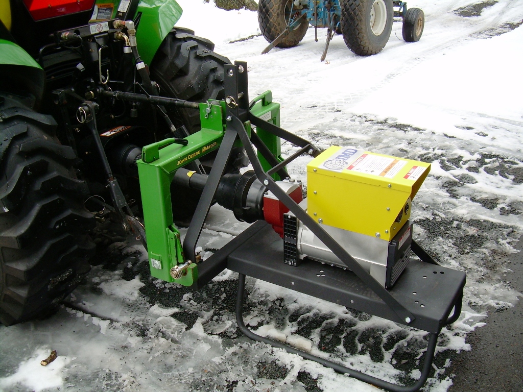

I think we only need about a 12kw pto generator but have a larger tractor(105 kubota)Is it necessary to crank the diesel all the way up to turn the pto at 540.With that much HP wouldn't I waste fuel plus wear at higher engine RPM?Is there a way to run the engine at about 1800 & still generate 12KW?
/ pto generator #47
You can Gen 12KW at a slower speed it just won't be 60 Hz which will cause all kinds of problems to motors and other frequency sensitive equip.
If the gen to designed to run at 540 to produce 60 Hz current then you MUST run it at 540 no matter what the load (kw).

As another poster said.. you need to run the pto gen at the rated pto speed for it to make the correct frequency power.
Your machine is made to run at it's rated pto rpm
Waste fuel? For the most part, fuel usage is based on load.
For instance.. I have a 70hp and a 95hp diesel tractor.. I have cut my pasture with both of them using a 10' mower.. the 70hp tractor uses 5g of diesels to cut the pasture. Guess what.. so does the 95 hp tractor! What does that tell us? It tells us that just because a tractor can make 'X' power doesn't mean it always is.. fuel is used based on the power requirement of the job. You may geat small differences based on machine size and weight if one machine weighs alot mor ethan another as that will be 'overhead'.. but the actual fuel consumed to power generated ratio should be pretty close.

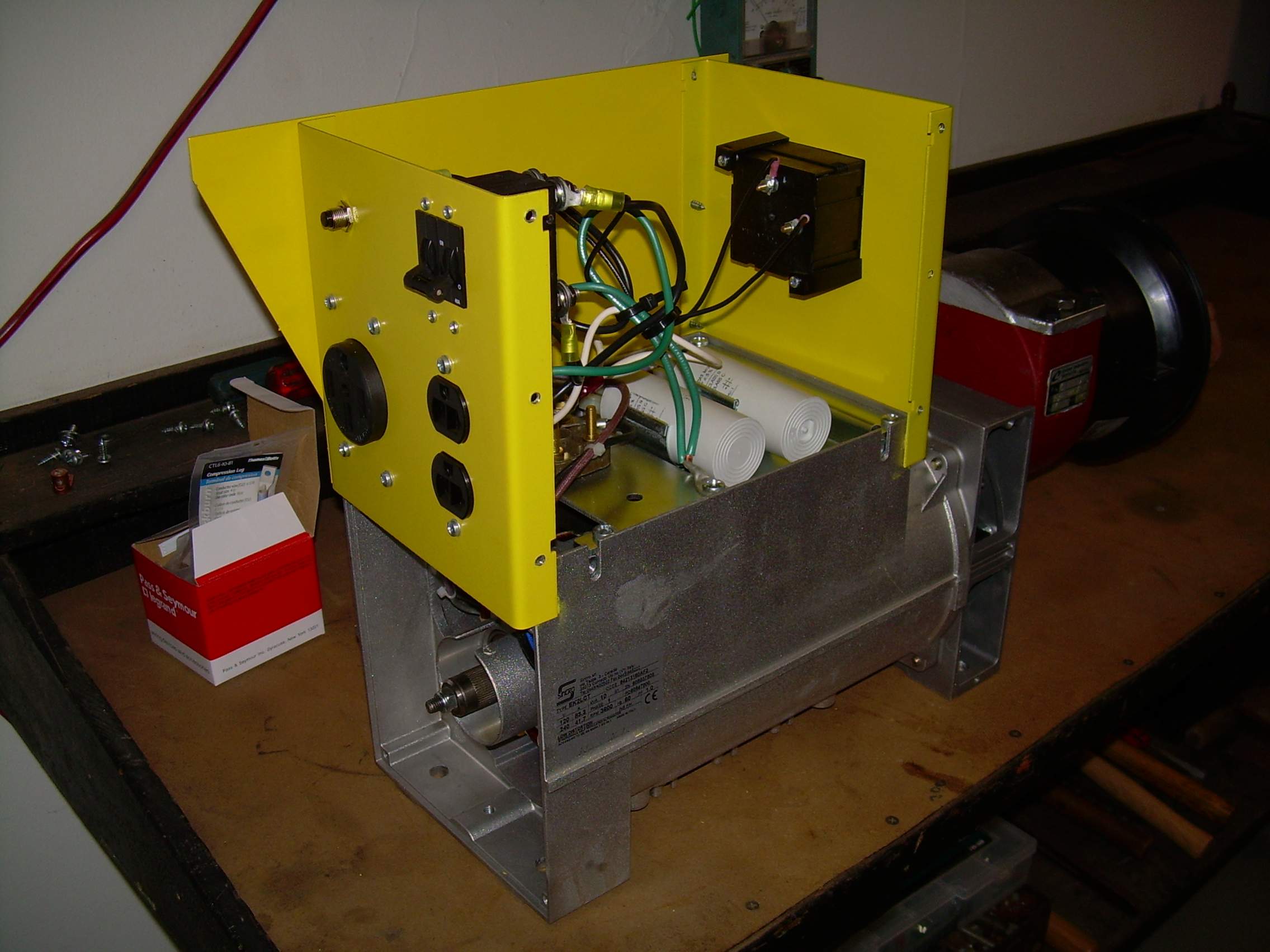

ever look at the head on a pto gen.. then the head on a portable.. now think about how the big boys make power. it's all pretty much coaxing electrons off a ball of copper.
that ptogenset or portable will be cleaner power than from MOST DC inverters.
as long as you can keep rpm governed, you should be good to go. keeping the rpm governed will be a function of load, hp, rotational mass and the capabilities of the governor and engine.

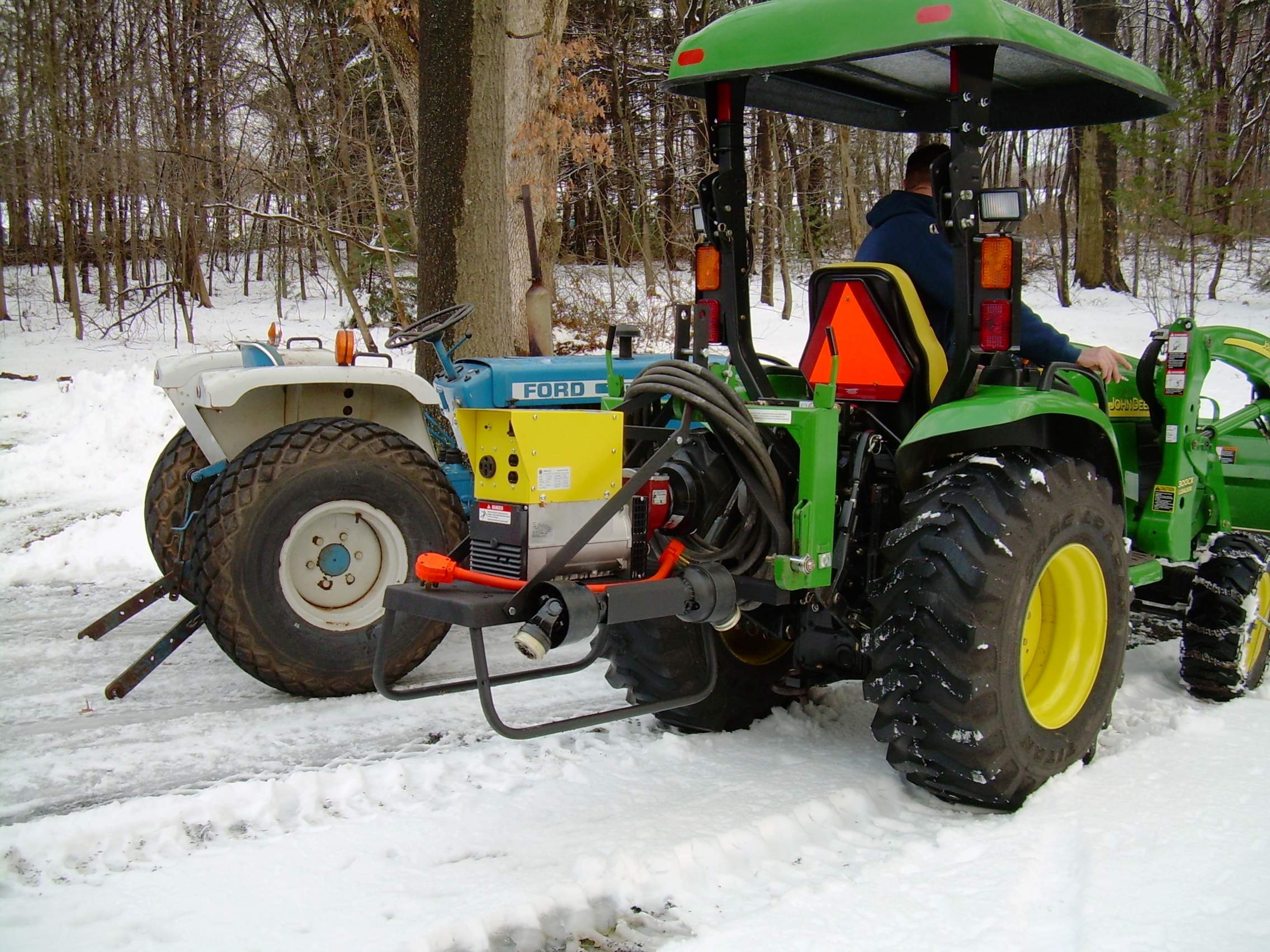

I have a 35hp tractor and a 50kw Winpower alternator. I even run A/C as necessary. It has 540 rpm pto input and I've bought a photo tachometer to check the rpm and a frequency meter to cross check it.
That being said, I then bought a reducer gearbox from Central Georgia Generator for $299 that I connect to my 1500 rpm 3 cyl diesel lawn mower's pto (which normally runs a mower deck). The gearbox has a standard farm type splined pto output shaft which I connect the Winpower too. I set the F935's throttle to produce 60Hz. at the 115v electrical plug and I am in business. This frees up the tractor for clearing the giant sized hailstones, downed windmills, overturned minicars, lost city folks, smashed pumpkins, snowflake collectons, and those pesky trash containers that get balled up in the tinsel and barbed wire residue. I'm sure you city folks are lost at this point.
THe F935 has 2 6 gal fuel tanks, while the tractor only has a 10 gallon tank, so I'm way ahead on lighted bathroom reading and comfort time with the mower conversion deal. All I need to do is put the bolt-on bracket with the gearbox onto the left front mower lift arm, swap the pto shaft to the gearbox input and hook on the alternator (which is rigged with a hitch and trailer axle). Then its just a matter of locating the 220v extension cord. This can be touchy when its pitch black dark outside, the full moon is a week or 2 late, and the raindrops are so big they can hurt you.
Plus, now I can take the welder, Power Painter and electric pressure washer on field trips that all you stationary guys only can dream about.

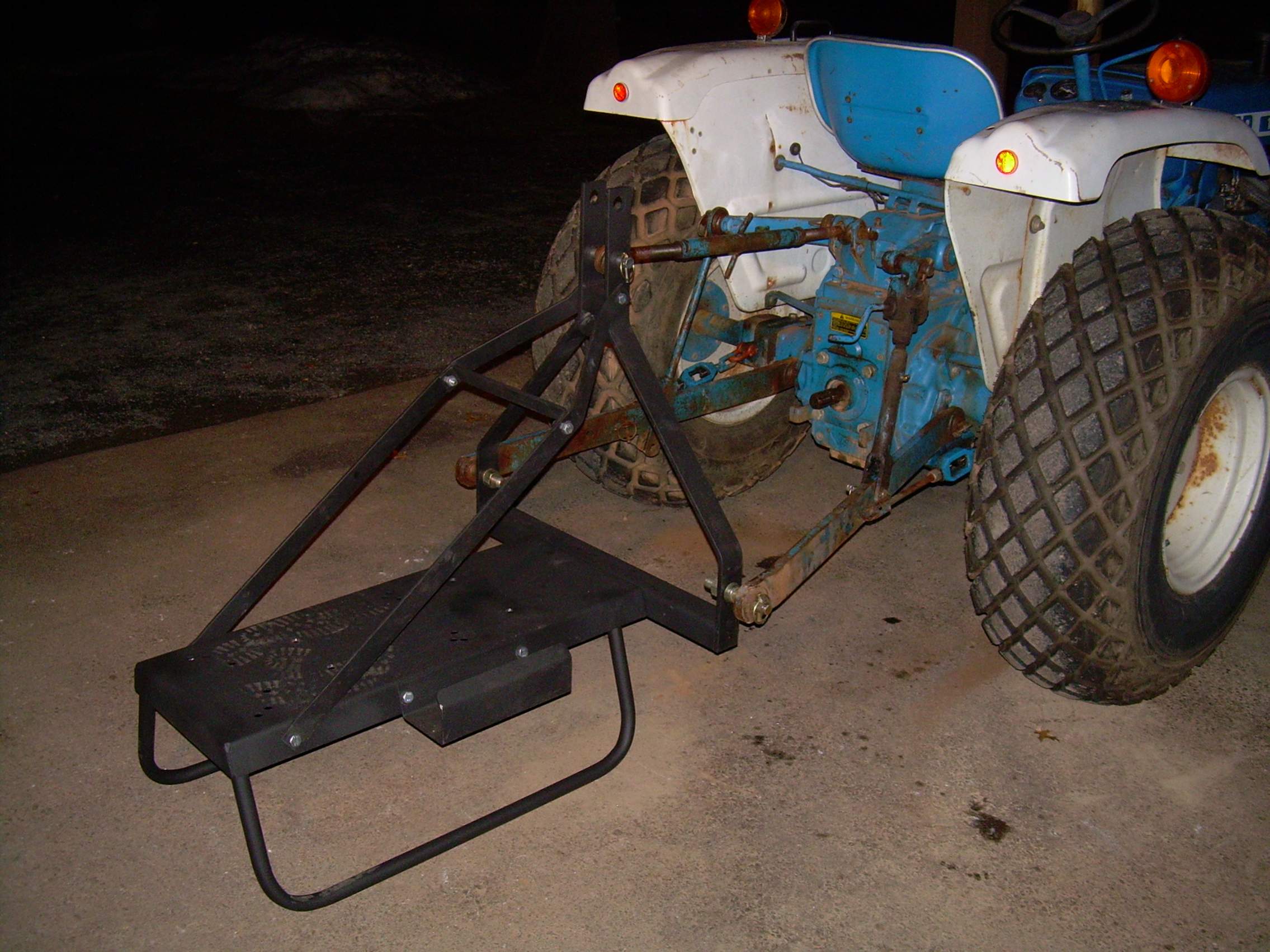

that's one thing I like about my pto genset. i put it on a 3pt caryall platform that has enough space to set my hobart ac buzzbox on.. :)
