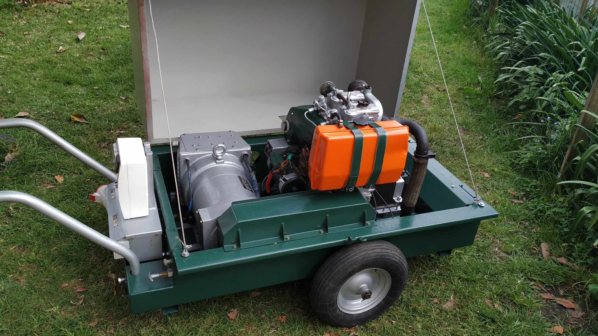

Interesting. My 10kW Leroy Somer 2 pole 3 phase generator spins at 3000 RPM for 50Hz and it's powered by a 25HP Slanzi DVA1030 Air cooled diesel engine that spins at 2500 RPM.
The diesel engine doesn't necessarily needs to spin at the same speed the generator needs to spin.
Your 2 pole genny MUST spin at 3000 rpm to produce 50 htz.
Your prime mover can of course be geared to operate at a different speed.
   / PTO Generator inadequate for larger HP motors? #60
Of course it can. That's the entire point. The guy was claiming that only gas engines would run 2 pole generator heads, which is obviously false. Not only they can speed up the diesel engine RPM via gears or pulleys and belts, they also make plenty of diesel engines that can work at 3000/3600 RPM all day long, they're just noisier for the most part.
Mine is belt driven and since I don't actually need the 10kW, I got a bigger pulley for the engine and I'm now running the engine at around 1800 RPM. Plenty of power for a 3HP well pump and one of those small 50 liter air compressor. Way less noise and fuel consumption this way.
