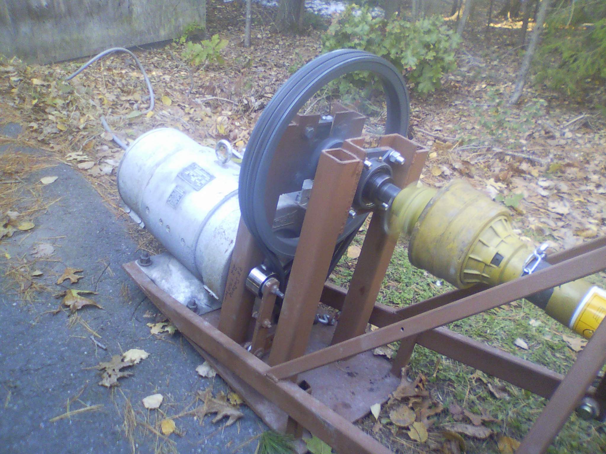

1104111448.jpgI put this together just before the October New England storm. The tractor was run in high pto speed to cut down on the tractor rpm. When I built it I measured the circumference of the pulleys to calculate the needed diameters of the pulleys to get the correct 540 rpm to the generator speed of 1800 rpm. It is a 7kw onan generator. We did not use anywhere need full output and checked the voltage often. Once set the rpm/voltage was very constant. We ran it 16 hours a day for 7 days.

View attachment 272556I put this together just before the October New England storm. The tractor was run in high pto speed to cut down on the tractor rpm. When I built it I measured the circumference of the pulleys to calculate the needed diameters of the pulleys to get the correct 540 rpm to the generator speed of 1800 rpm. It is a 7kw onan generator. We did not use anywhere need full output and checked the voltage often. Once set the rpm/voltage was very constant. We ran it 16 hours a day for 7 days.
Great Job! If I could just snap my fingers and one would appear it would be alot like that. The only thing is I think I could get by with a much smaller generator.
