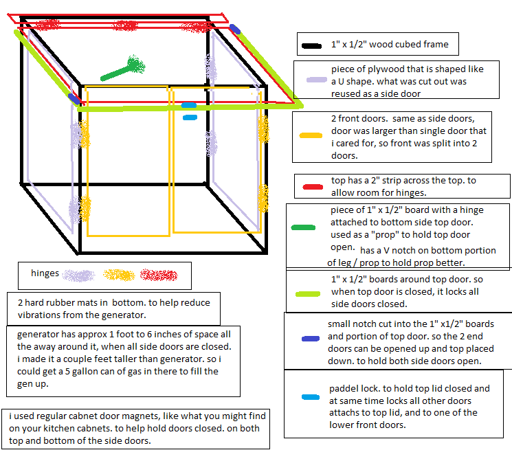

converting a gas gen to a PTO gen is above my head. with that said perhaps a different direction.
most of the cheaper generators out there are fairly loud. honda portable generators 5 or so years ago was the quietest gen out there. and going to assume still are. due to full side panels, top panel and under panel, and sound / vibration insulation within the panels. most other generators, just have the engine and muffler right there out in the open, allowing sound to go every were.
also doing a different muffler / larger muffler can help reduce noise.
the 3k watt honda i have, sets right out the front door of a cabin, and you can barely hear the gen out side, even with windows and door open.
if you are half way handy, you could build a box for generators to set in. even go as far as build the box on a pallet, and put generator inside. and have it as a lock box just for generator and easy to move with pallet forks.
you can buy sound proofing material, and just use a stapler, or some sort of silicon or adhesive and place all around on the inside of the box, to help reduce noise.
i do not have pictures on hand. but hopefully below diagram might help. of what i did, for a box to hold generator. to mainly keep mice, bugs, snow, ice, rain, sun from directly getting to generator. but it also helps quite the generator down more. when only 2 side end doors are open. i just have never needed to put in sound damping material / insulation due to how quiet things are already. but could easily, if need be.
