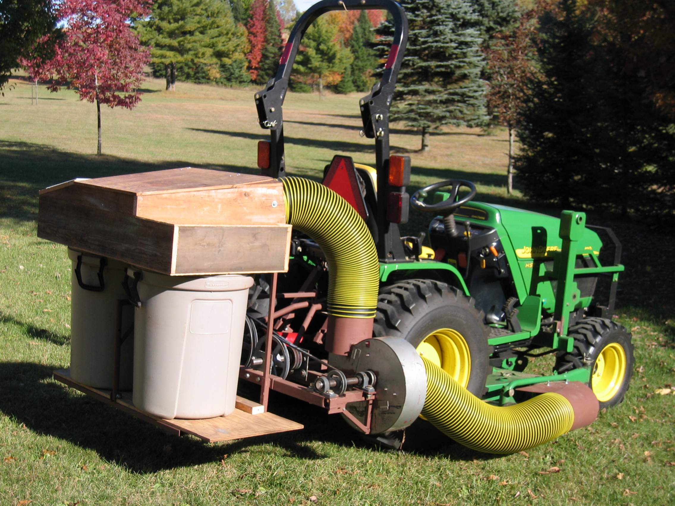

Had the trailer model... Didn't like the way it moved around obstructions. I only use a vacuum in fall for the pine needles that blanket the lawn. I built this PTO version which works great and costs only 150.00 for parts. Why someone would spend thousands for the same result baffles me. A larger storage container would probably be the only improvement but it cuts the needles so fine they pack quite well. The containers are heavy but easily managed to dump in a trailer or waste area. A fun project with great results, well worth the time.
Good job! $150 in parts says you were extremely lucky.
Different strokes for different folks, I guess. It baffles me that anyone would spend hours collecting parts then building such a thing when they could buy one ready-made and spend that time on something enjoyable. :)
That would be the difference. While you thought it was fun and worthwhile, I'd think it was neither.
