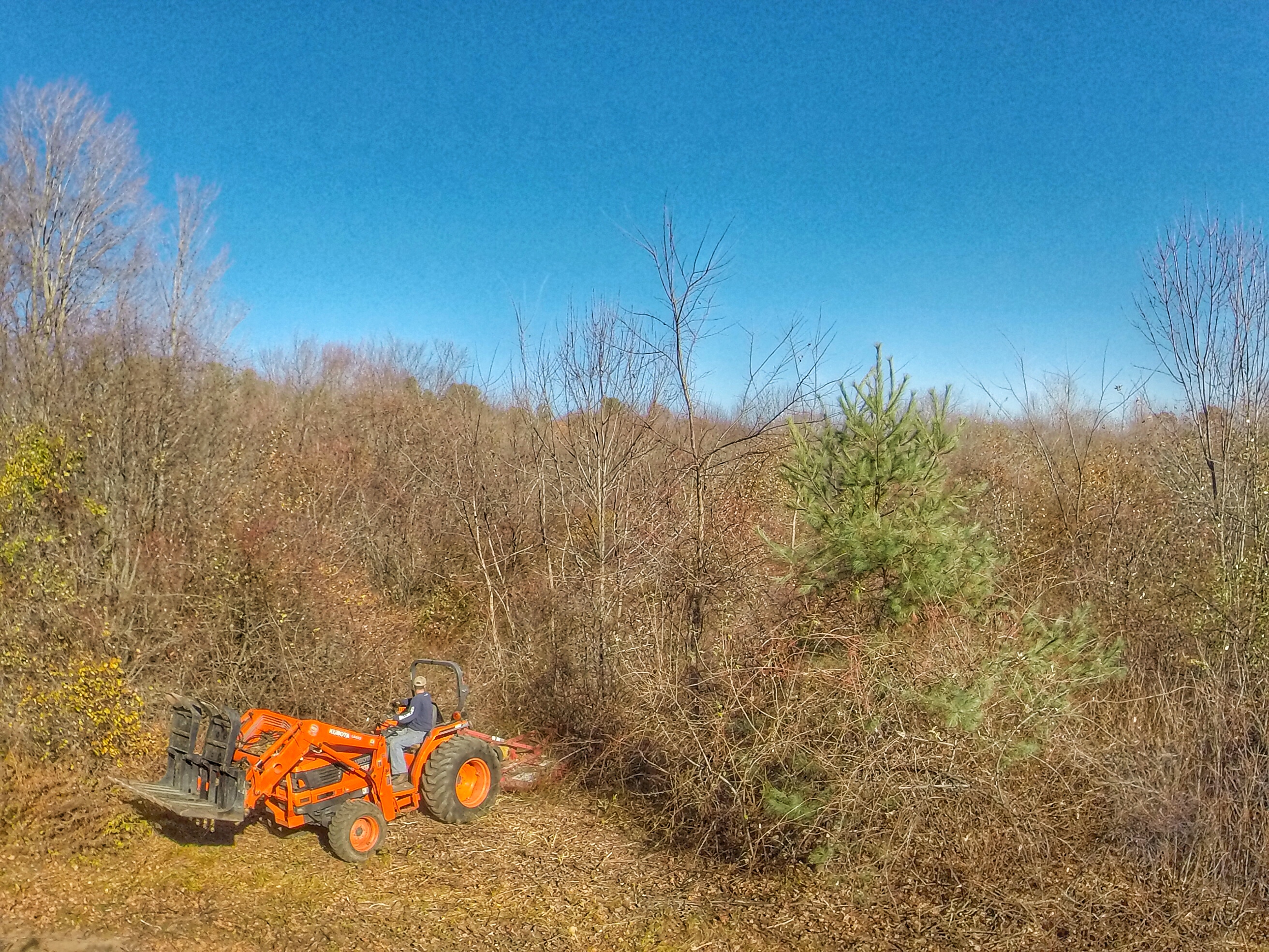

Here is a quick time lapse video of an 'overgrown' field that I cleared. Kubota Tractor Reclaiming Fields With Brown 472 Rotary Cutter - YouTube
And a photo for fun...

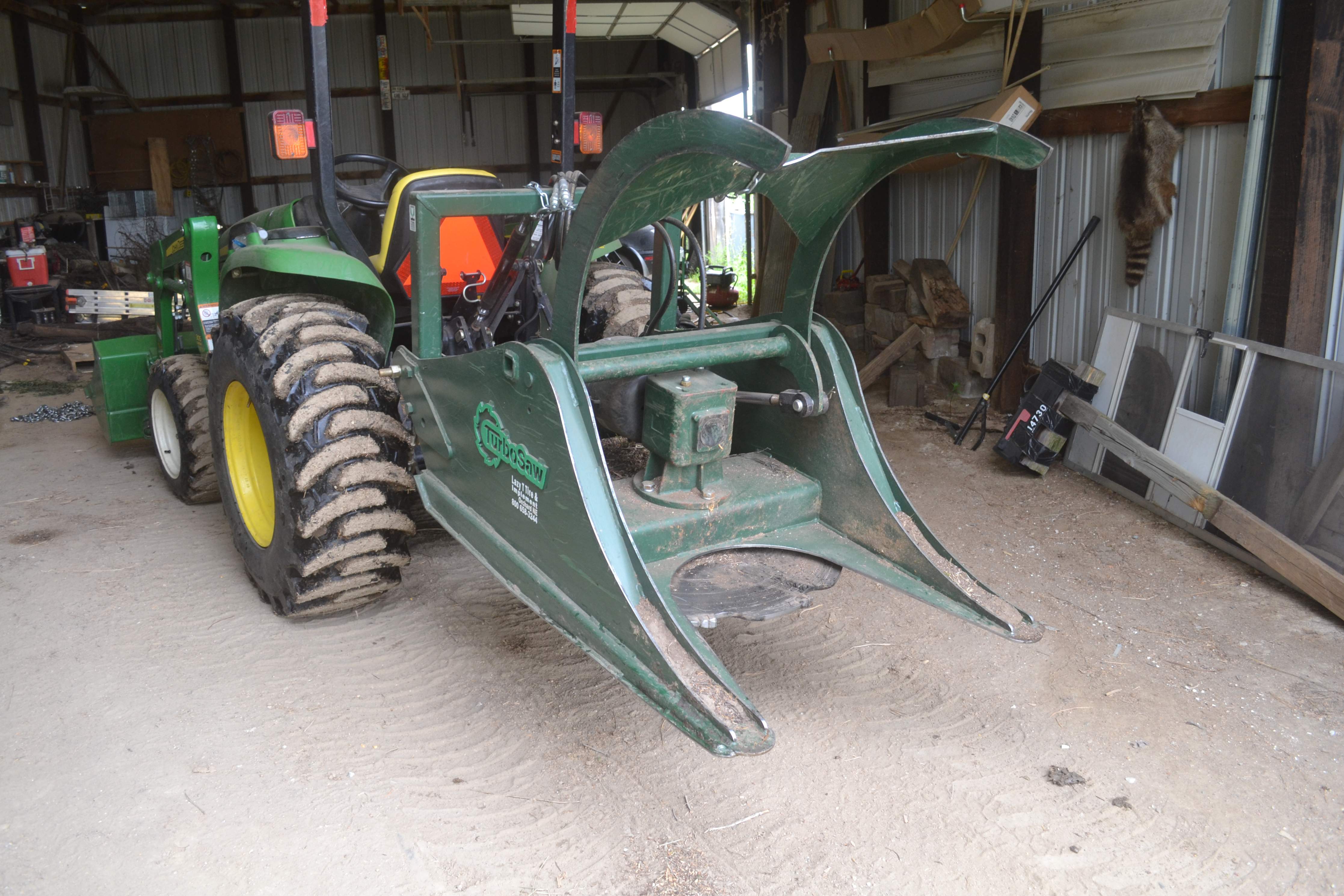

Sorry to reply to my own thread, but was looking at the Brown site, and see something called a "tree cutter" that looks perfect for my use. Even setup to back into the work with spring loaded pushers. It's not cheap though, anyone ever use one of them? Wonder why it's so much more $$ than their heavy duty brush hogs?
The tree cutter's are incredible, and also very dedicated pieces of equipment. I'd love to have one, but my tractor is not big/powerful enough. They are incredibly tough, heavy, and very capable. Check some of the youtube videos of them behind a john deere 5065 which is pretty similar to your PTO hp. It's a lot of mower for your tractor.
What I was originally recommending as a possible 'ultimate' clearing setup for your tractor, is not the Brown Tree Cutter, but the Brown Tree SAW. TSG-2 Tree Saw with Grapple | Brown Manufacturing | 8.633.899
(This is a photo of member "My Gym" Daugherty Turbo Saw. The Brown unit comes with a safety screen.)
The tree saw on the 3 point hitch, and the grapple on the front end loader, would make quick work of taking down the trees and piling them up. The nice thing about the Tree Saw (as opposed to the Tree Cutter) is you can cut the trees flush with the ground (or even slightly below ground level) and it can be used on a much smaller tractor. In addition, you can cut considerably larger trees in a single pass. The problem will be that you are left with stumps, but this will be no different than if you had a mulcher as well.
You have the advantage of having an HST transmission, which makes using any one of these implements many times more efficient.
Do you have any pictures of the land you want to clear? How many acres are you trying to clear? Is it level? Rocky?

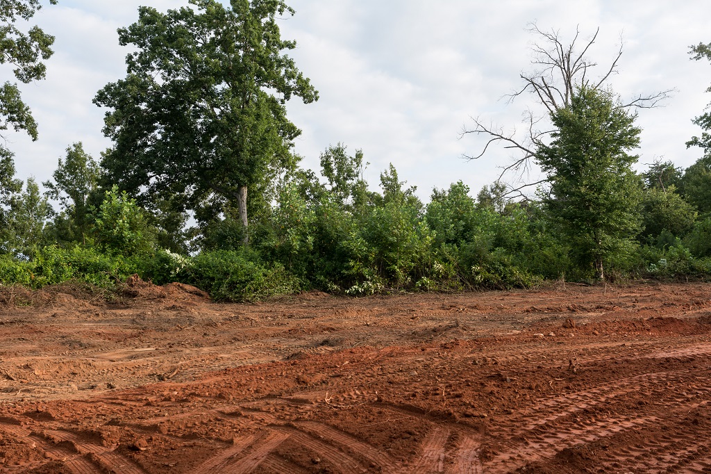

Here's a picture of some of the land that needs clearing, that's pretty reflective of what I'm looking at, thick, some rocks, nothing huge (that I want to take down anyway).
What's the 472 called today, I can't seem to find anything with that spec on the Brown site. The 400 series now seems to have a closed back, which, unless it's really, really reinforced, I'll probably wind up bending backing down the trees.
I took a look at the tree saw, that's interesting, but looks like it would be slow trying to clear a good size swath and none of my trees are big enough to need that over something like the tree cutter. It's a beast though, man, Brown makes some interesting stuff!
If I thought I could get away with a HD bush hog, that might make sense, especially if I could use it for general purpose stuff too and sell my EA hog. My other thought is get out the welder and reinforce the EA hog, everything seems to be able to take the beating except for the shrouding; so I was thinking of welding some box beam on there to make a "pusher" like you see on the tree cutter to use to hit the trees rather than using the edge of the hog like I'm doing today. I'm wondering though, what else will I break if I continually hit scrub trees; the gear box? Or is the weak link just the shrouding and if I reinforce that, I'll be good to go?
One of my other, slightly crazier thoughts was to get a plasma cutter and just take the back off the bush hog (make it like the Brown Tree cutter) so that blades extend a little beyond the back so I don't have to hit anything with the frame first. Probably not my best idea, but, seems like it would work. Would also though, make that a single purpose tool because I couldn't use it anymore to mow anywhere where something could get thrown (not that i could with a Brown either).
Thanks for the suggestions, let me know what you guys think seeing the land, maybe I'm making this too hard? Just get in the tractor, put on the hog and put the bucket down low and start driving forward? I just hate all those trees coming at the underside of my tractor, seems like a good way to break/puncture something.
