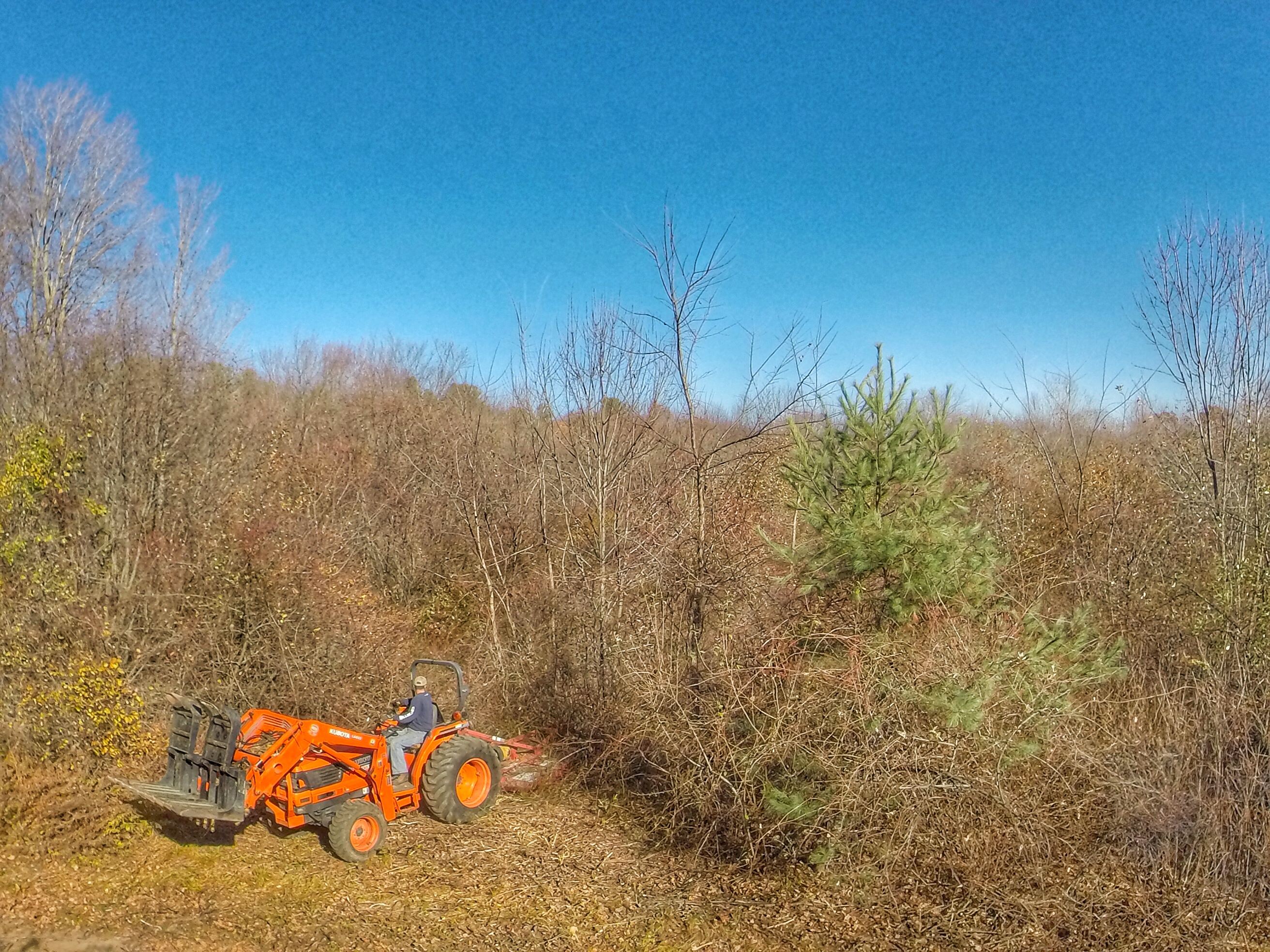

As cool as it would be to have a mulcher come decimate that brush, you can certainly do a lot with what you have. Seeing the photo, I personally think you should throw your EA rotary cutter on and go see what you can do. By all means, back into it and don't drive over it first.
Do you have a hydraulic top link?
What "I" (remember, I'm just another random guy on the internet :D) would do (or rather, have done many many times) is start backing into that brush really slowly, raise up the 3 point hitch so my cutter is off the ground, and then retract my hydraulic top link raising the rear of the cutter off the ground, fairly high (while keeping a close eye on the angle of the PTO shaft, you don't want it to steep) and slowly back into the pile, when I start hearing the brush getting chopped up by the blades, I start to extend the top link, lowering the rear of the cutter (but never lower than the front) and eventually start lowering the 3 point hitch so the cutter is back on the ground. Often I'll keep the 3point hitch down so the front of the cutter is about scraping the dirt, and keep the rear end a good foot or more off the ground. This helps bend the brush over and mulch it up.
It sounds like your pretty confident you will bend up your EA rotary cutter by backing into the brush. If that's the case, I suggest selling the cutter while it's in good shape, and buying the Brown 416 unit. The 416 is the newer version of the 472 that I have. It's quick hitch compatible. I 'believe' (but not certain) there may be a steel 'skirt' on the back of the 416 which is removable and replaceable with chains to open the back end up, on top of that, the back skirt is beefed up to 1/4" steel to take more of a beating in reverse. It doesn't really look that way in the photos on they're site, but some of the owners manual pics do appear that way, and I know the rear chains are optional. It would be very worthwhile to call Brown directly and ask them this, as well as their opinion on what they recommend. I have a feeling they would not suggest a tree cutter for this operation, and your tractor.
Regarding the Brown 416 vs. the EA rotary cutter, I looked quick at the specs and the Brown unit is certainly more heavy duty, by a substantial amount. Again, this is why I don't like their naming convention, they're "xtreme heavy duty" doesn't mean squat. The EA unit weighs a (respectable) 850lbs, and has 10 gauge (9/64") steel deck with a 75hp gear box. The Brown 416 weighs 1,100lbs and has a 7 gauge (3/16") steel deck with a 130hp gearbox. So yes, the Brown will be considerably more capable and hold up a lot better/longer than the EA unit.
(Note: I'm referring to Brown only because it's what I know, Bush Hog, Land Pride, and Woods etc. all have very heavy duty mowers as well, I'm not brand loyal)
A note about the Brown Tree Cutter: I wouldn't recommend this after seeing your pics. It seems you mostly have thick, heavy brush, vs. straight up trees. The rotary cutter is going to be better at mulching up all this material into pretty small pieces. The Tree Cutter, is more meant for just that, cutting the trees down, and of course it will mulch to some extent, but because of the open back design, it doesn't keep the material contained inside the cutter, but rather throws it out as soon as it's cut. The closed top design of the rotary cutters holds the material in longer and mulches it up to smaller pieces. This is why I like the 672 so much, it's the best of both worlds in that regard (super duty tough yet still a rotary cutter.) You could step up to Brown's Folding Deck design, but that is really way overkill for what your doing (and also typically used on 80+PTO hp.) I have only heard of one person using it behind a compact tractor, a John Deere 4720. He said it 'worked' but wasn't very ideal. I have some correspondence with him through email from some time back if your interested in details.
None of this will be as efficient and effective as a 100hp or more skidsteer with a mulching head on it, but it will be a lot cheaper, and you'll have your own equipment.
How many acres are like the photo you posted?
I can't stress enough, how important a grapple is to have. :thumbsup:

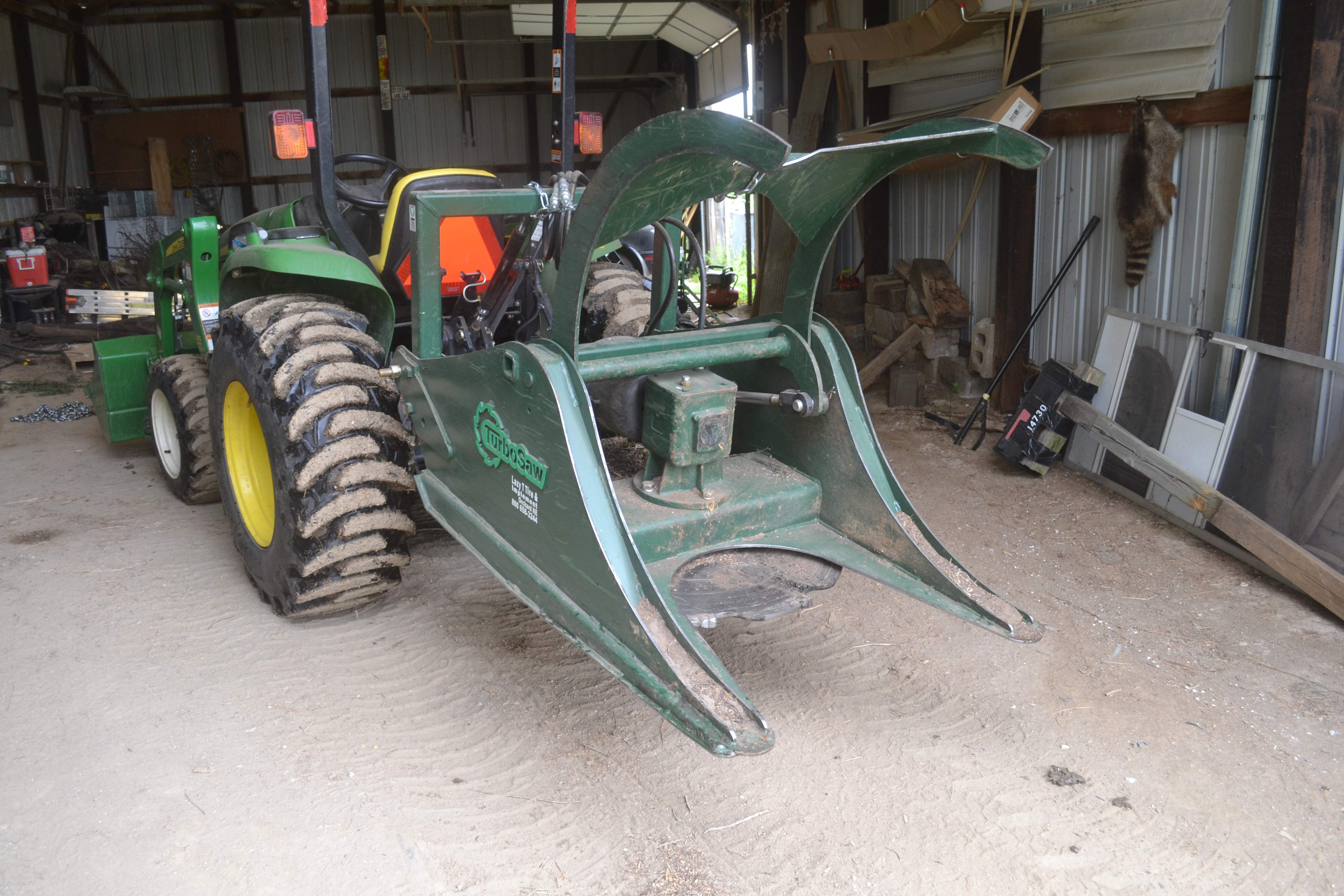

So, just a quick update, I'm in communication with Baumalight about the Brushcutt. It's not a mulcher, it's like more like a rotary cutter with all vestiges of safety removed (kidding), with blades that extend out enough to be able to cut without actually getting the deck over the material.
Here's a video of it in action:
Brush Cutt CP56 Video - YouTube
They are offering a "media discount" on the cutter, which basically means agreeing to do videos/pictures of it in action so they have material for their website/Youtube. I'm trying to get into that program (finally, a way to save money with all my camera gear instead of just spending it). It's about 1/2 the price of their PTO mulch heads, around 5K instead of 10K. But it looks pretty perfect for my use because it's built to back down trees, which is absolutely critical to keep my tractor in one piece. It'll take some time, that for sure, but if I can do it with a 5K machine, that's less than I was looking at for a rental, and WAY less than I was quoted to have it done for me, and, of course, then I own the machine to do it, always a huge positive. It's much more fun to do this stuff as you have time rather than trying to get it all done in a week/month. I also have to think that the consumables on a rotary are going to be much less expensive than a real mulcher, a few big hunks of steel are a lot less expensive than a whole load of carbide teeth.
Now, the downside, like the Brown Tree cutter, this isn't "ground level", they told me to expect around 2" as the cutoff height. That's fine for my purposes because I can then go back in with a blade and either yank or cover the remains of the trees. Also, I'm not actually looking to cut many new trails (but will be doing some), I'll spend more time with it maintaining the ~1.5 miles of trails I have already, just beating back the brush and opening them up, but not actually the place you'd walk, alongside the trail. I have my trails down to dirt now, I run the box blade over them 2-3 times a year, it's much easier than trying to deal with grass and the crap that grows up, and it makes for a really nice walking surface. Only downside, the mud can be bad when it rains, so maybe someday I'll seed them in clover and start brushhogging them. But, for now, dirt works for me.
I'll update if I decide to move forward, but, so far, really impressed with the responsiveness and discussions I've had with Baumalight, they are on top of things, and they are answering my questions quickly and honestly. They even said, the best thing for my use is their PTO mulcher, and, while I agree, it's just out of my price range (almost 2X the cost of the rotary, and 1.5X the cost of the Brown cutter).

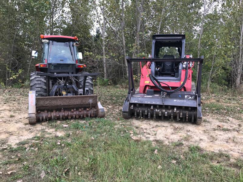

Yup, pricy, BUT as TSO said, I use mine to make money. I paid 14kish and that was with an extra set of teeth which are reversible. The set is $1000.
So 13k. I’ve now had it a few years.

Just wanted to quickly update this thread in case anyone finds it and wonders what the answer is/was. I wound up with the Brushcutt CP560. I've used it about 10-15 hours now, and it's perfect for this application, it's dramatically different than the EA cutter, I literally haven't put a scratch on this machine yet, both because it's built like a tank, but also the design is just right for what I'm doing. It's built to back over brush and eat it up, and it works spectacular and fast for this application. It even does a respectable job turning trees into mulch; no, it's not a mulcher, but it's not leaving huge pieces of tree either, this land will be clear of debris in a year or 2 just letting mother nature do her job. Here's a thread where I'm talking about it in more detail as well of some videos of it in action. Thank you to the poster who suggested it, I never would have found it otherwise and it's the right machine for my job.
http://www.tractorbynet.com/forums/attachments/396282-baumalight-brushcutt-cp560.html

I have been working on my 100 acres of over-grown farm land for ten years.Land had not been touched in at least a hundred years.Lots of thick brush;honeysuckle,red alder and all kinds of trash type trees.So thick in spots a beagle had a hard time going through it.
1.hired a small dozer to open a road in
2.hired two different fellows with 100 HP.tractors and large bush-hogs.
3.purchased my own tractor;first a 32 HP then a 44 HP(both with new bush-hogs)
4.last year hired a skid steer(65 HP) with a rotary head type cutter
a.cleared about 4 acres in two days but left a lot of scrap/pungi stakes.
5.last year;hired a skid steer (90 HP) with a FECON mulcher
b.cleared another 5-7 acres in three days,minimal clean up
6.Bottom line,hire it done with the proper equiptment
