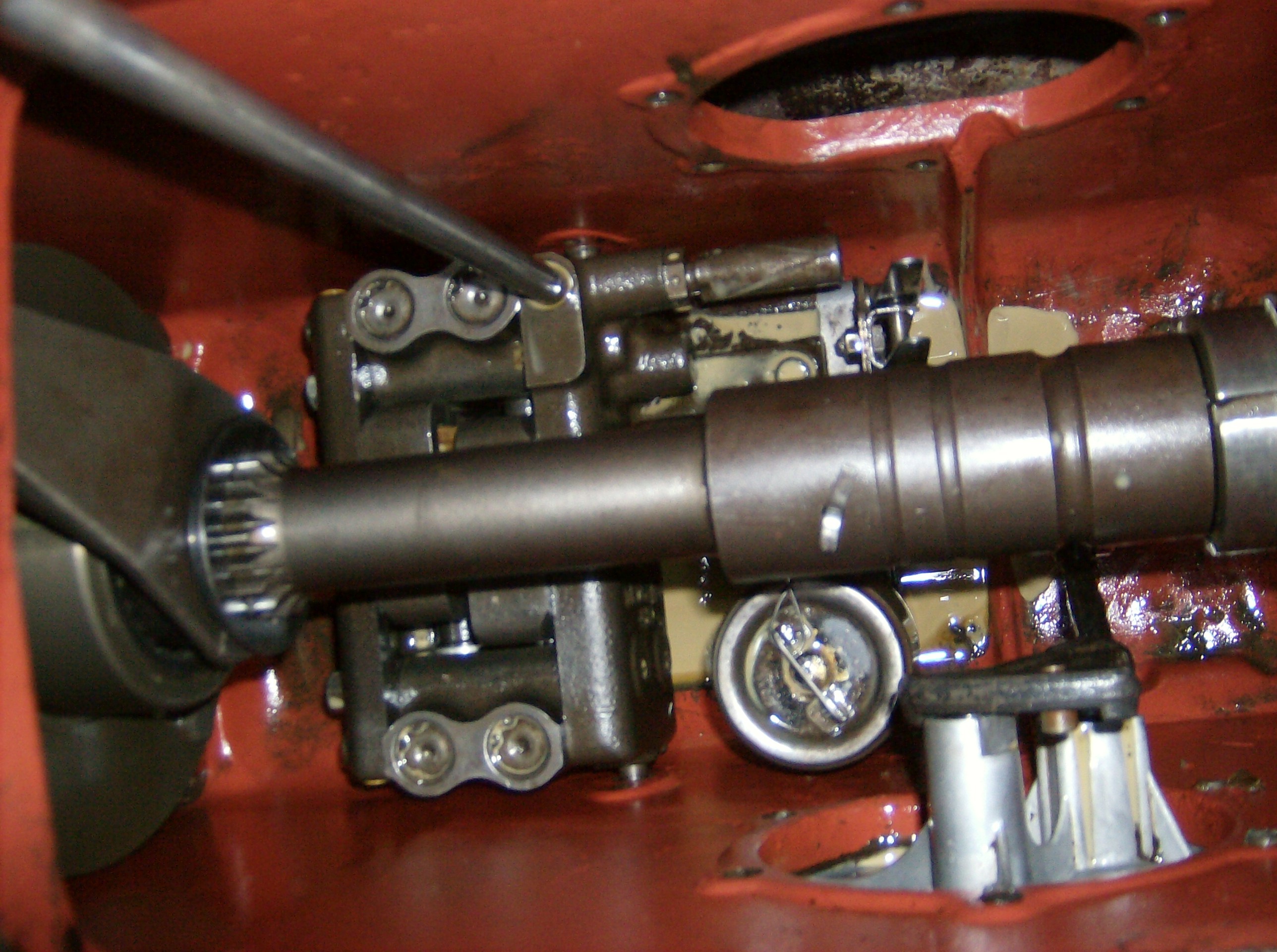

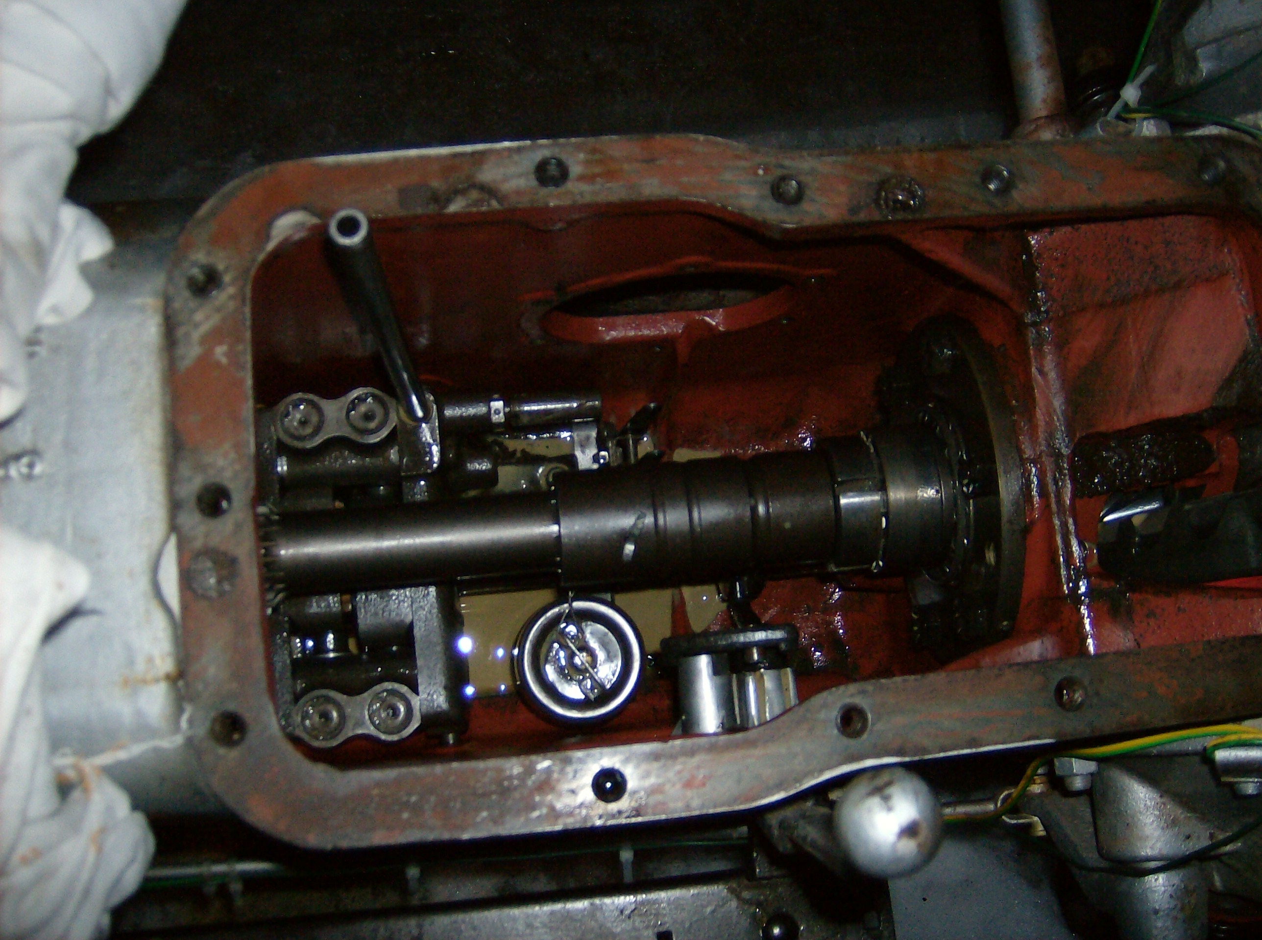

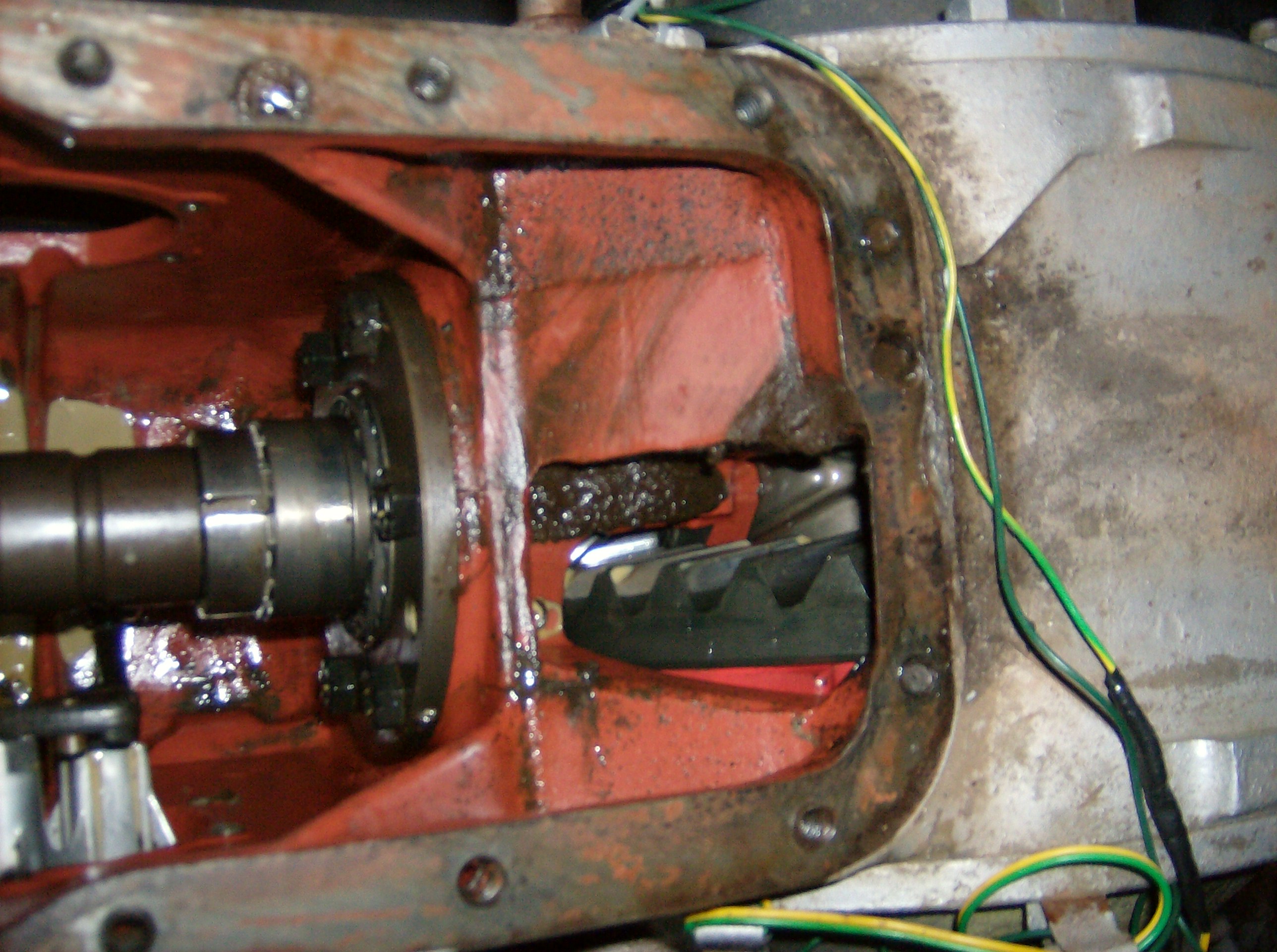

The 135 has a common sump for the transmission, hydraulics, and rear end.
   / PTO oil seal MF 135 ' 72 #12
if that's so, it will be as easy an an N ford then... or a 3000/2000 3 cyl job that has common hyds and diffy anyway.
soundguy
   / PTO oil seal MF 135 ' 72 #13
Sump is common, and although not a requirement to change the seal, not hard to get at if needed.
