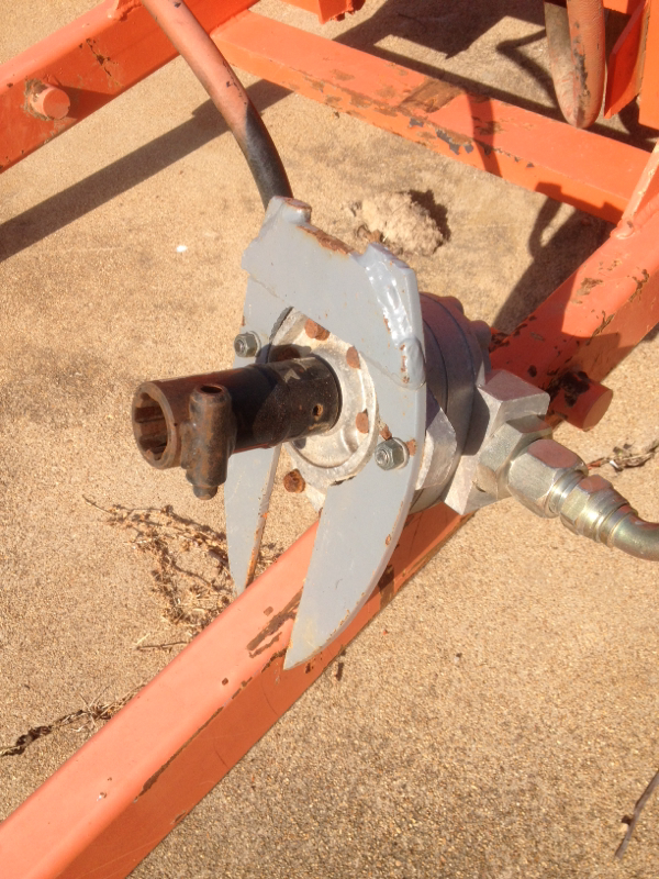

Have a subframe mounted back hoe , it has it's own hydraulic tank and pto pump. It's a bit to slow, need more flow rate. Any way the pump is a Cessna 24503 it's rated for around a 20 gpm but also it's rated for up to 3600 rpm , they have the pump mounted straight to the pto of the tractor so I'm only getting 540 rpm I'm trying to find out about what gpm I'm getting at that slow of a rpm. The hoe has a flow rate of around 16 gpm. I'm just guessing it's not putting any thing close to that out of the pump.

This pump is a high rpm pump and will not pump 20 GPM off the PTO, which runs at 540 rpm, unless it is geared up .
How do you have it connected?
20 GPM at 540 needs a 8.6 cu in displacement pump and 41 HP.
20 GPM at 3600 needs 1.3 cu in displacement pump and 41 HP.

Thanks , I'll definitely look into that, really need to have it working a bit faster. Here is a pic of how they have the pump connected now pretty simple just a pto adapter and a plate cut to straddle the drawbar to control the torque

Your pump turns left.
Displacement is 2.1 cu in
Input rpm max is 2500
Max pressure 2000 psi
Requires 32 HP for max GPM
23 GPM flow
Who put your system together?
It is the wrong pump for PTO work. However, you can still use the pump.
At 540 PTO you get 5 GPM, and requires 7 HP.
At 1000 PTO you get 9 GPM, and requires 12 HP

Do you have optional PTO speed like 1000 rpm?
If so, you can get 9 GPM at 2000 psi .

Your tractor hyd is 7 GPM, so I think I would use the tractor hyd.
You will then have more GPM's and pressure to the BH.
Set your BH relief to the same as your FEL valve.
If you can find a 4.5 ratio gear box you can use the 540 PTO to increase the so called PTO pump to the rated 2500 rpm
Since you have 27 PTO HP, you can run the tractor PTO pump to pump 20 GPM at 2000 psi.
