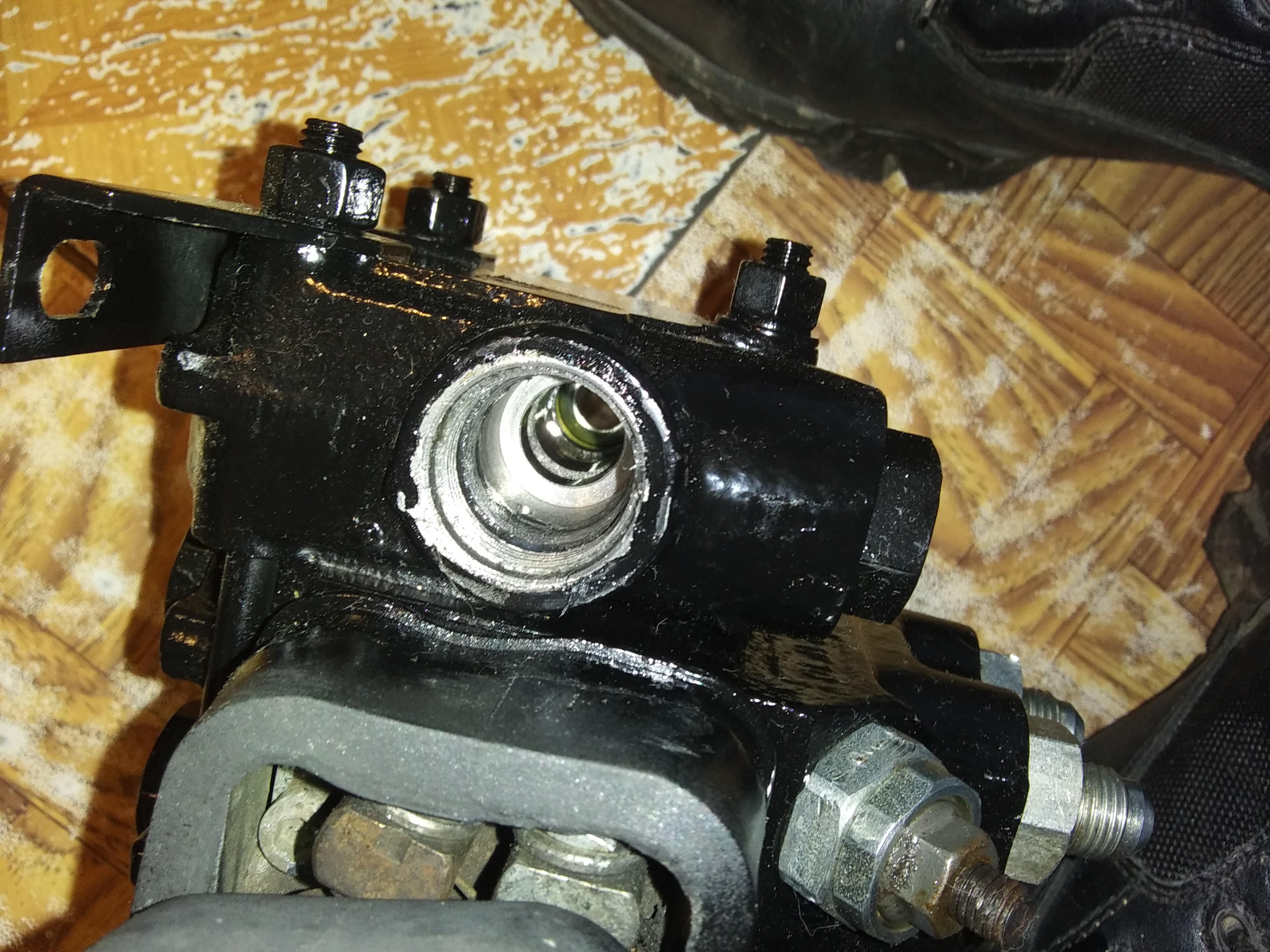

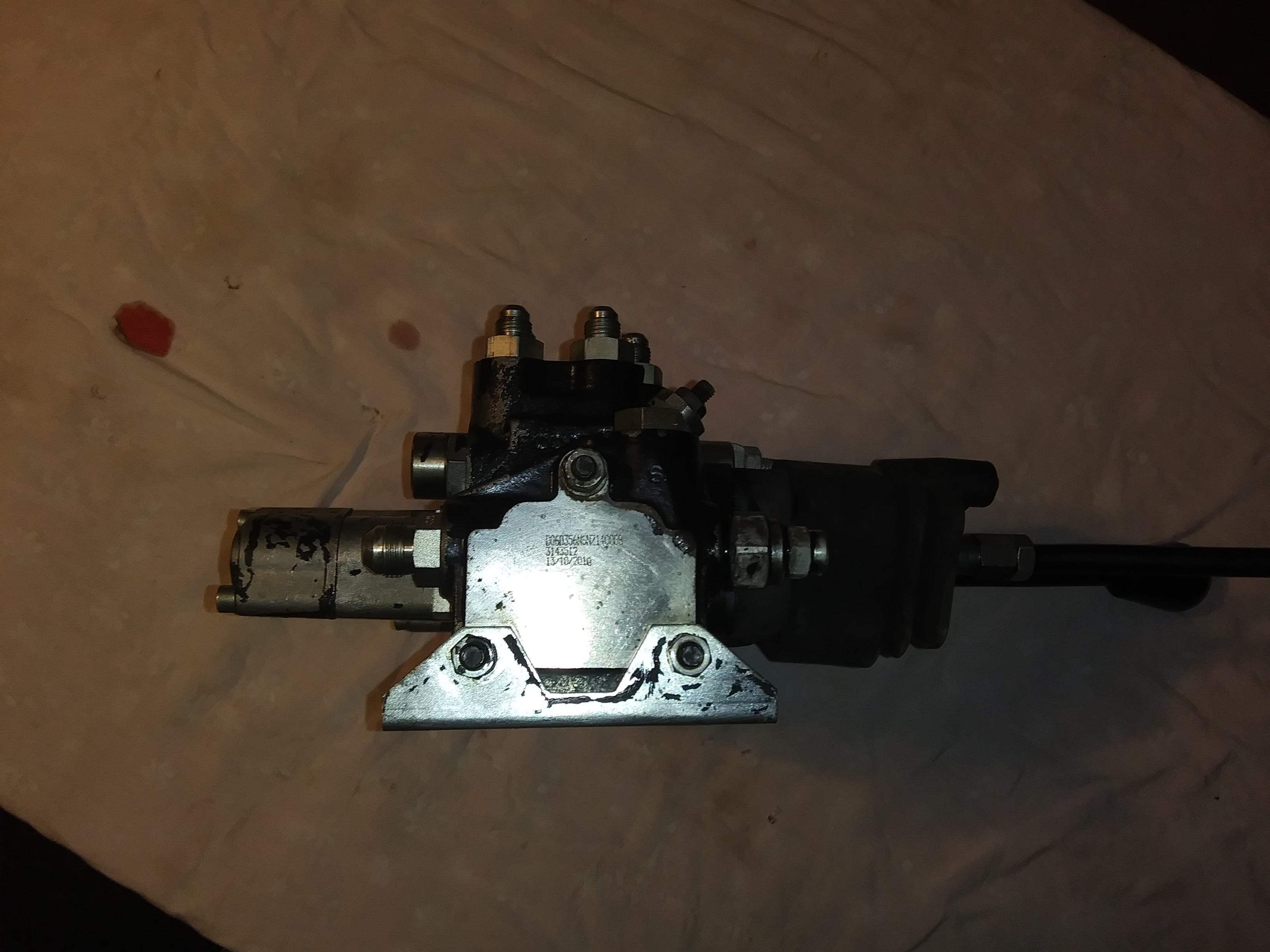

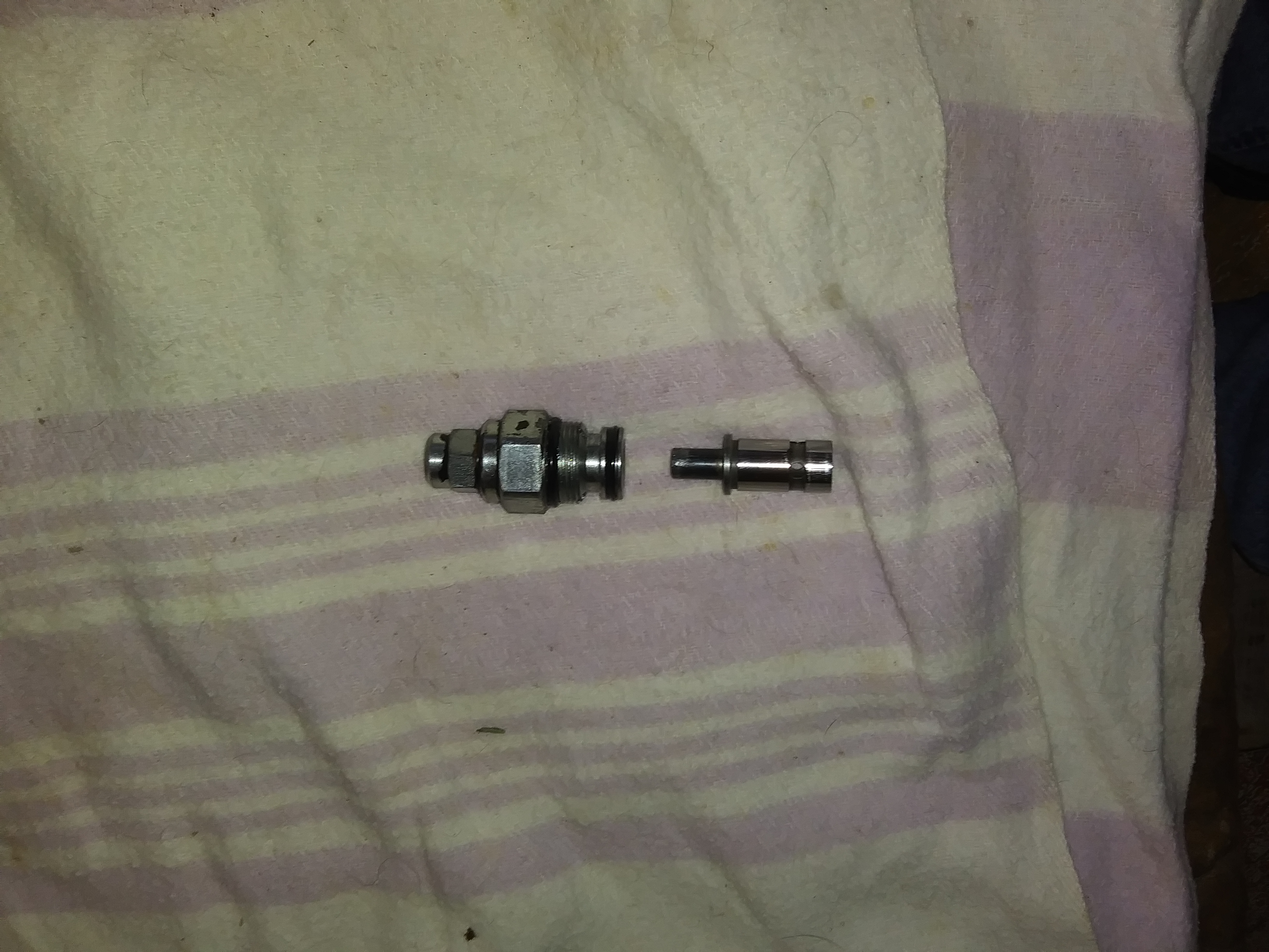

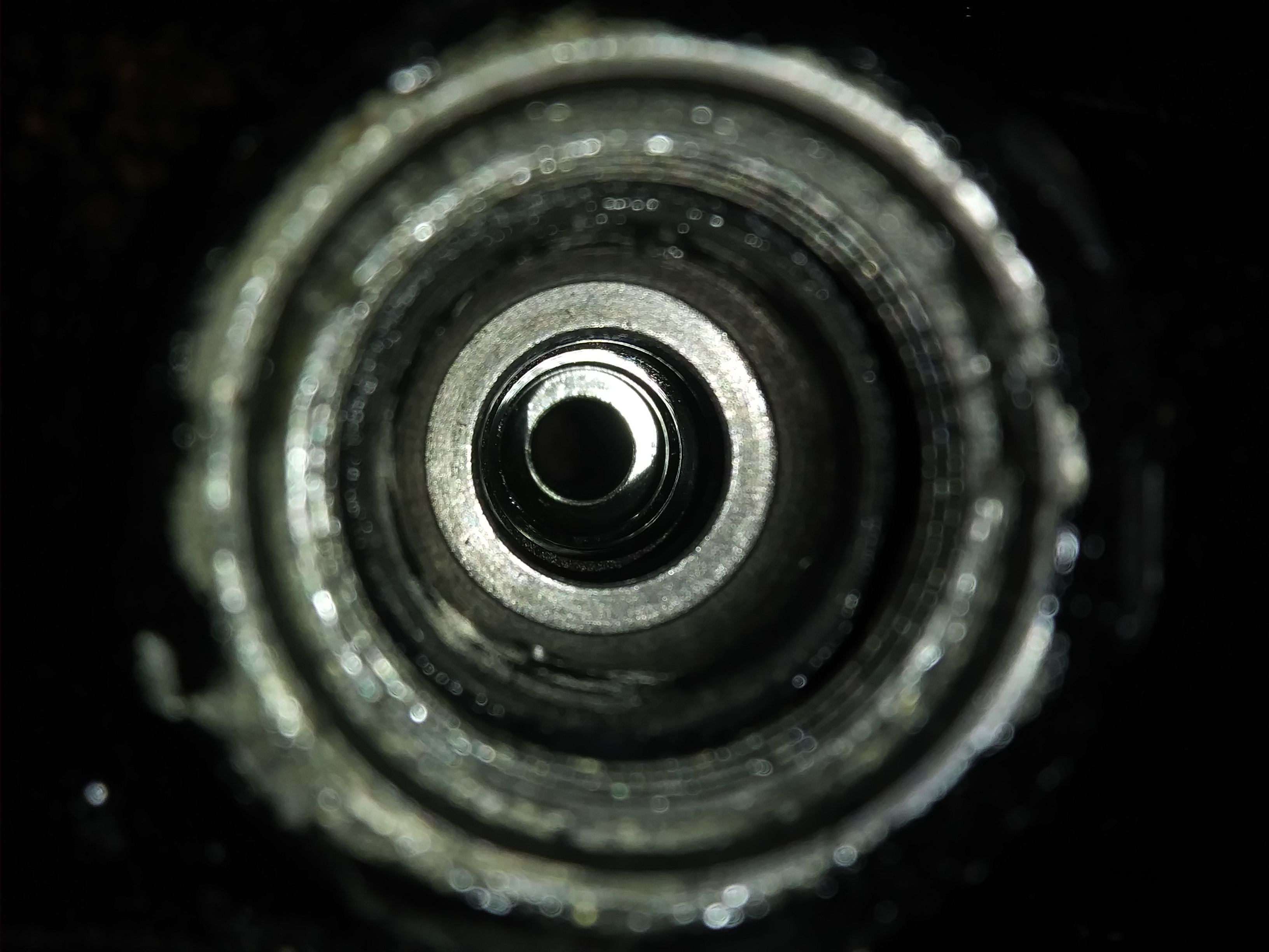

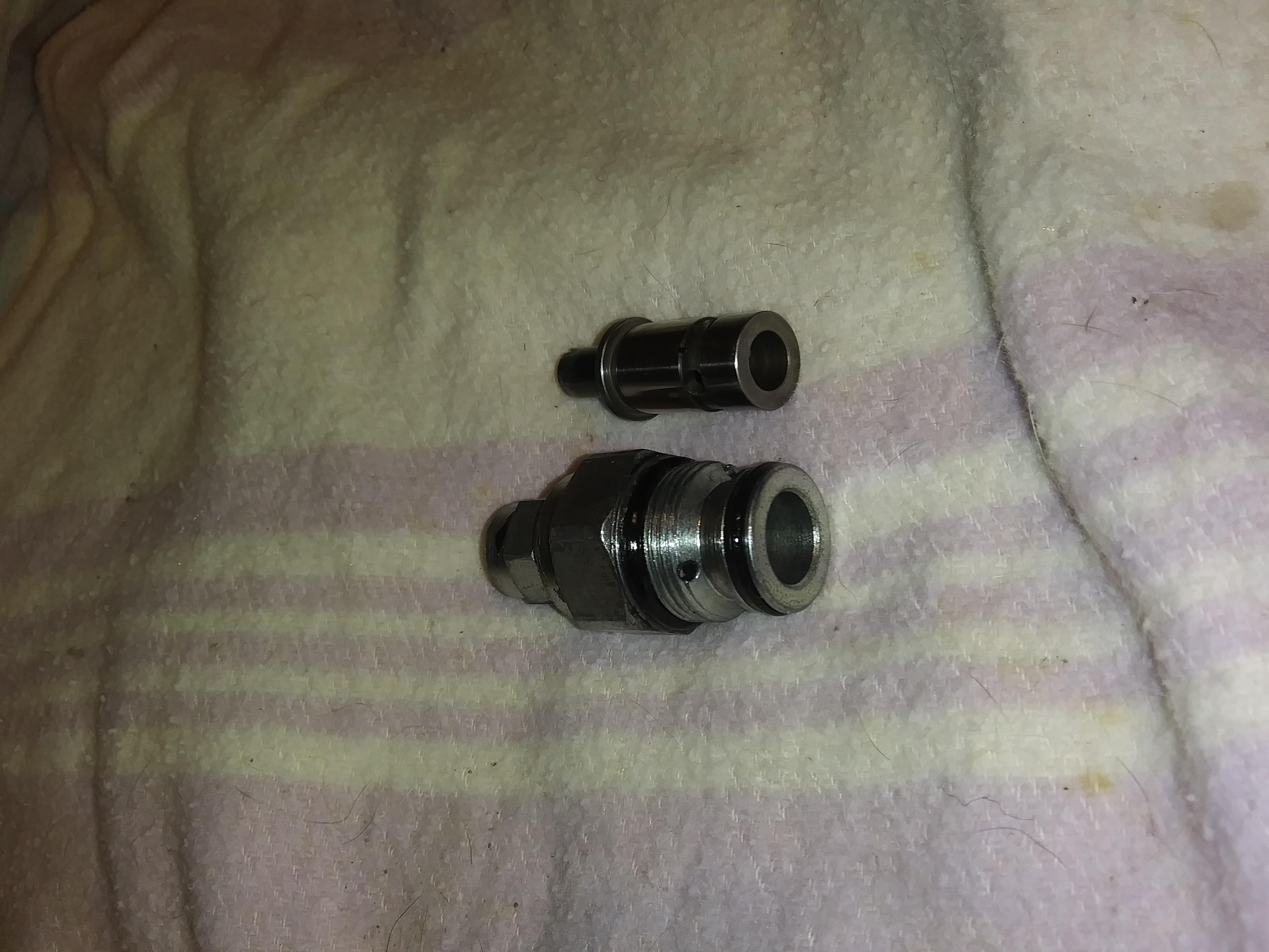

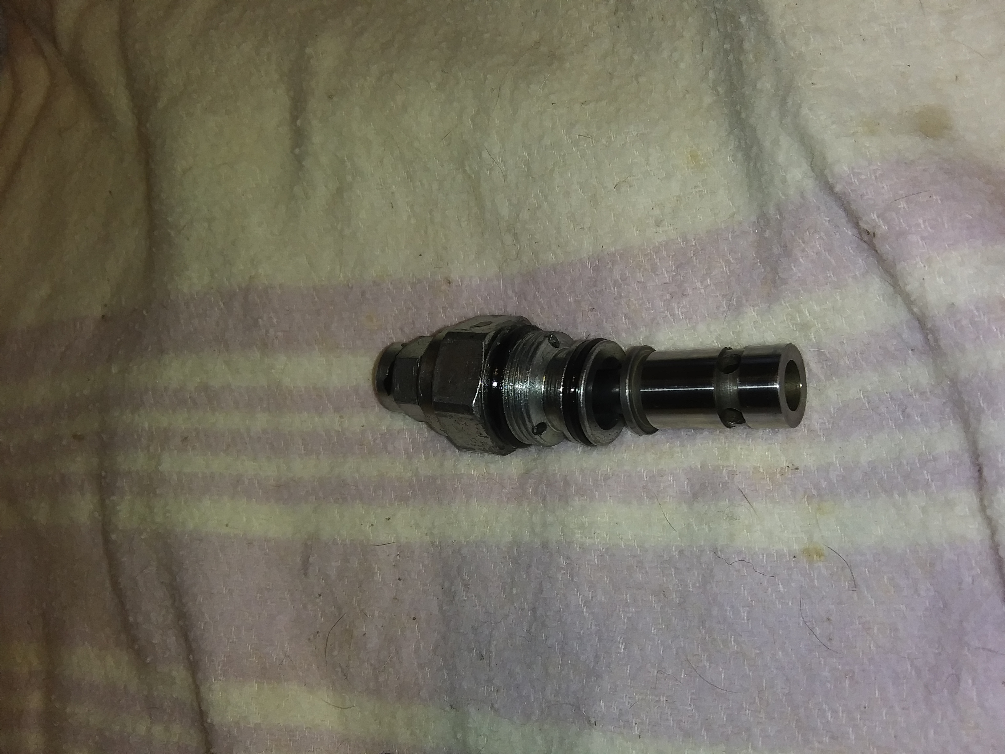

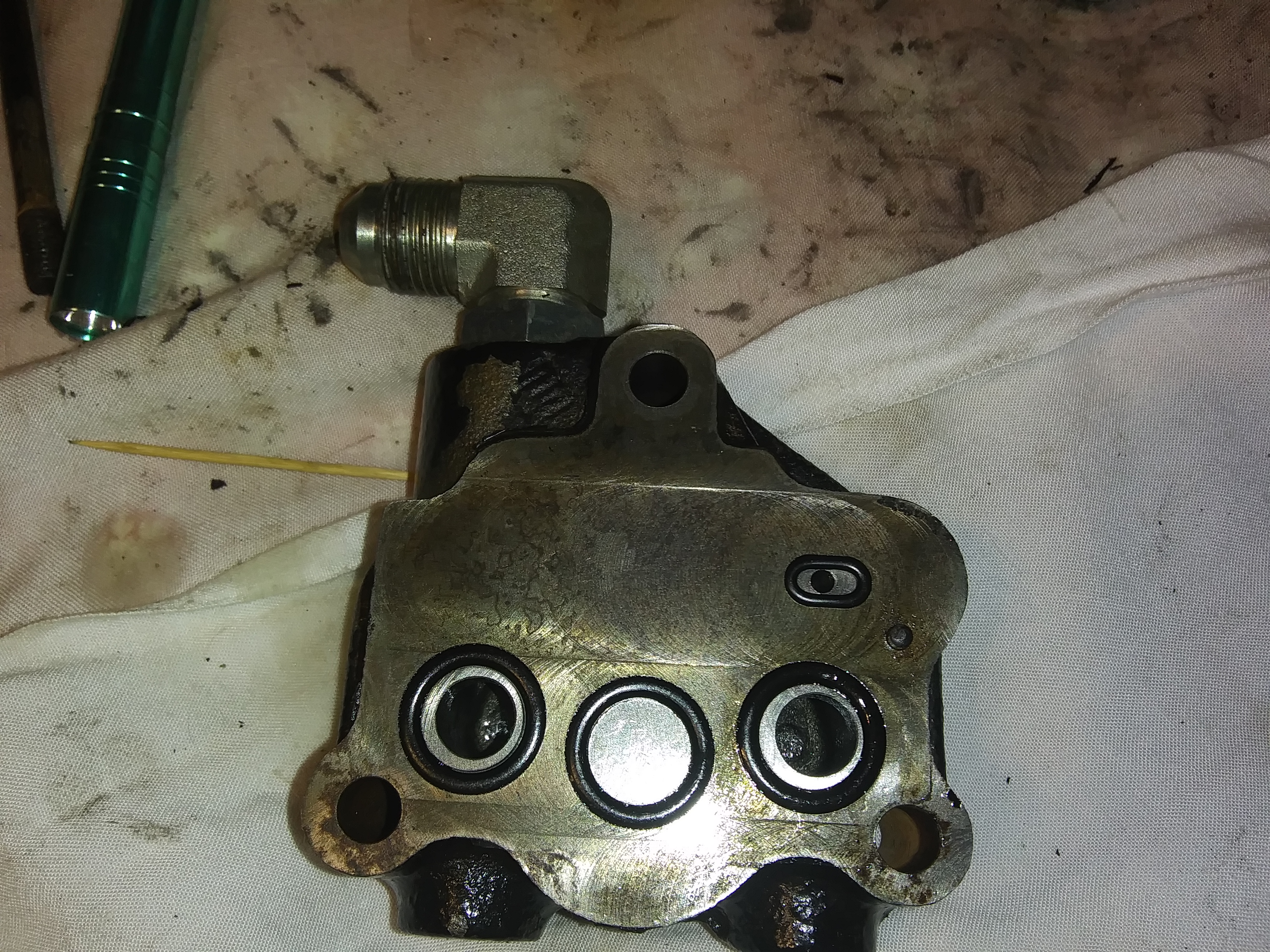

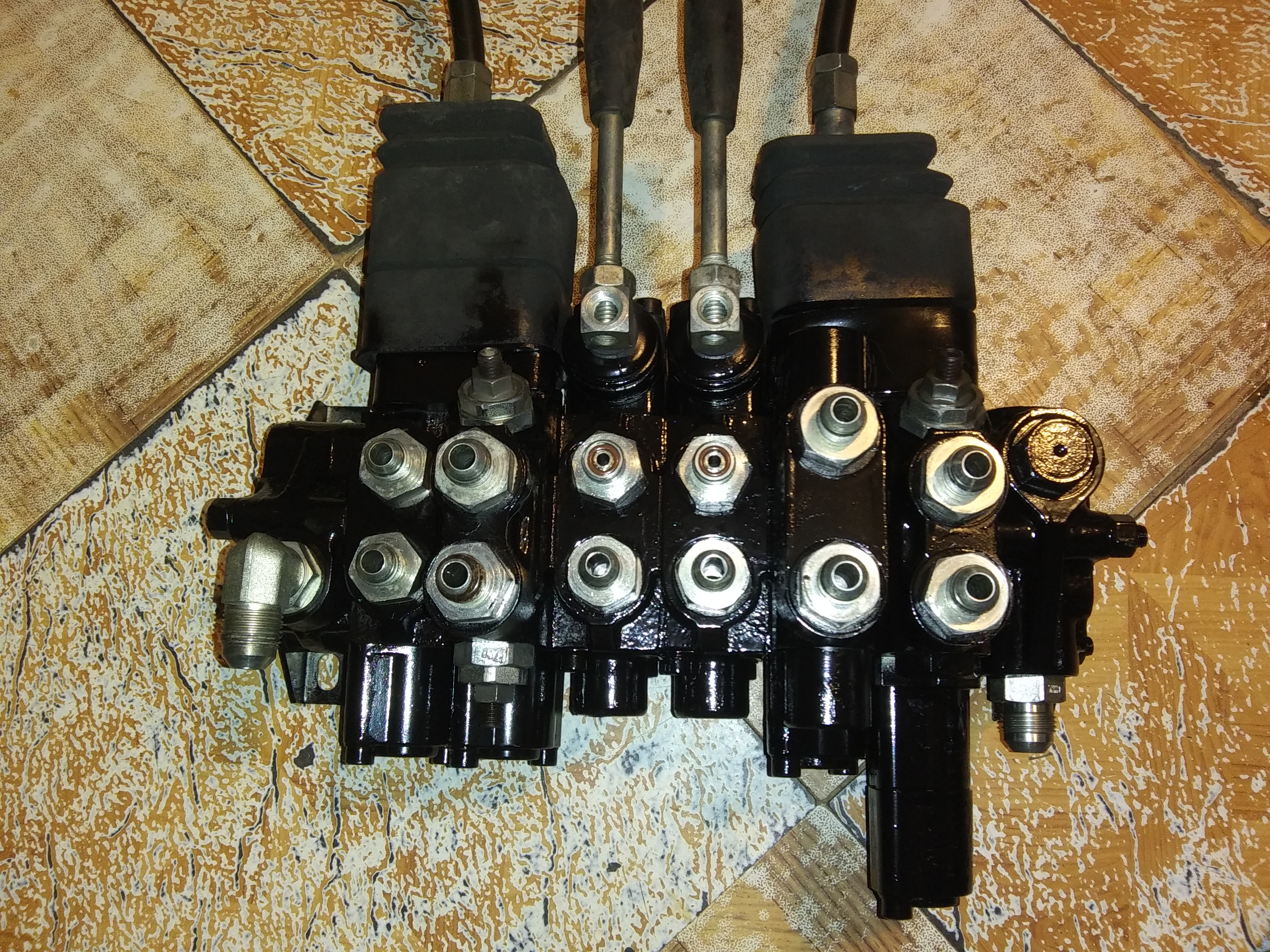

#59
Pics of controller

Not very good at posting pics but if you guys need more pics let me know and thanks for helping me with this
