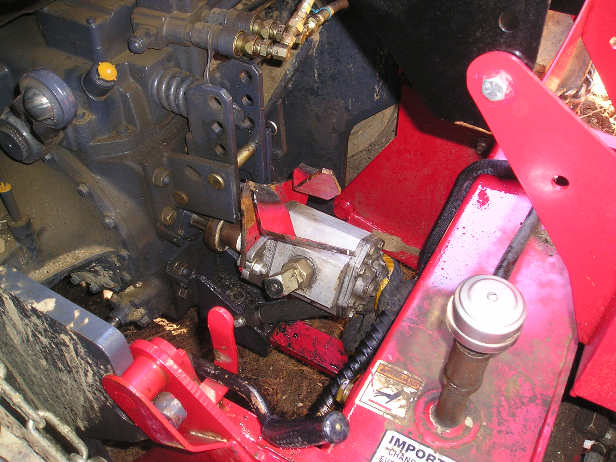

this is a pic of the oe prince pump and what happens when the tangs or forks get bent somehow. my opinion is poor design

/ PTO Pump #28
Wow, that is tight! Does the tank bolt onto the frame? Or is it integral with or welded right to it?
Dougster
/ PTO Pump #29
Definitely a lot different than the prototype that I had,,, Miles apart.

/ PTO Pump #31
Gee, what does "somehow" mean??? Looks like somebody, pop the clutch in reverse when you were hooking up....And yes, its tight in there with only about an inch or so on either side and about 2 inches from the the end of the pump to the front of the tank...BobG in VA
